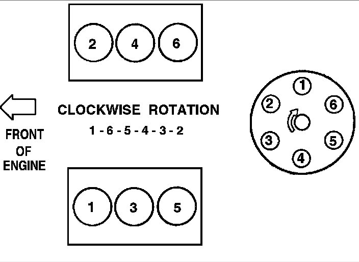

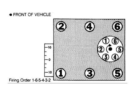

I have a misfire on cylinder number one. Which cylinder is number one, and what size is the spark plug socket?
Monday, February 3rd, 2020 AT 10:34 AM
21 Replies
CARADIODOC
  • 33,916 POSTS
Driver's side front. The 3.9L is a version of the 318 c.i with two cylinders chopped off. In 2005, the engine choices were 3.7L or 4.7L. Chrysler's numbering system is 1, 3, 5, front to rear on the driver's side, and 2, 4, 6, front to rear on the passenger side.
Most likely the spark plug socket you need is 5/8". Older engines used 13/16" spark plugs.

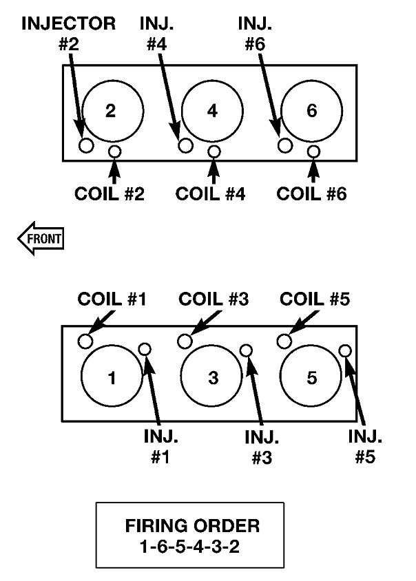

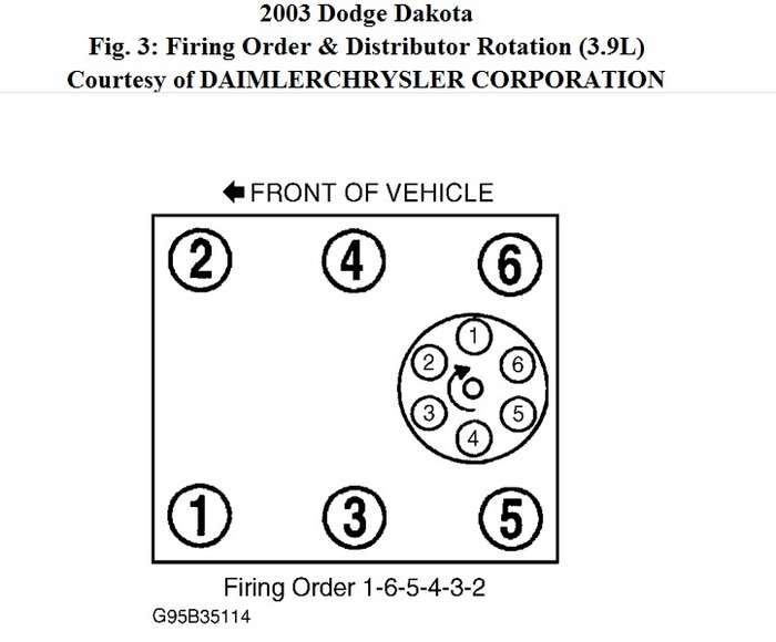

What is the firing order for a 2003 Dodge dakota v6 on the distributor?
+2
Friday, April 2nd, 2021 AT 10:03 AM (Merged)
JDL
  • 16,098 POSTS
Here is the firing order for your car in the diagrams below. Check out the diagrams (Below). Please let us know if you need anything else to get the problem fixed.

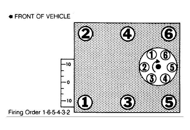

Spark plug wiring from plugs to distributer on the vehicle listed above slt model.
+1

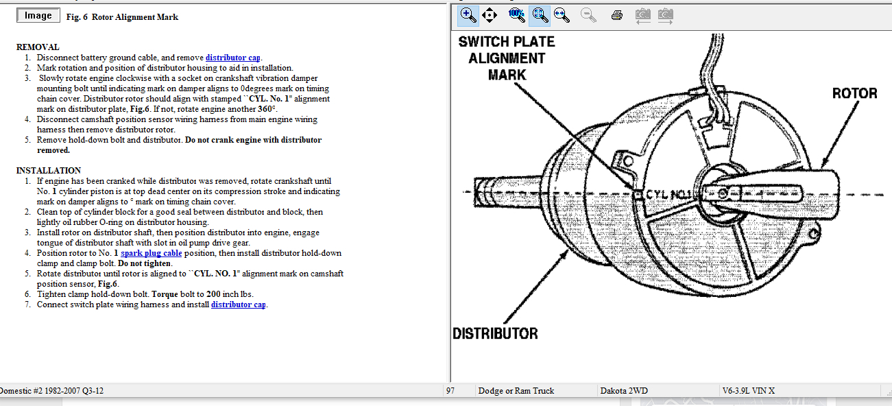

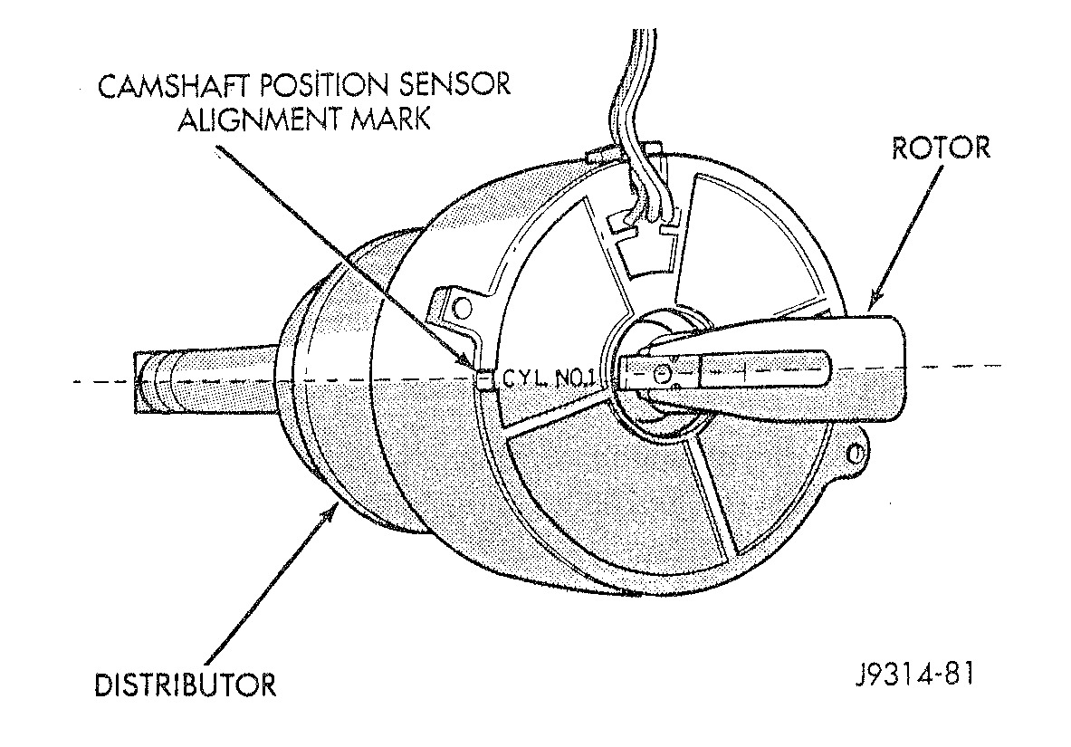

SEVAG P
  • 405 POSTS
fig 1 is the routing of the ignition wires and the fig2 procedure how to install the distributor at correct timing, at the fig 2 you can see a notch on the distributor, rotor must face toward the notch, that means spark plug wire that located at the notch is the cylinder 1 wire. Also cylinder 1 must be at TDC compression.
Let me know if you need more help.
+2

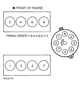

HOLLADAYTAMMY
  • 1994 DODGE DAKOTA
  • V8
  • 4WD
  • 94,000 MILES

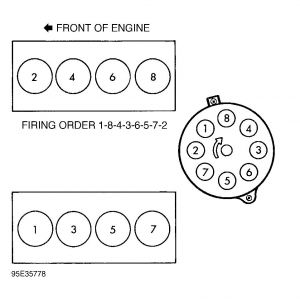

Need fireing order for 318 engine.
+1
Friday, April 2nd, 2021 AT 10:05 AM (Merged)
  • 75,992 POSTS
Here you go
https://www.2carpros.com/forum/automotive_pictures/12900_fo_104.jpg
+2

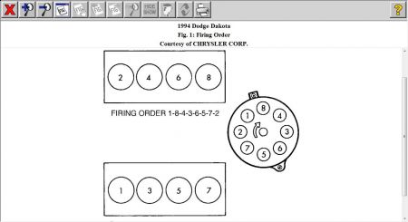

MICHAEL 1956
  • 1994 DODGE DAKOTA
  • 3.9L
  • V6
  • 2WD
  • 250,000 MILES
Not wired back to distributor correctly. Where is no # on the distributor cap?
+1
RIVERMIKERAT
  • 6,110 POSTS
There's a notch in the body of the distributor that lines up with a corresponding tab on the bottom of the cap.

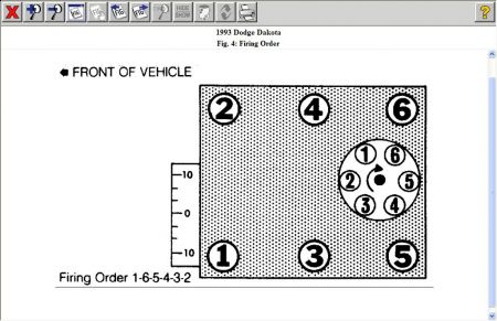

AUTOMAN40
  • 1993 DODGE DAKOTA
I accidently got my plug wires crossed when changing them. Can you tell me what the firing order is, where number one cylinder is, and where number one location on distributor is?
+1
Friday, April 2nd, 2021 AT 10:06 AM (Merged)
  • 75,992 POSTS
There you go have a nice day
https://www.2carpros.com/forum/automotive_pictures/12900_dodge_fo_1.jpg
+3

DGR1941
  • 1987 DODGE DAKOTA
  • 6 CYL
  • 2WD
  • 12,800 MILES
I accidently mixed up the wiring for the wires to the distributor cap. What is the order and where do you put the first wire? Maybe you have a diagram I could look at?
Thanks
-1
IMPALASS
  • 3,112 POSTS
Hello
Here is the info you requested Check out the diagrams (Below). Please let us know if you need anything else to get the problem fixed.
https://www.2carpros.com/forum/automotive_pictures/248015_Firing_Order_1.gif
