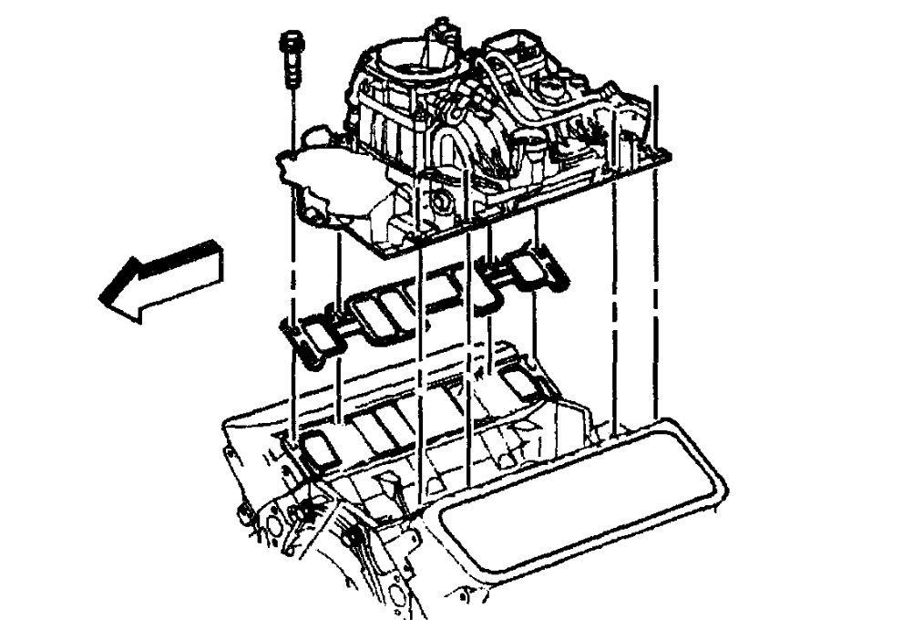

Usually this is caused by a vacuum leak, and if the RPMs are that high, then a major one. Here is a link to a guide explaining how to track down vacuum leaks. Please pay special attention to the intake manifold portion of the guide.

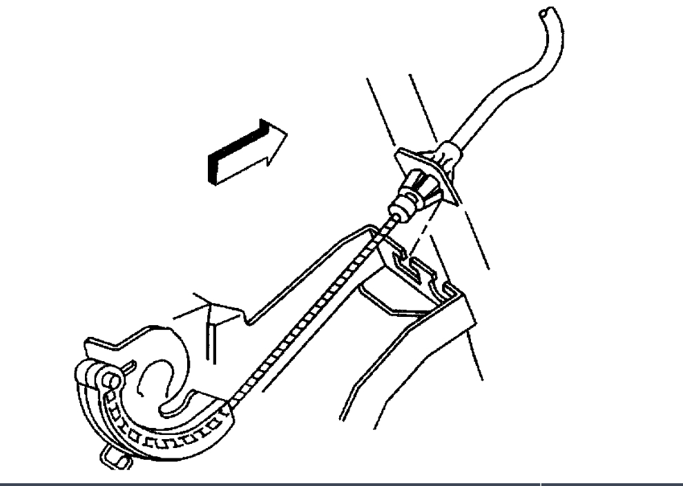

It could be the throttle valve is not shutting or sticking open, Clean and adjust it and check the throttle cable adjustment. There could also be a massive vacuum leak check the intake gaskets for vacuum leaks. Check the EGR valve for sticking open, Check the brake booster hose and all vacuum lines. Check the Idle Air Control motor pintle for carbon sticking and the throttle valve idle adjustment for tampering. Check the correct positive crankcase ventilation (PCV) valve, properly installed and proper operation of the PCV valve. Check for restricted air intake system. I'm attaching repair guides and component location below. Let us know if you more info.

Make sure the throttle body plate is closing at idle as well. If the plate is partially open, it will give you this condition.

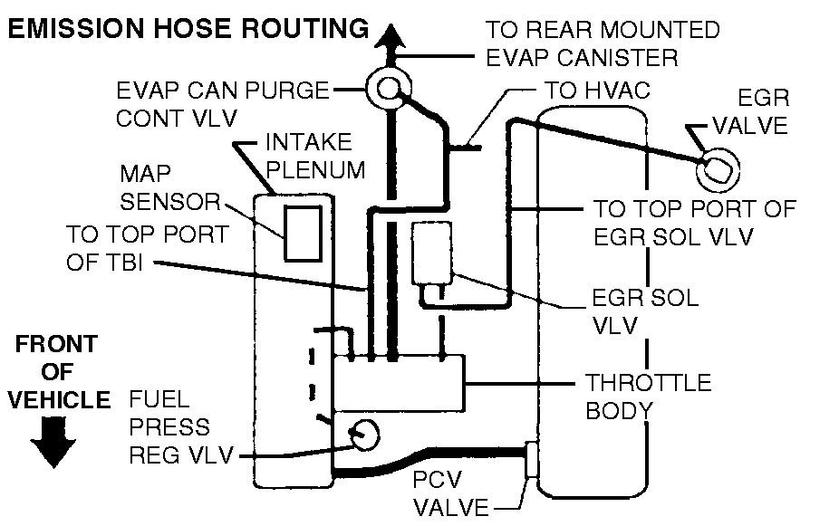

They are fuel fouled do you by chance a simple vacuum hose diagram?
Jan 20, 2021 at 11:27 AM (Merged)
Diagram.

These trucks had a problem with the throttle body gasket blowing out. Please remove the unit to inspect.

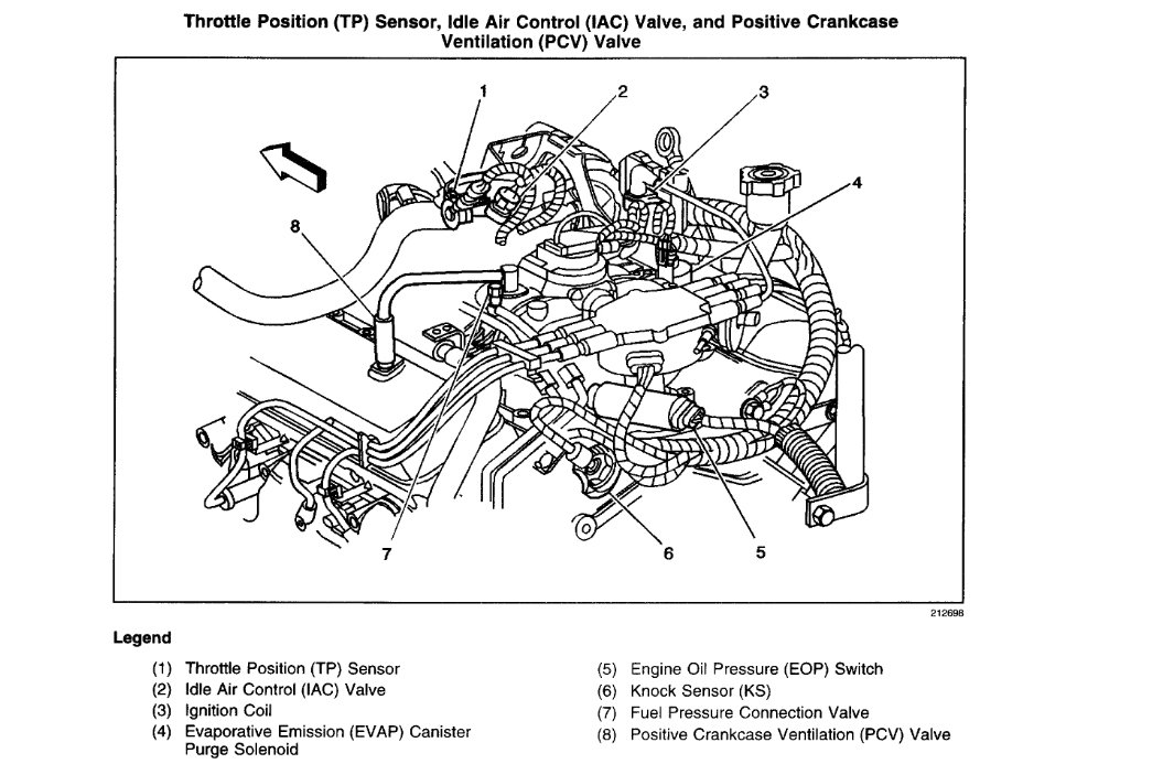

Hello. I have a nasty high idle in my 95 chevy s10. I have replaced every single electronic component that would effect the idle. The weird thing is that when I unplug the idle air control valve from the computer, the truck doesn't idle high.
Any help would be appreciated. Thanks
Jan 20, 2021 at 11:29 AM (Merged)
  • 75,988 POSTS
Try cleaning the IACV out-don't work-look for a vacuum leak-also check the TPS

first thign to do is check for vaccum leaks.
check everything after the MAF sensor. if you dont find anything move onto checking for proper function of the pcv valve.

The idle air control valve takes care of the idle. check for vacuum leaks too. If this is the 4.3L, check the intake for leaks. It was a common problem.

Usually, with idle issues, I clean the throttle body and check idle air control system. You may also need to check egr and map sensor. The vehicle runs ok, going down the road?

Clean out the idle air control valve and also look for vacuum leak-start here
