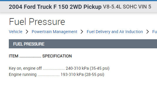

The trims indicate the PCM is trying to lessen the amount of fuel entering the vehicle. As far as the fuel pressure is concerned, it's at the threshold of being low (KOEO), which is confusing. I would have suspected the opposite. (see pic below)
Is it possible to get the codes you found?
See pic below.
Jan 26, 2024 at 11:06 AM

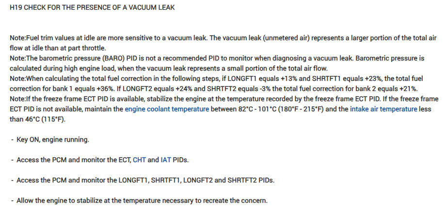

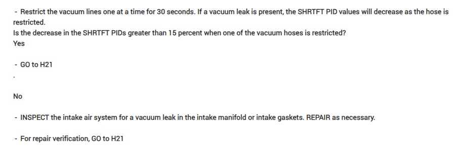

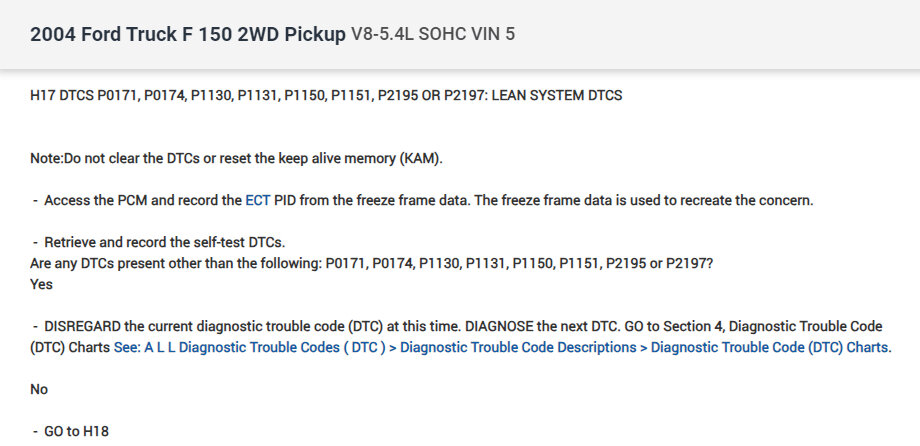

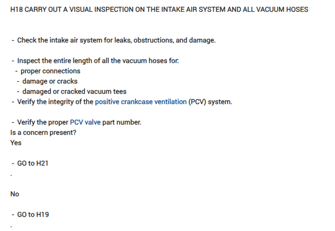

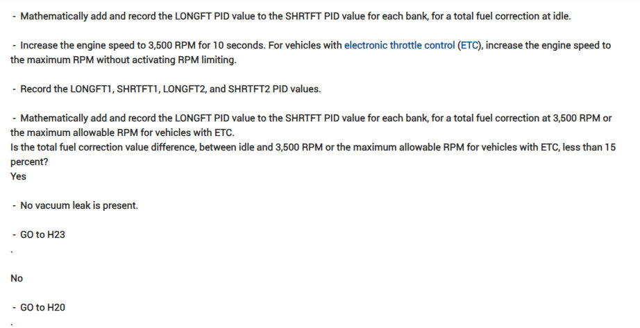

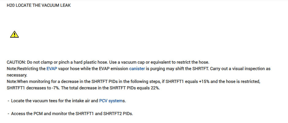

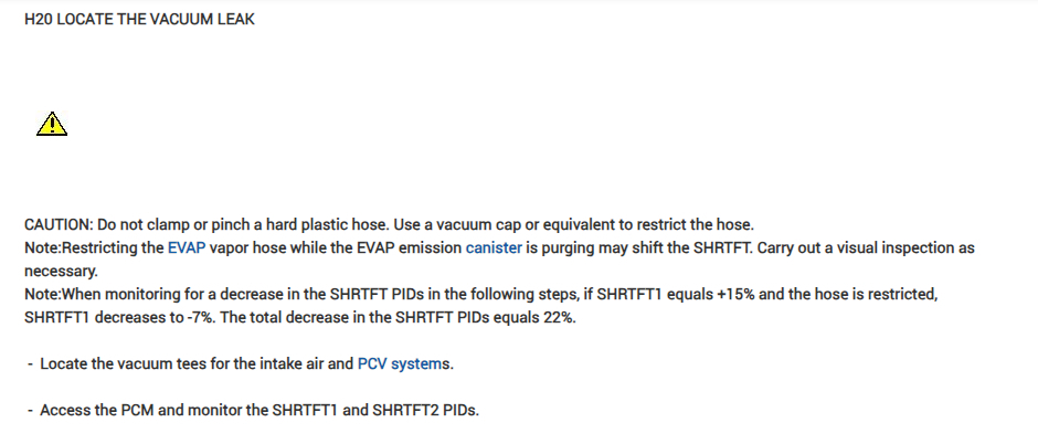

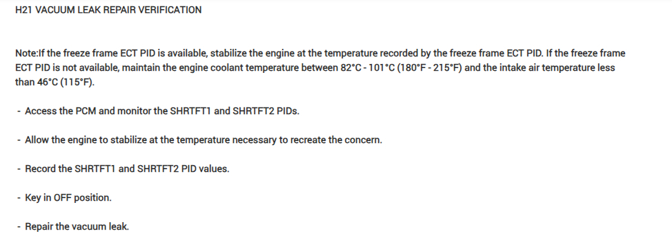

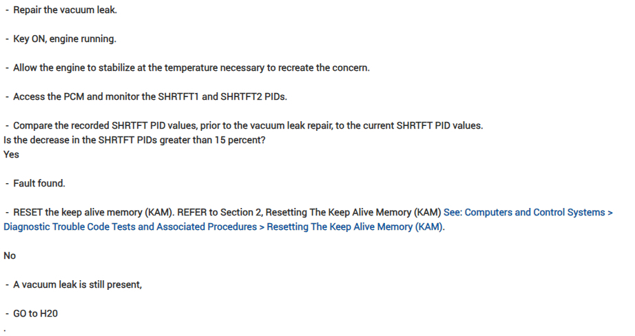

I went through the diagnostics again. Everything they indicate is related to either a coolant temperature sensor or an engine vacuum leak for this code.
I attached the diagnostics below specific to the code. It starts at step H17. Take a look through them and let me know if you are comfortable performing them or if you have already done what is suggested.

It sounds like the fuel pump is okay, I would still check the cats as well.
Key on, engine off .................... 240-310 kPa (35-45 psi)
Engine running .................... 193-310 kPa (28-55 psi)
