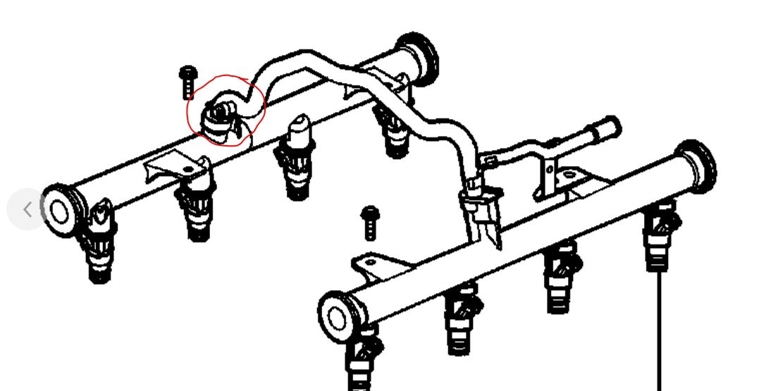

Check the fuel pressure regulator for leaks and check fuel pressure. Here is a link on the procedure and let us know what you measured:

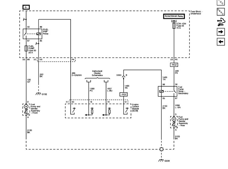

DENDENDEN
Code U0109 lost communications with fuel pump. Would it be the fuel pump or the module above the spare tire? shut off while driving (twice now) in the last six trips.
Sep 3, 2020 at 4:45 AM (Merged)
Good evening,
Below, I listed possible failures for the 109 code. it is a communication issue with the BCM.
When the truck shuts off, does it start right back up or does it have a long crank time? It could be a crank sensor or the fuel pump itself.

Hi, sometimes it starts back up most times it does not start for three hours. We thought that it might be the module above the spare tire, these where noted to get some water in them, just guessing. What do you think?
When it does not start, do you hear the fuel pump run?
there are a couple possible issue. the fuel pump, the fuel pump driver and also a crank sensor.
when it does not start, does the tachometer go up a little while cranking?

You need to use a fuel pressure gauge on it. This is a high pressure system that requires a MINIMUM of 55PSI to run. Fuel pump is a common failure.
