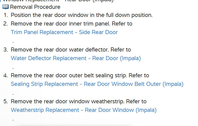

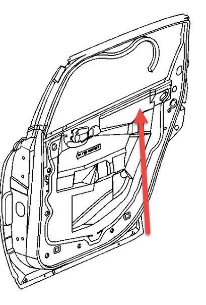

I want to know how to replace the rear door power window not the regulator
2003 CHEVROLET IMPALA
190,000 MILES
JOHN DEVINE
My window was knocked out from a burglary and it was closed when a rock was thrown threw it. I cannot for the life of me get the new glass window back in. I have got door rubber trim out and the glass is hitting the door panel and I cannot get the door to slide down in the door. I have to be missing something that's probably so simple. Please help, I have four kids and two are in college and they want to charge me $150.00 to install the new one. I found a glass at a junk yard for $45.00 and it came off a 2005 impala and if I am right all 2000 to 2005 widows are the same. I do not beg but if I can just get by spending the $45.00 only I would be so relieved.
Thanks,
John
Apr 10, 2017 at 5:42 AM
HMAC300
  • 48,601 POSTS

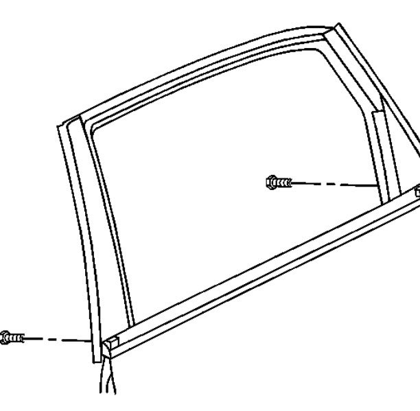

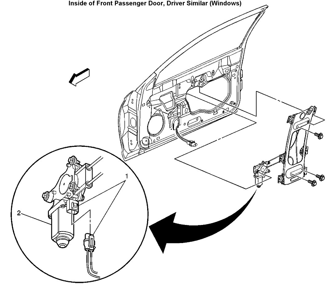

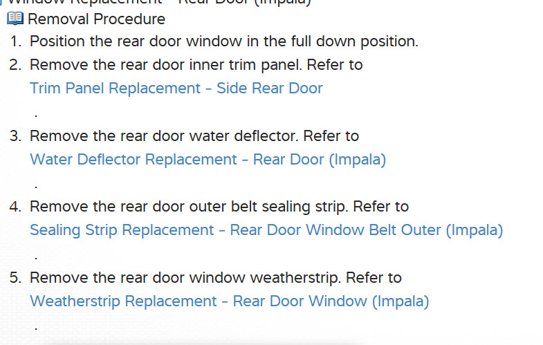

well the 2000 may be different hopeful you can follow by having regulator in down position see pictures for instructions.

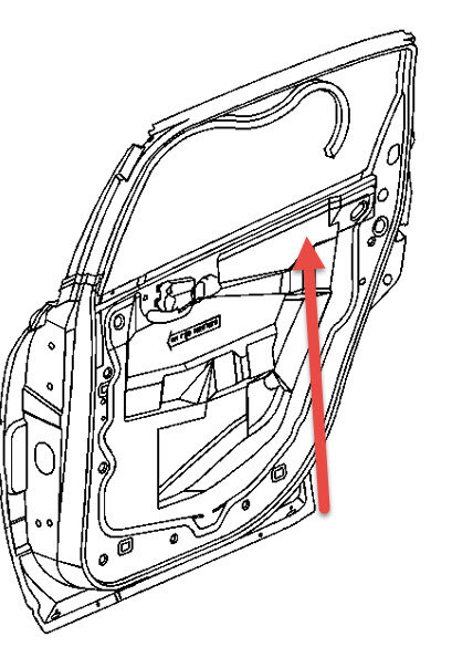

Here is your car below
Please let me know if you need anything else to get the problem fixed.

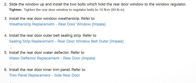

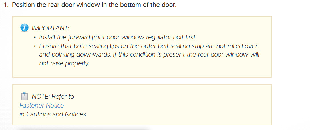

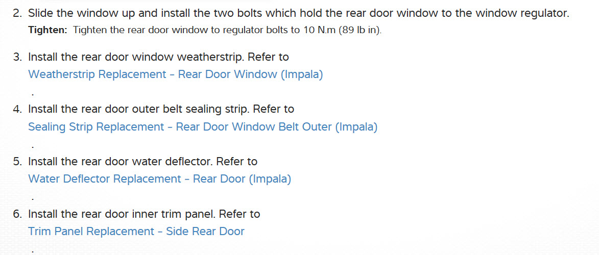

the first picture I sent is the removal process the second two pictures are the pieces that have to be removed. the regulator must be in the down position to do this then the final picture I sent is the way to put it back together. As I said in the reply the window from the 2000 impala may be different from the 2005 that is why you are having trouble. I am assuming you already have the door panel off as well.

I'have sent instructions for this all you have to do is put the current window in the down position then remove the aritcles in the picture that I have attached.it's not that hard.please re read my first reply with the instructions on bottom ppics
