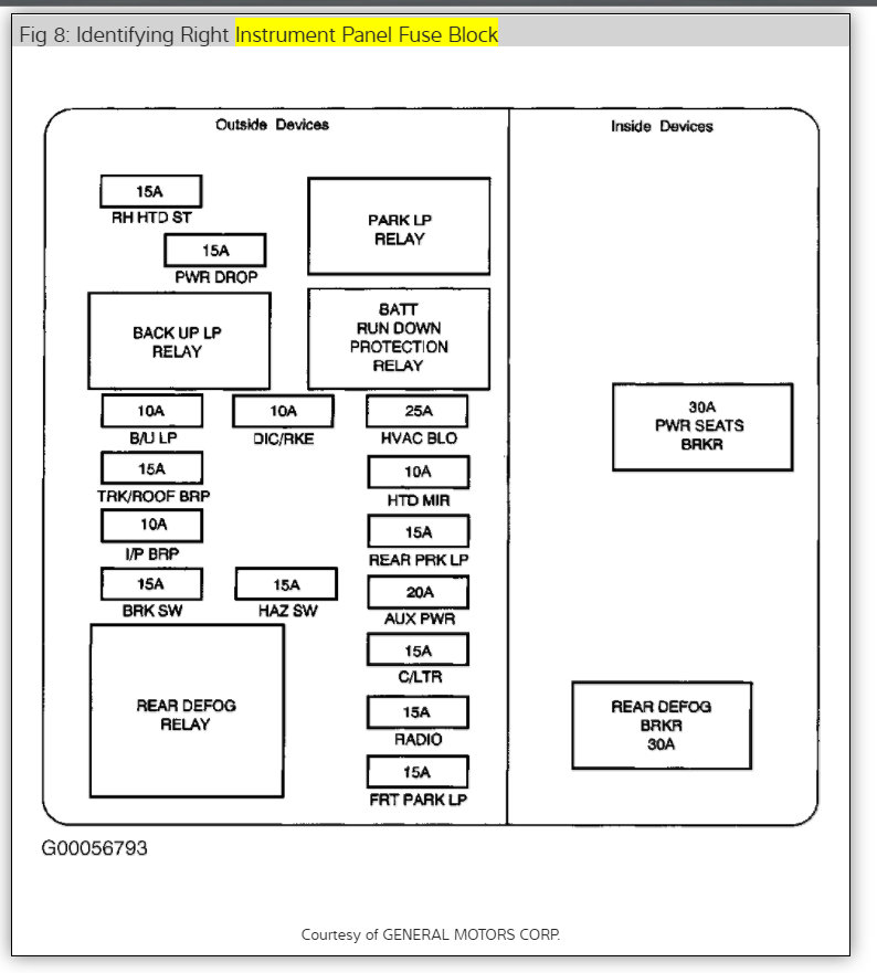

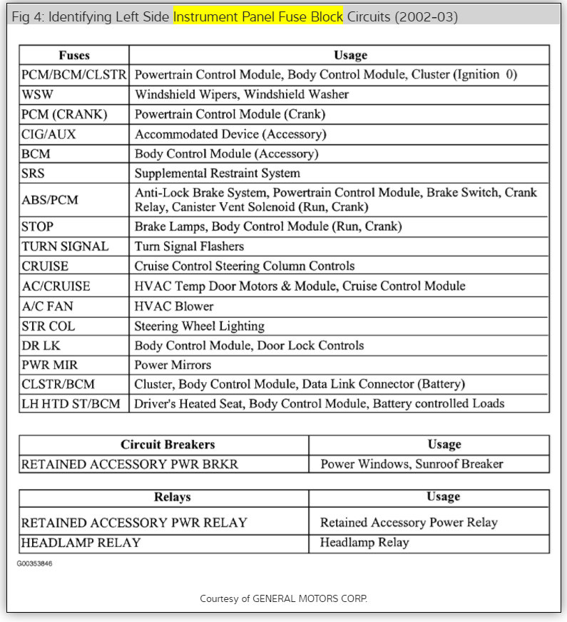

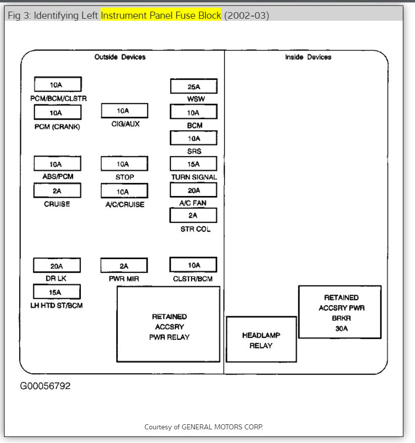

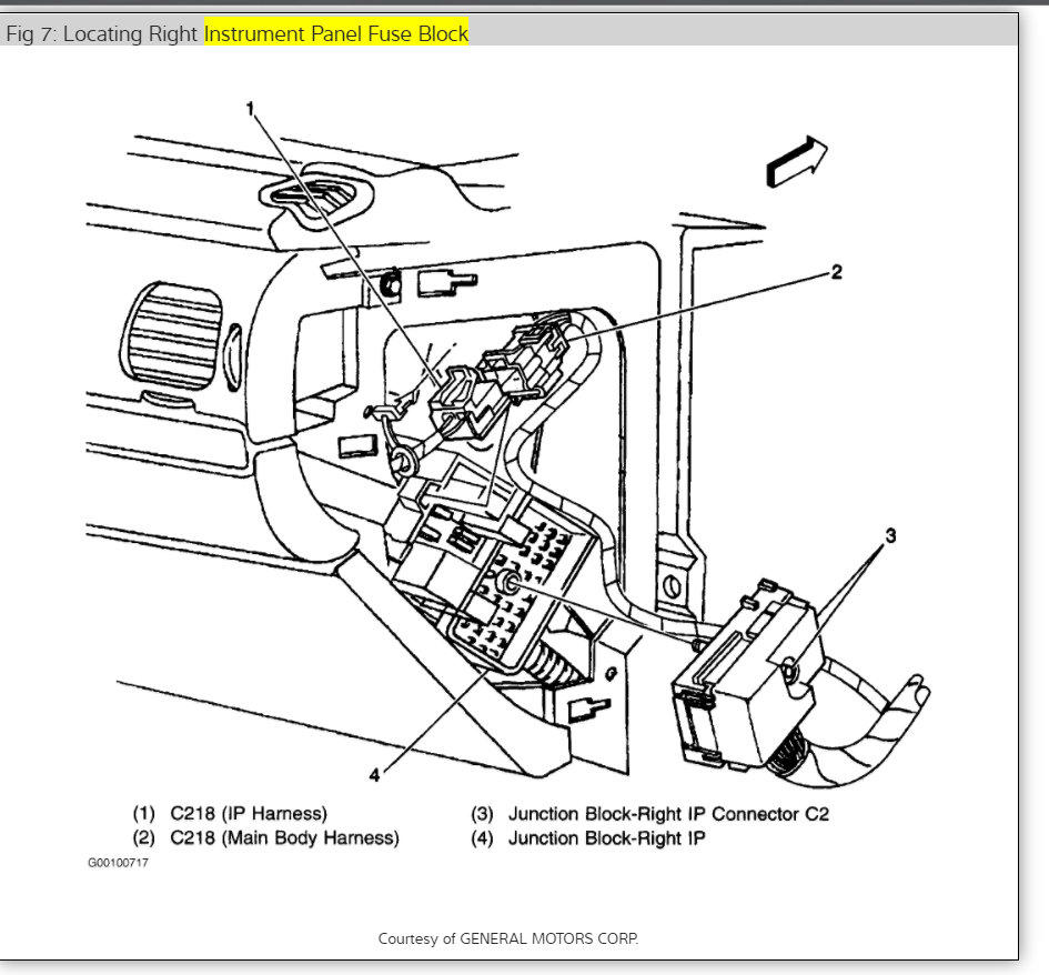

The power windows on my car just went fizzle when I tried to roll them down on the ninety degree day. I pulled the fuse box and checked each one and noticed that there is no fuse on the box for the power window system. How do I fix my windows and what do I need to do?
Jul 28, 2009 at 4:08 AM
TAKECHARGESARGE
  • 92 POSTS
Hi Swerve11,

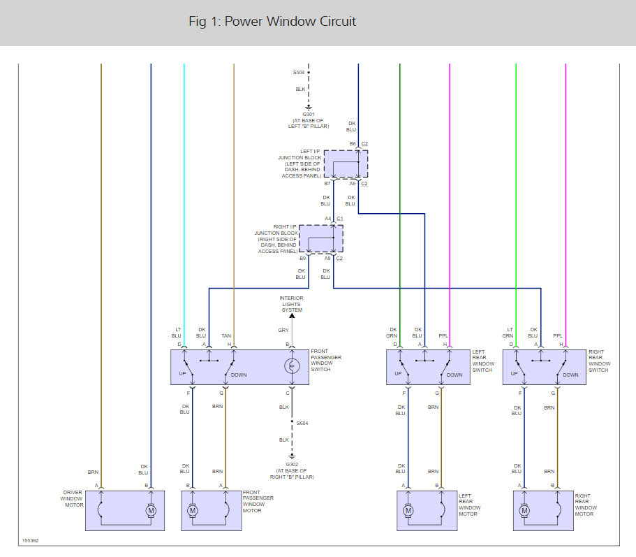

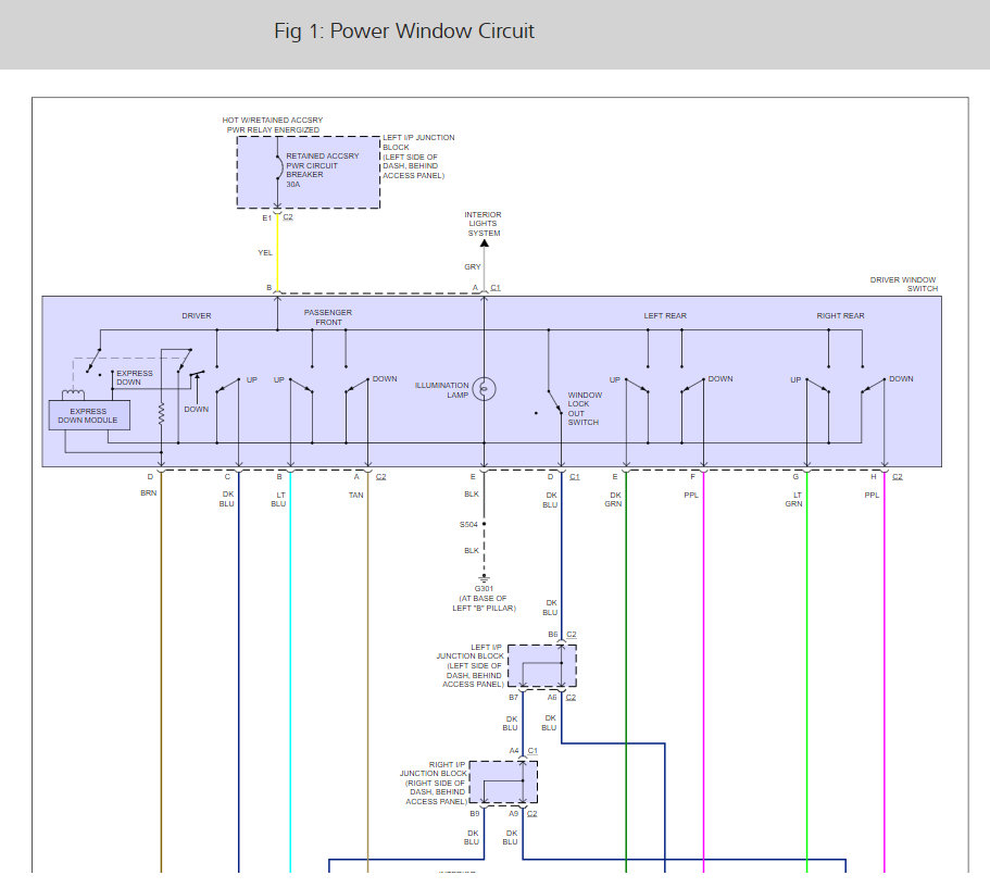

There is a circuit breaker for the power windows in the drivers side instrument panel fuse block. It is labeled "RETAINED ACCSRY/PWR BRKR" and its description is "power window, sunroof breaker". Here is a guide to help you test the switch and the wiring diagrams to help you see how the system works:
https://www.2carpros.com/articles/electric-window-repair
Check out the diagrams (below). Please run some tests and get back to us.
Cheers, TakeChargeSarge

When you try to operate windows, is circuit breaker hot to the touch? Main voltage to master switch, yellow wire, main ground is black. There is a lock-out switch at master switch, if it is tripped, only the driver can operate any of the windows. Usually the driver window motor will fail before the others, obvious reason.
Because it is a reversing motor, the circuits at the motor switch voltage and ground, depending on up or down.

Remove window switch and check for 12 volts at switch, ignition in "on".
If you do not have 12 volts then recheck fuses and fusible links.
