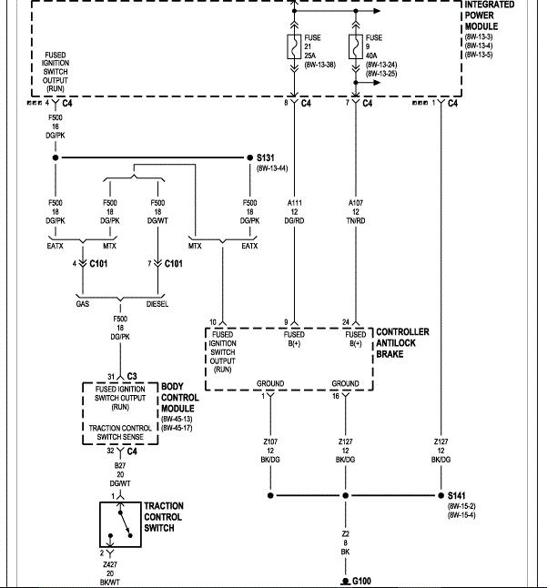

I pulled the abs fuse and put it back, now van won't start. Engine cranks but won't fire. The fuse was not blown I was looking for the fuse for the heater fan I put everything back the way I found it, I pulled out a couple of fuses but I put everything back the way it was.

I pulled the ABS fuse and put it back. I read chatter on the web saying that if you pull the Anti-lock Brake System fuse it trips something that makes it impossible to start the vehicle until you reset it. HOW do I reset it???
It's with the fuses located under the hood. I was initially looking for the heater fan fuse, but found no fuses for the heater. My heater blower quit working and I thought that was from a blown fuse. Maybe you can tell me how to get the heater fan working again.

I see no connection and have seen a connection to the abs not causing the car to start.
you need to check for spark and fuel pressure to see what is not working.
I attached a wiring diagram for you to review. you can see there is nothing of the ignition system involved
