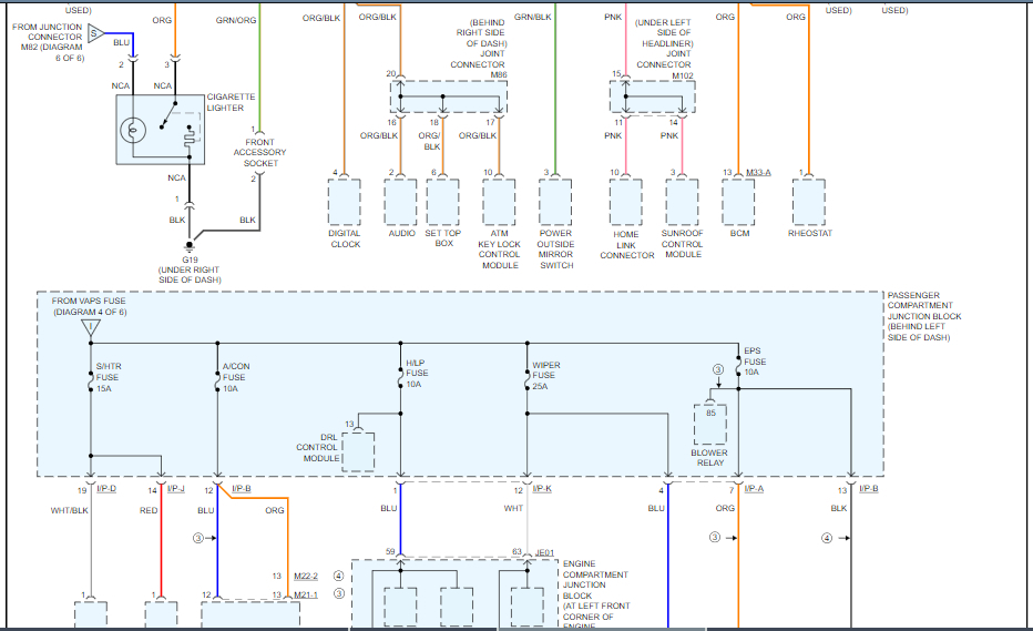

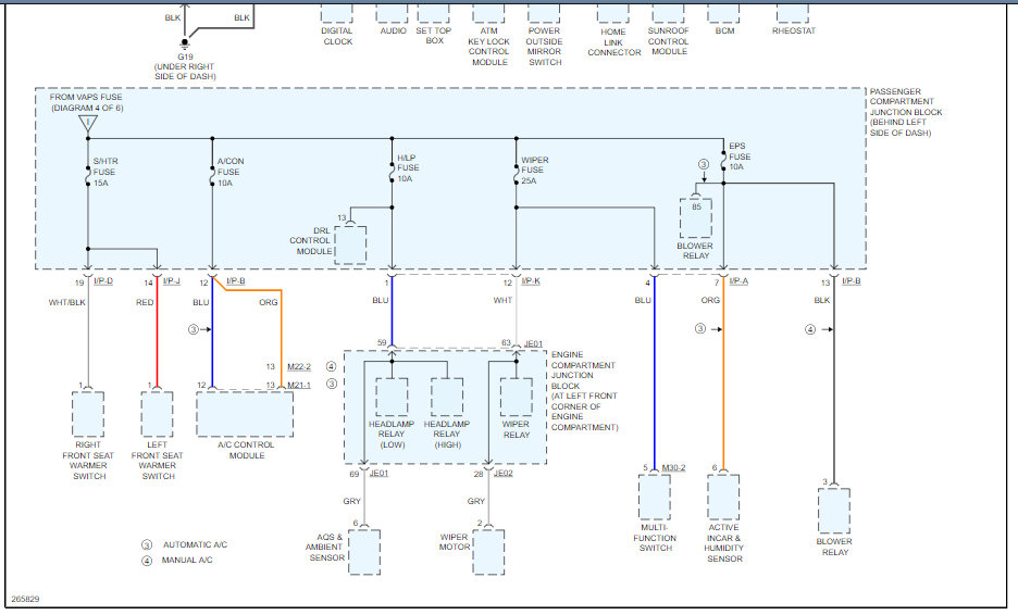

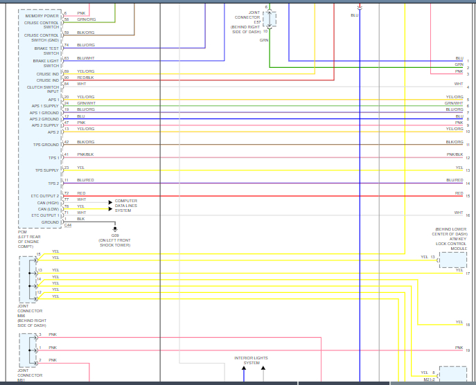

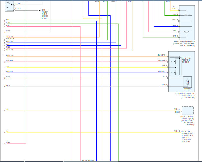

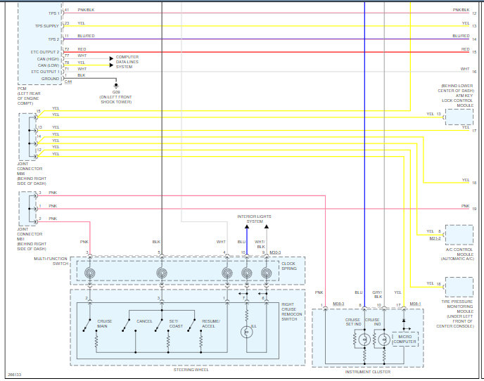

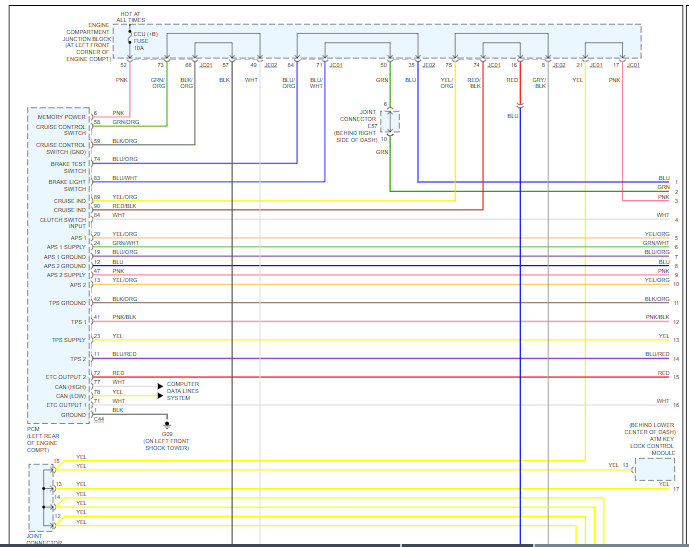

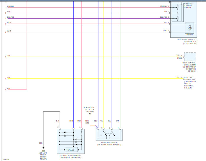

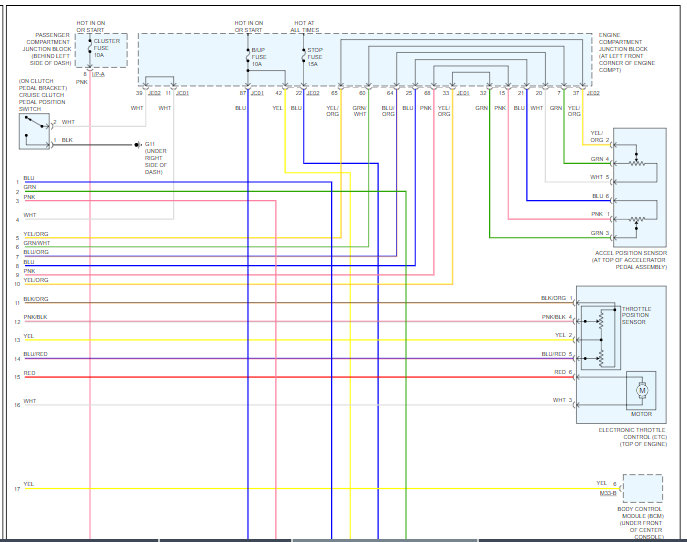

The cruise control wires in my car are not connected inside the car. Do I need to program the car to work? Where I connected it according to the scheme.
Saturday, June 12th, 2021 AT 11:52 AM
DANNY L
  • 5,648 POSTS
Hello again.
Here is the wiring diagram for the cruise control system. The wires will need to be attached to the multi-function switch which is located on the steering column. I've cut the pictures into 3 pieces each so you can view larger and attached them below. Hope this helps and thanks again for using 2CarPros.
Danny-

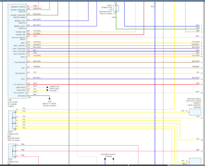

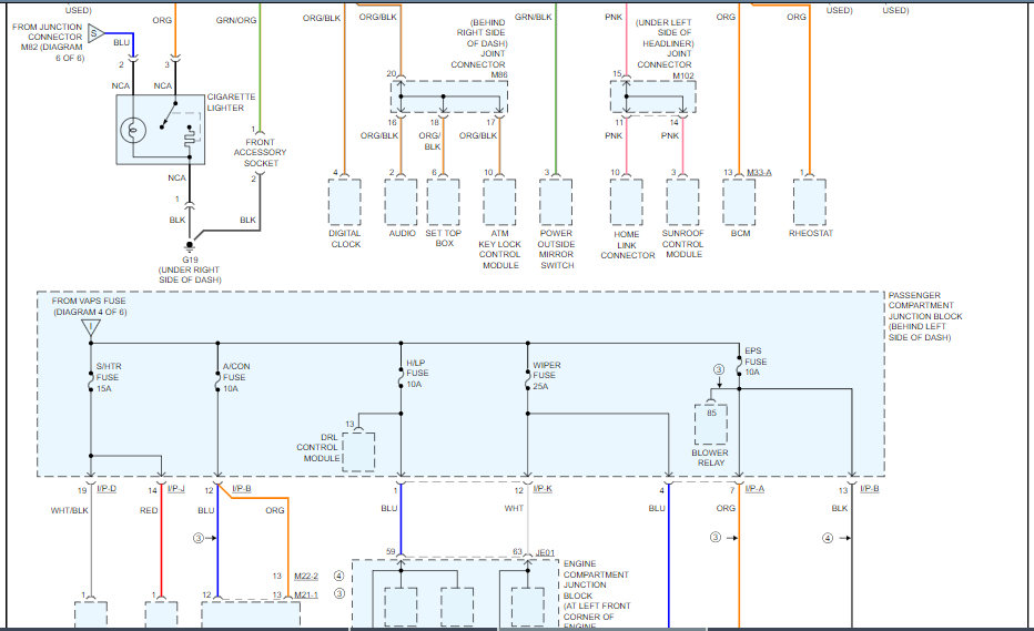

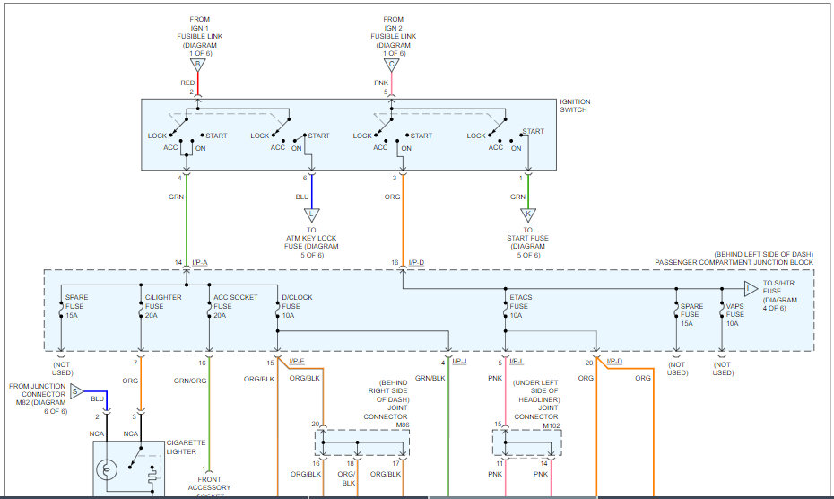

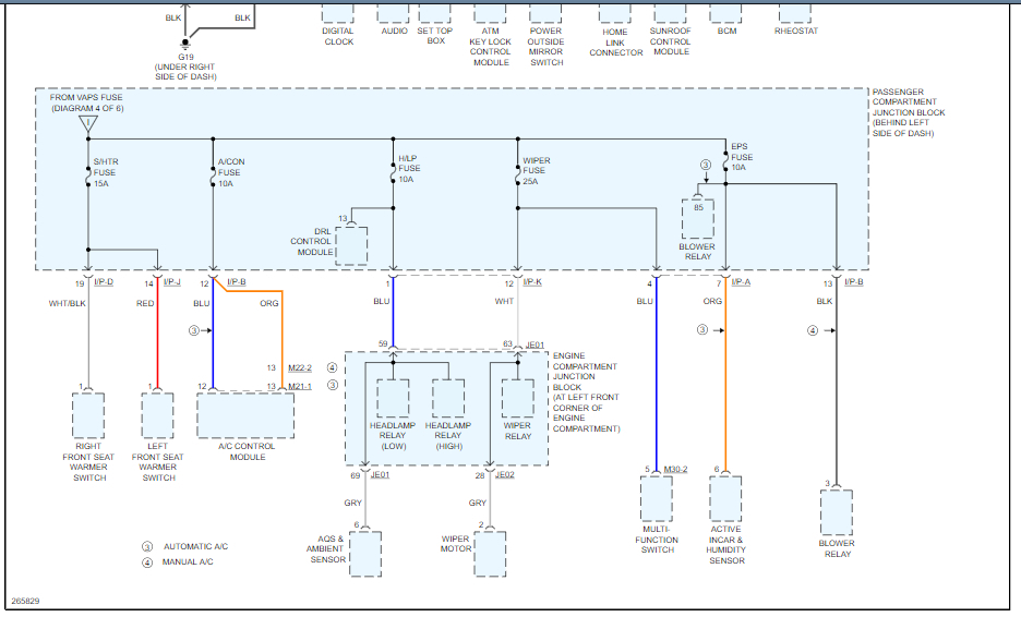

Can you provide me with a wiring diagram to start the car from the key?
Tuesday, September 14th, 2021 AT 1:03 PM
DANNY L
  • 5,648 POSTS
Hello again.
Here is the information you requested. I've attached below the ignition switch wiring diagram for your Hyundai. I've cut the picture into three pieces so you can view larger. Hope this helps and thanks again for using 2CarPros.
Danny-
