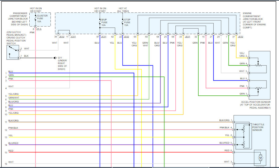

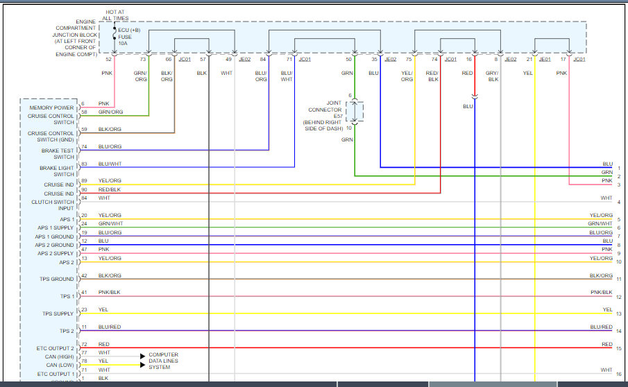

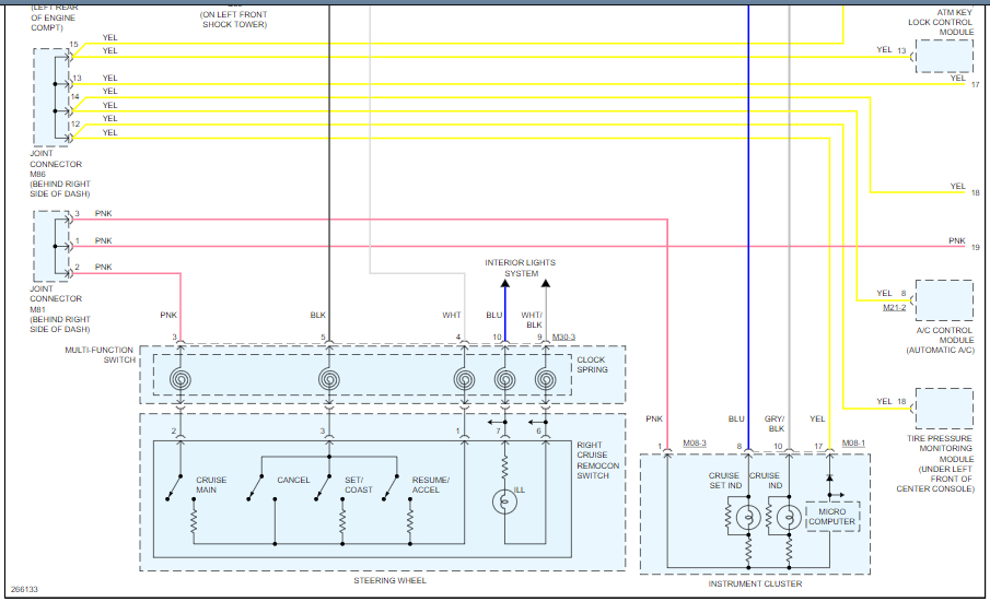

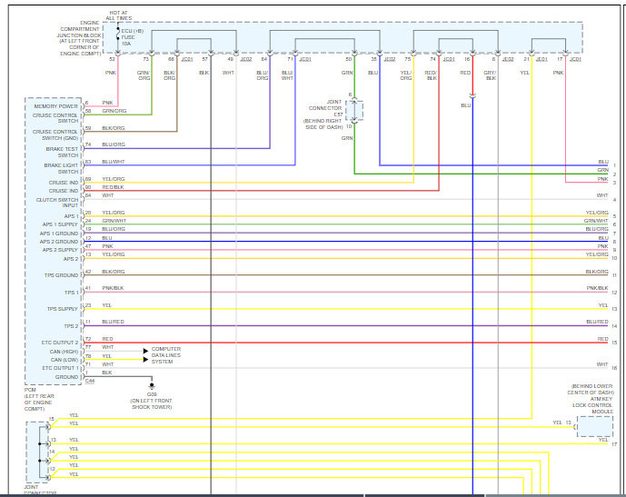

I need a cruise control wiring diagram.
Jun 1, 2021 at 10:06 AM
DANNY L
  • 5,648 POSTS
Hello again.
Here is the information you requested. This is a tutorial for you to view on how to test electrical wiring:
I've attached below the cruise control wiring diagram for your vehicle. I've cut the pictures into 3 pieces so you can view larger. Hope this helps and thanks again for using 2CarPros.

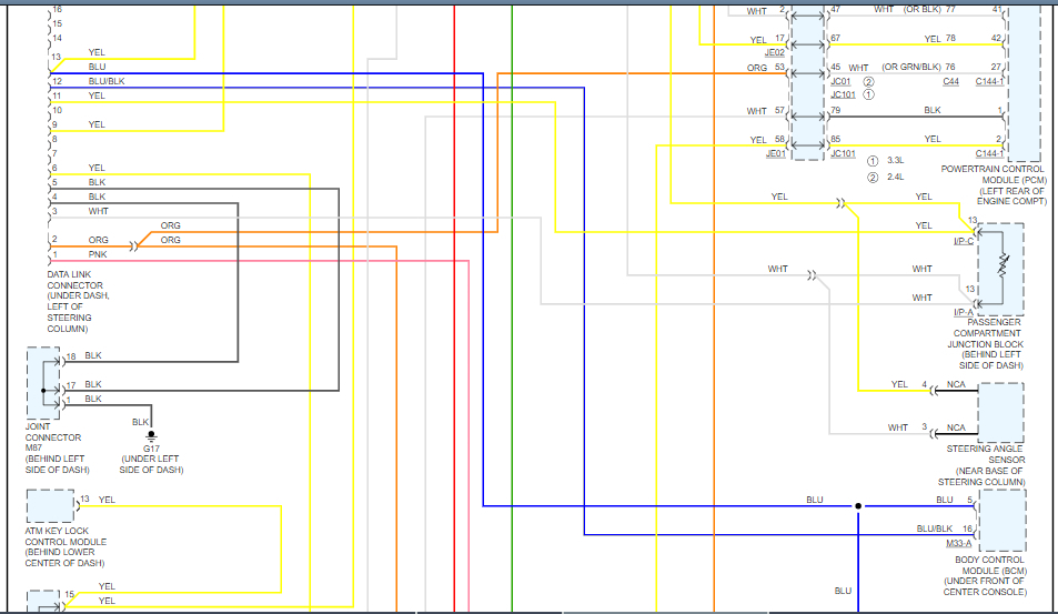

And I need computer data lines wiring diagram.
Jun 2, 2021 at 6:35 AM
DANNY L
  • 5,648 POSTS
Hello again.
Here is the computer data line wiring diagram you requested. I've cut the picture into 3 pieces so you can view larger. Hope this helps and thanks again for using 2CarPros.

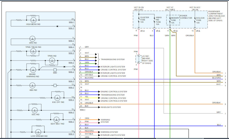

I need speedometer wiring diagram.
Jun 3, 2021 at 11:49 AM
ALAZRI
  • 19 POSTS

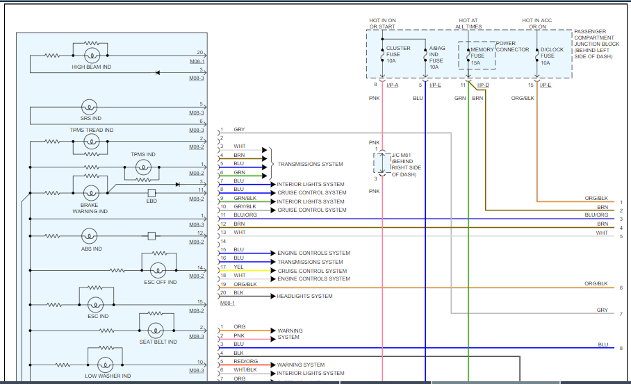

I need Instrument Cluster Wiring Diagram.
Jun 3, 2021 at 2:07 PM
DANNY L
  • 5,648 POSTS
Hello again.
I've attached the instrument-cluster panel wiring diagram below which also includes the speedometer. I've cut the pictures again into 3 pieces so you can view larger. Hope this helps and thanks again for using 2CarPros.

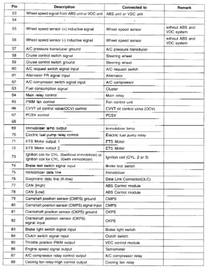

ALAZRI
  • 19 POSTS

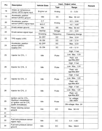

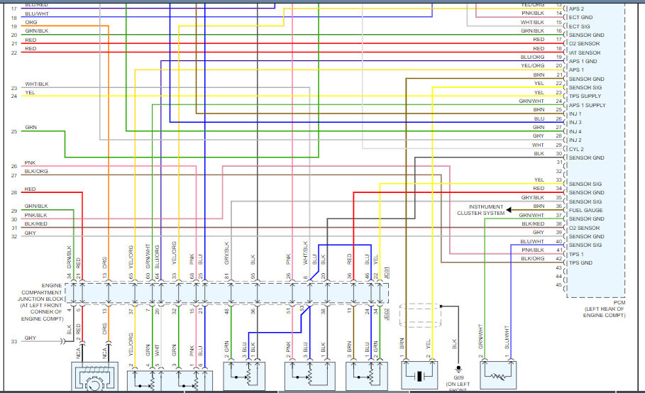

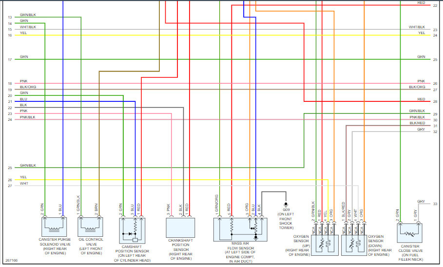

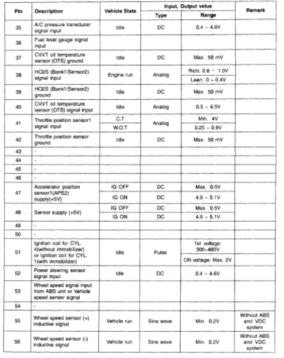

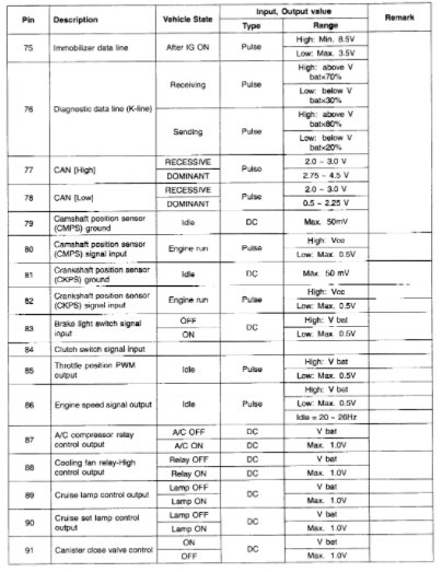

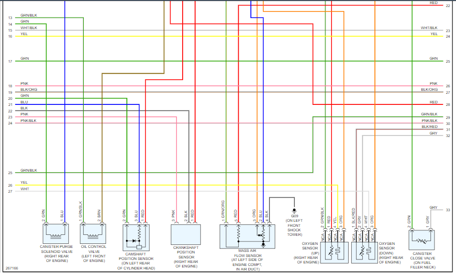

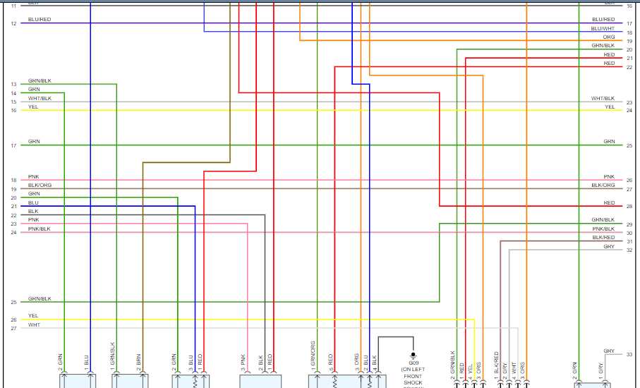

Both, I need PCM and ECM wiring diagram.
Jun 4, 2021 at 9:57 PM
DANNY L

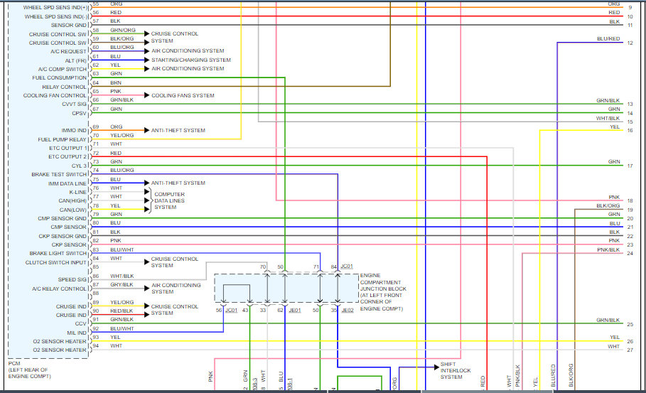

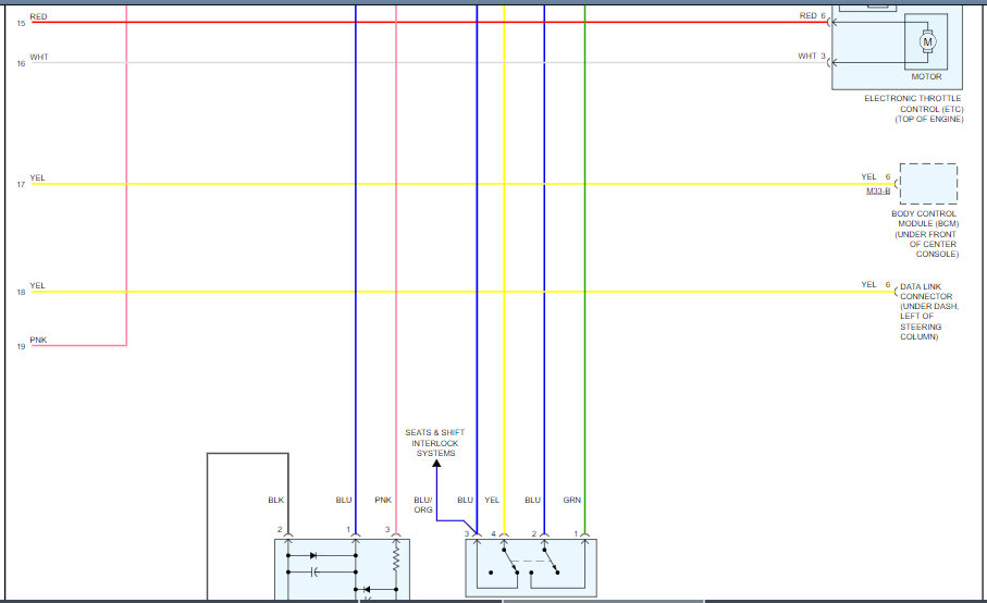

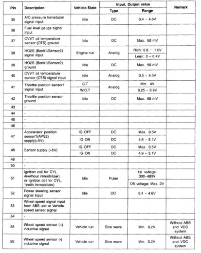

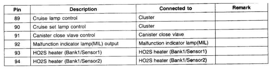

  • 5,648 POSTS
Hello again.
Here is the diagrams you requested. I've attached below the ecm pin out below. I've also attached the wiring diagram and cut into 3 pieces so you can view larger. Hope this helps and thanks again for using 2CarPros.

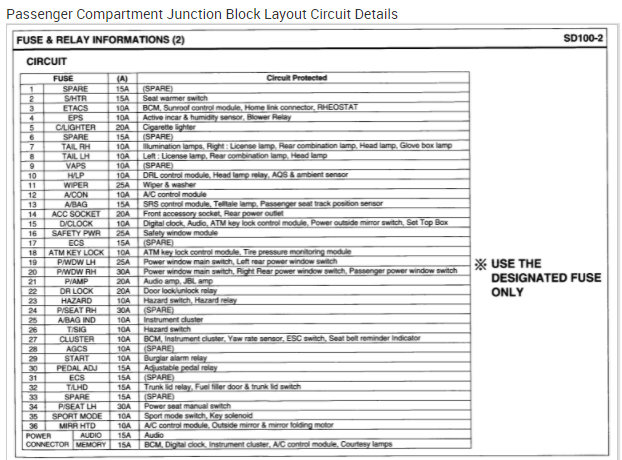

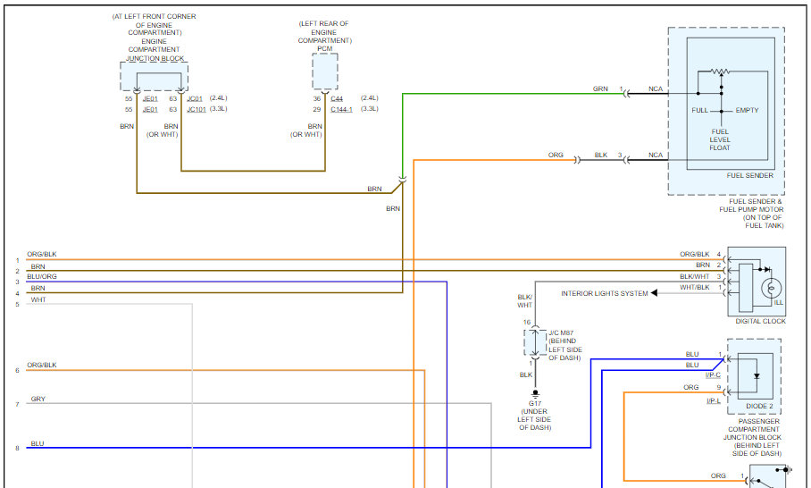

I need fuse wiring diagram.
Jun 5, 2021 at 10:00 PM
DANNY L
  • 5,648 POSTS
Hello again.
Here is the fuse diagram you requested. I've attached the pictures below for your Hyundai. Hope this helps and thanks again for using 2CarPros.

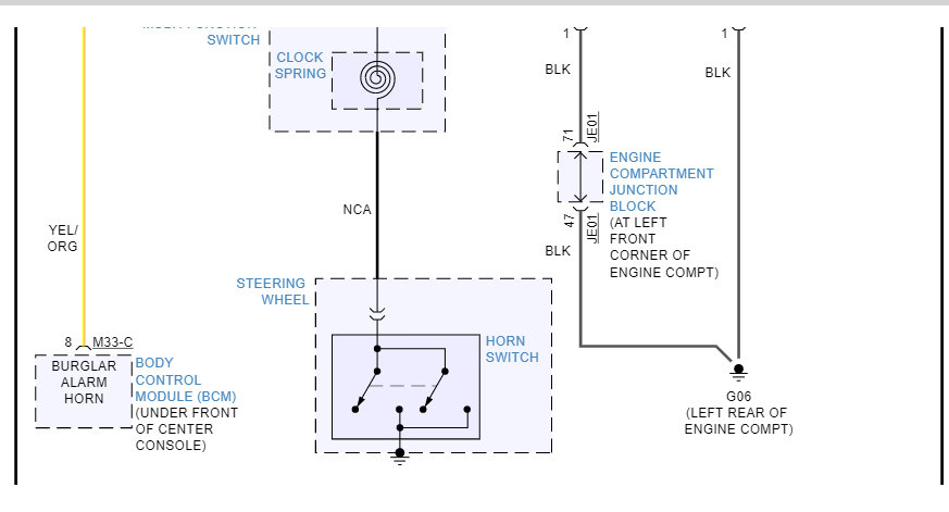

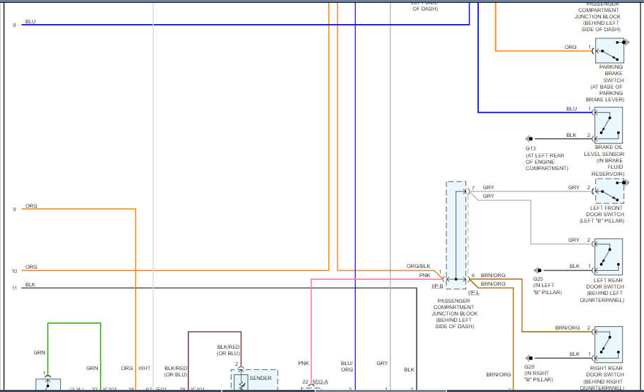

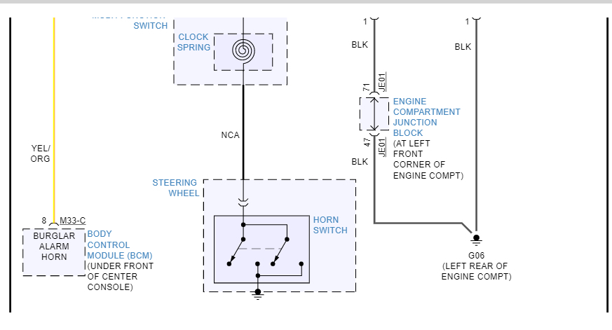

I need clock spring wiring diagram.
Jun 7, 2021 at 11:13 AM
ALAZRI
  • 19 POSTS
Where can I find the joint connector M81?
Jun 7, 2021 at 11:57 AM
DANNY L
  • 5,648 POSTS
Hello again.
Here is the clock spring diagram you requested. I've cut it into 3 pieces so you can view larger. I've also attached a picture of M81 joint connector which is located behind right side of dash. Hope this helps and thanks again for using 2CarPros.

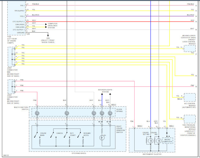

The cruise control wires in my car are not connected inside the car. do I need to program the car to work? Where I connected it according to the scheme.
Jun 12, 2021 at 11:52 AM
DANNY L
  • 5,648 POSTS
Hello again.
Here is the wiring diagram for the cruise control system. The wires will need to be attached to the multi-function switch which is located on the steering column. I've cut the pictures into 3 pieces each so you can view larger and attached them below. Hope this helps and thanks again for using 2CarPros.
