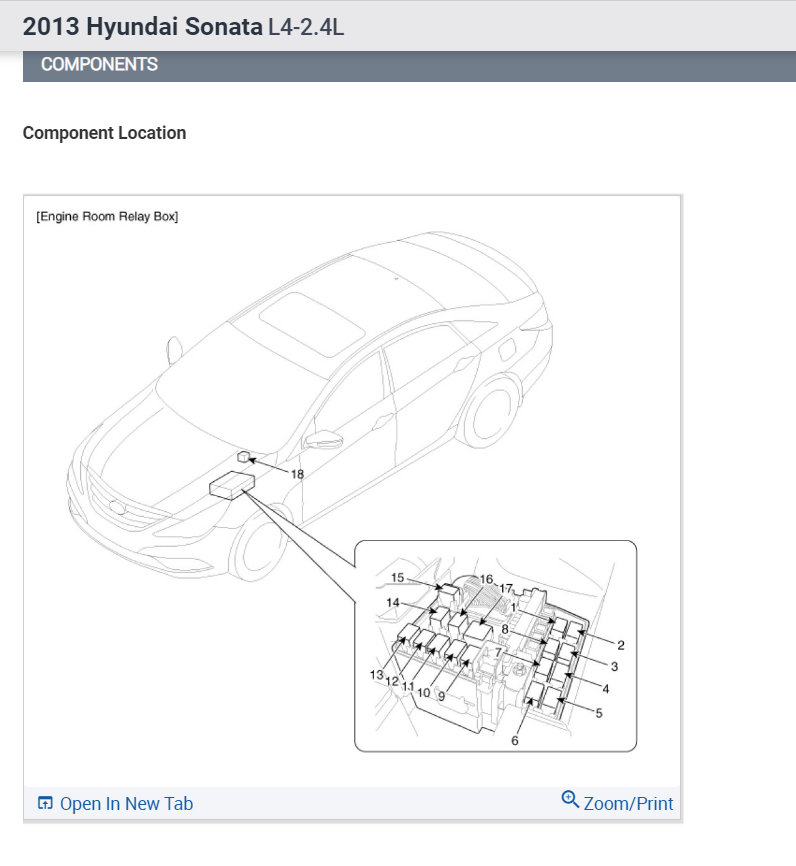

It will start and I can let it run for 10 minutes, cut it off and it won't crank over again until hours later or the next day. I had a starter put on it and it's still doing the same thing. what could that be?
Aug 10, 2022 at 10:26 PM
  • 55,224 POSTS

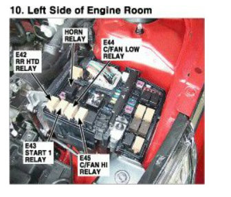

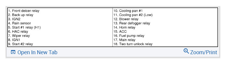

Can I ask if the security light is flashing when you try to crank it over? If not, it sounds like you have a start 1 relay that needs to be replaced.
Here is a guide and the location of the relay so you can check it out and replace the relay:
