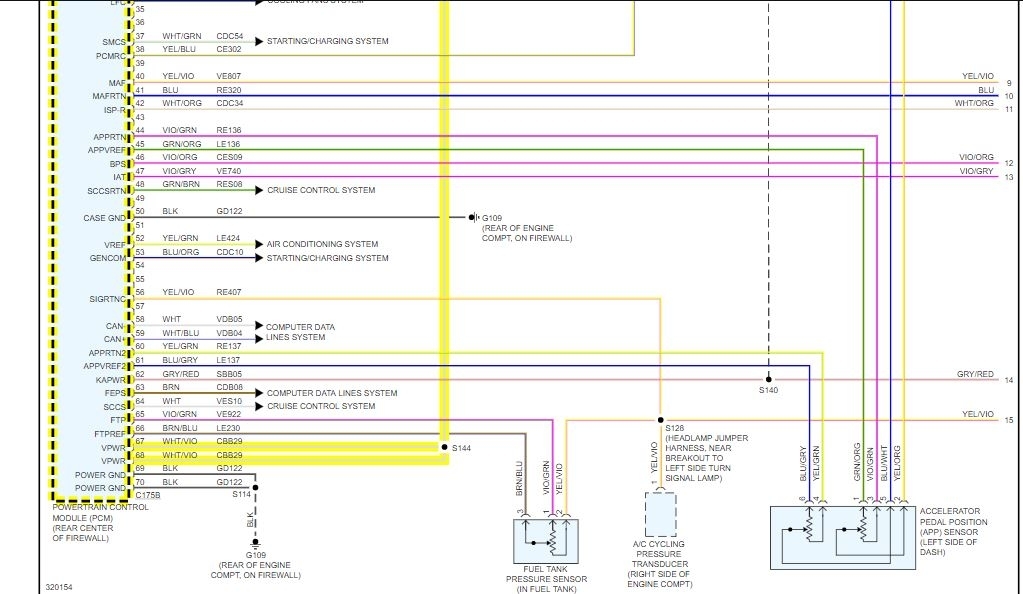

I need the PCM pinpoint
ETTIEP
  • 2010 FORD ESCAPE
  • 3.0L
  • V6
  • 100 MILES
I need to check kapwr.

I am suspecting that we are calling this pinpoint test different things. Do you have a code or the alphabetical callout for it? Ford lists their tests as A, B, C, etc up to QC on some vehicles.
3.01 is just not a pinpoint test that I am familiar with. If you give me a little more detail on what you are working on or the issue/code that you have I will be able to get the test you are looking for. Thanks

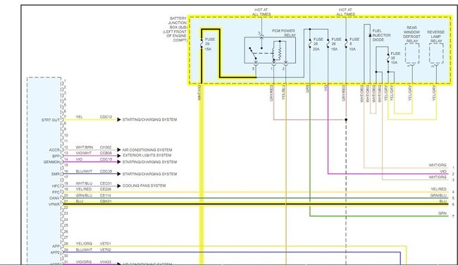

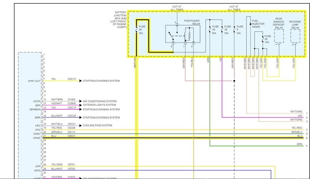

Good afternoon,
I attached the diagram. There are 3 powers for the ECM. I highlighted them for you.
What is the issue?
