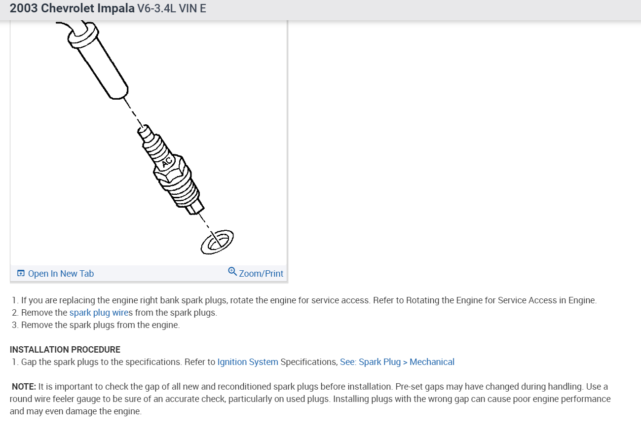

car would lose power when I would come to a stop and sometimes stall?
135,000 MILES • 3.4L • V6 • 2WD • AUTOMATIC
INKYJC513
Then weeks later, it would struggle to accelerate over 15-20 MPH and it sounds and feels like it’s running rougher. Now when I start it, it shakes really rough and won’t stay running more than a few seconds.

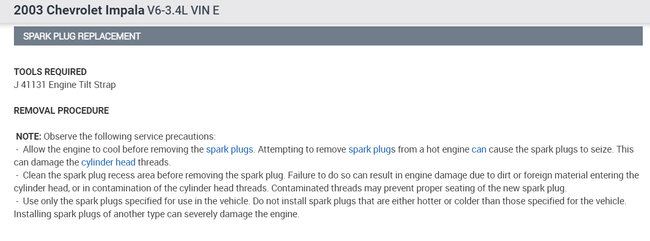

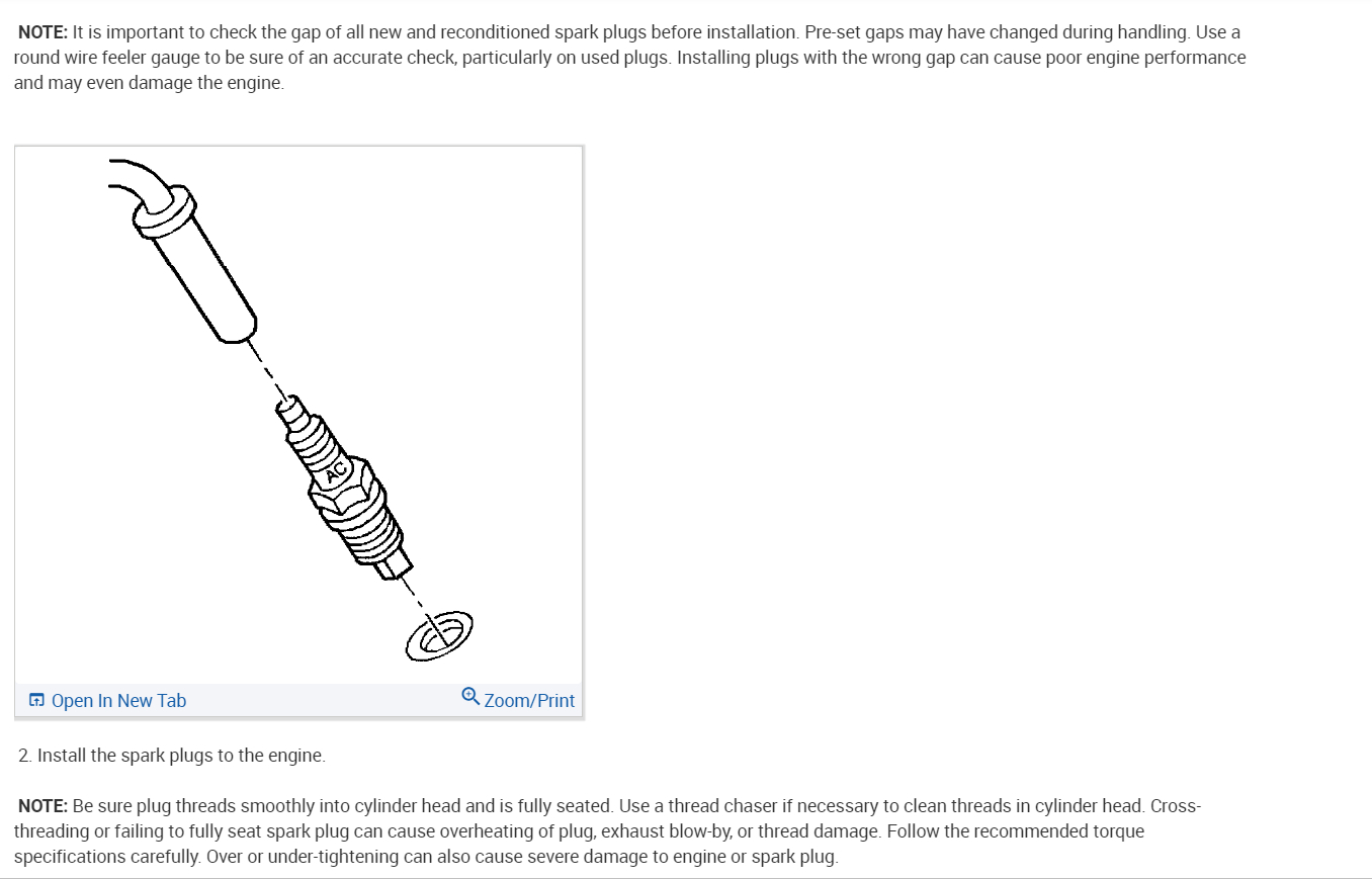

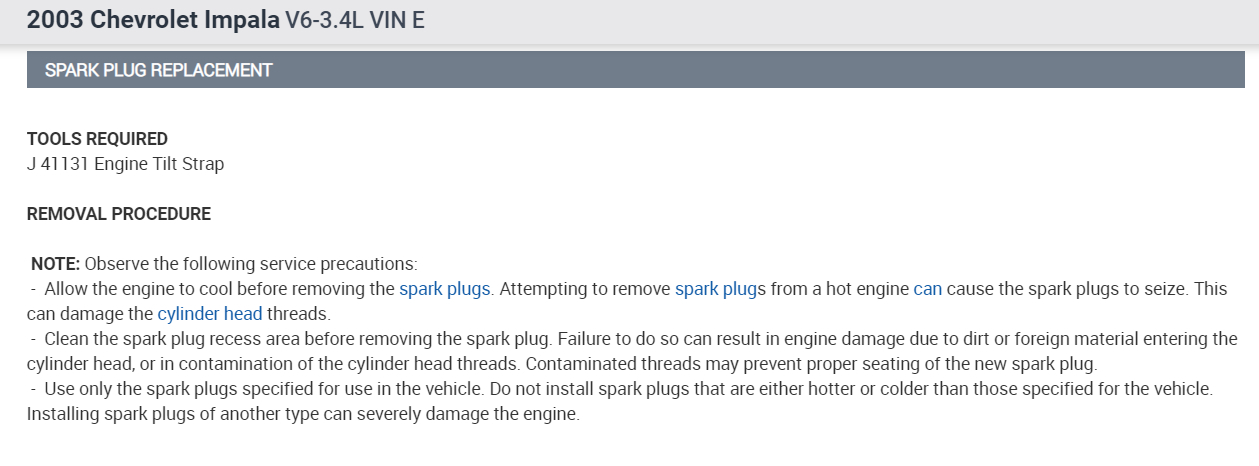

It sounds like the engine is misfiring but if you can upload a short video of the engine running, (under the hood) it will help. We need to run the codes to see what comes up. Also, I would change out the spark plugs and service the throttle bore.
Here are guides to help and instructions in the images below to help you fix your car:
and
https://www.2carpros.com/articles/how-to-tune-up-a-car-engine
Spark Plug Type .................... AC Delco 41-940
Tighten
- If installing the spark plugs to a new cylinder head tighten the plugs to 20 N.m (15 lb ft).
- If installing the spark plugs to an existing cylinder head tighten the plugs to 15 N.m (11 lb ft).
1. Install the spark plug wires to the spark plugs.
2. Release the J 41131 and return the engine to the original position.
3. Install the engine mount struts.
Check out the images (below). Let us know what happens and please upload pictures or videos of the problem.
