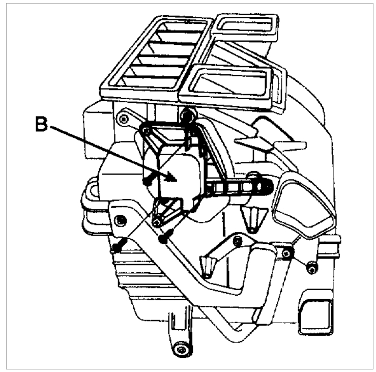

I have the heat set to 70 degree but it will not let the hot water into the heater, so it only gives out cold air into the car,what is the problem? I love this site
Jan 15, 2009 at 5:03 AM
  • 55,579 POSTS

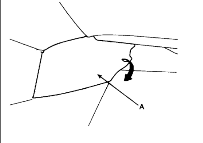

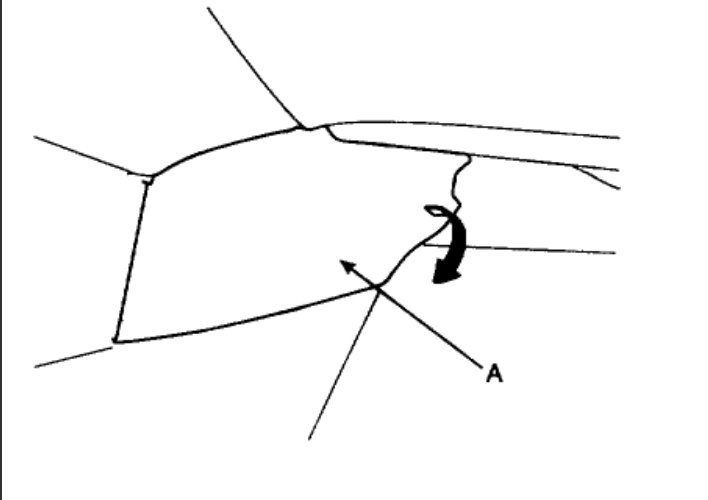

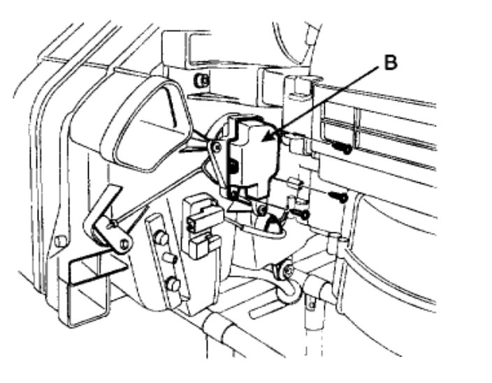

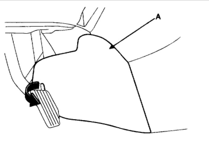

It sounds like you have a temperature blend door actuator that is not working which is common. Here are some guides so you can check out what's going on and get the problem fixed. This guide will give you an idea of what you are in for when doing the job.
Here is a guide that can help as well.
Below is the diagrams of how to will be like to replace the actuator on your car I have feature the temperature and the mode (second) actuators just in case.
