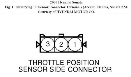

If the TPS is removed and installed, it has to be calibrated/adjusted correctly. Sonata (2.5L) 1. Turn ignition off. Disconnect TP sensor 3-pin connector. Measure resistance between TP sensor terminals No. 2 (sensor ground) and No. 3 (sensor 5-volt supply). See Fig. 1 . Standard resistance value should be 3500-6500 ohms. If resistance is not as specified, replace TP sensor. If resistance is as specified, go to next step.
https://images.2carpros.com/forum/automotive_pictures/192750_TPS00SonataFig01_1.jpg
2. Measure resistance between TP sensor terminals No. 1 (sensor signal) and No. 2 (sensor ground). Open throttle slowly from idle position to wide-open throttle position. Resistance should change smoothly in proportion to the throttle valve opening. If resistance changes smoothly, go to next step. If resistance does not change smoothly, replace TP sensor. 3. Ensure basic idle speed is correct. Turn ignition off. Disconnect TP sensor 3-pin connector. Using jumper wires, connector an ohmmeter between TP sensor terminals No. 1 (sensor signal) and No. 2 (sensor ground). Insert a 0.0256" (0.65 mm) feeler gauge between throttle level and throttle stop. 4. Loosen TP sensor mounting screws and rotate sensor fully counterclockwise. Ensure continuity exists between sensor terminals No. 1 and 2. Slowly turn sensor clockwise until continuity does not exist between sensor terminals No. 1 and 2. Tighten sensor mounting screws. 5. Reconnect TP sensor connector. Using a voltmeter, backprobe sensor connector terminals No. 1 (sensor signal) and No. 3 (5-volt supply). Turn ignition on, and measure TP sensor voltage. Voltage should be 250-800 millivolts. If voltage is not as specified, ensure TP sensor adjustment is correct and wiring harness is okay. Remove feeler gauge, and turn ignition off. Perform additional repairs as necessary.

Problem solved. The wires were crossed. I cant believe it. I went to a mechanic to save couple hundred and ended up costing me 700. I hope this can become a lesson. Engine runs beautifully now. engine light is off.

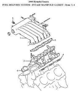

when you do v6 Hyundai sonata 2000 tune up. DO you need a new intake plenum gasket or manifold gasket or they are the same?
Oct 1, 2010 at 3:33 PM
KHLOW2008
  • 41,814 POSTS
They are different. The plenum ( upper intake manifold) gasket is what you need. For tune up you only need to remove the upper manifold.
https://images.2carpros.com/forum/automotive_pictures/192750_Manifold00Sonata_1.jpg
