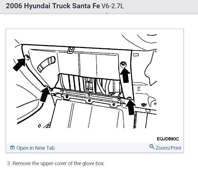

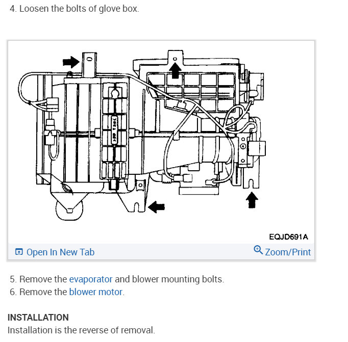

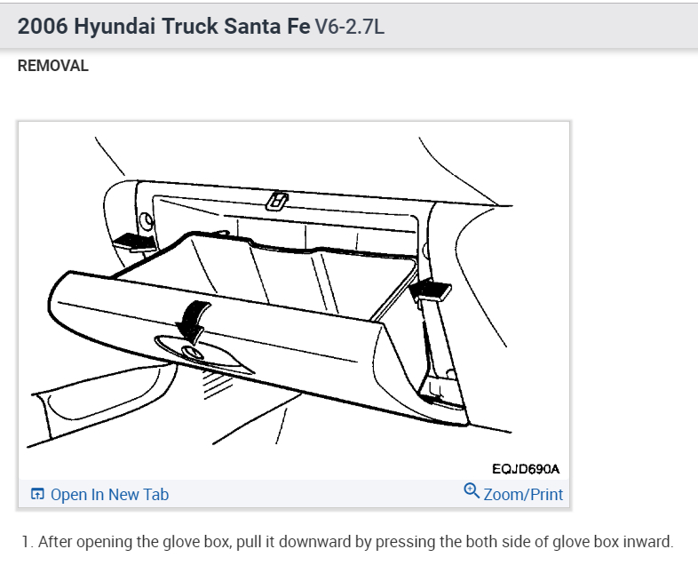

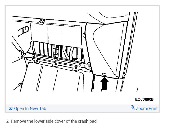

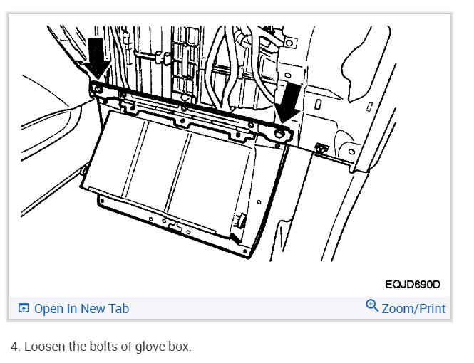

Blower motor not working
2006 HYUNDAI SANTA FE
50,000 MILES • 6 CYL • 2WD • AUTOMATIC
BAXLEY8476
Why is my air conditioning is not blowing any air neither hot nor cold?
Jun 28, 2009 at 7:21 AM
  • 110,244 POSTS

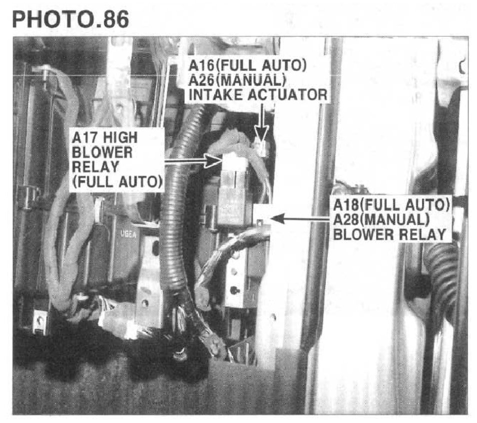

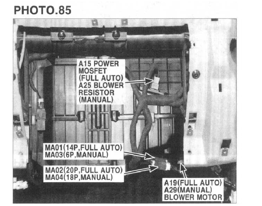

It sounds like you have a blower motor or relay that has gone out but to be sure lets run down this guide which shows how to test for power at the motor with wiring diagrams below and th blower and relay locations as well so you can see how it works.

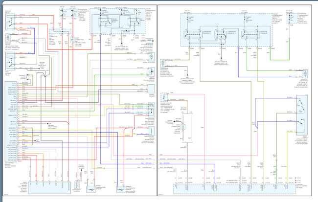

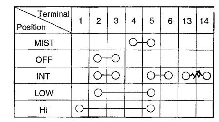

I took out the blowe rmotor on my hyunday 03 santa fe but I tested the blower and it works. Somone says I should check for a bad resistor....where would this be located?
Jan 26, 2019 at 8:17 AM (Merged)

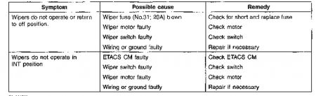

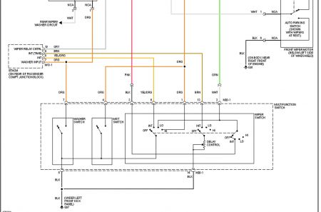

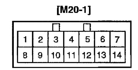

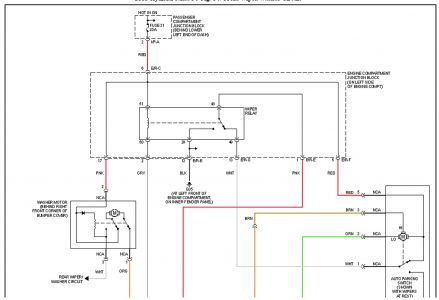

SERVICE WRITER
  • 9,123 POSTS
Systems that use a resistor will keep the "high" setting for the motor separate, bypassing the resistor because high means no resistance. I don't believe your system has one, but maybe the someone you talked to could tell you. Here is the chart to troubleshoot.
https://images.2carpros.com/forum/automotive_pictures/30961_sant1_1.jpg
These are the wiper switch continuity tables and the connector view so you can test for contunuity.
https://images.2carpros.com/forum/automotive_pictures/30961_san2_1.jpg
https://images.2carpros.com/forum/automotive_pictures/30961_san3_1.jpg
This is the wiring diagram for the entire wiper circuit.
https://images.2carpros.com/forum/automotive_pictures/30961_san4_1.jpg
https://images.2carpros.com/forum/automotive_pictures/30961_san5_1.jpg

TOM HOB
the blower ouit working I checked the fuses under the dash also under the hood could you tell me where the blower is located and if you have any advice for me .
Jan 26, 2019 at 8:18 AM (Merged)
  • 110,244 POSTS
The motor is under the dash on the passanger side. Check to see if it is getting power. If it is, then the motor is most likely bad.
Let me know what you find.
