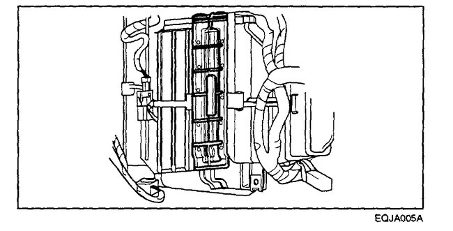

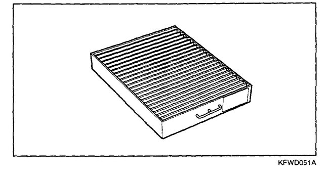

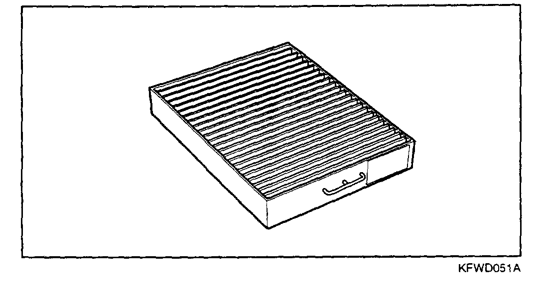

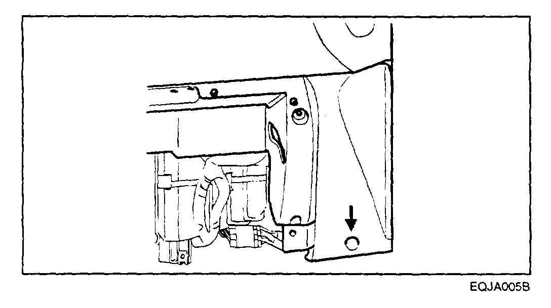

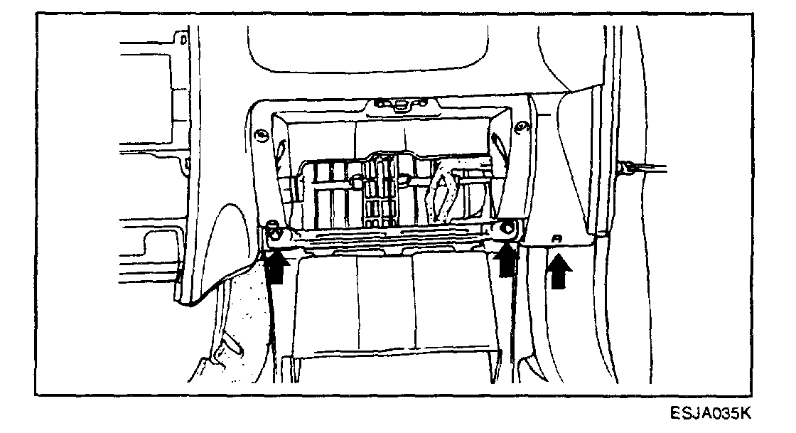

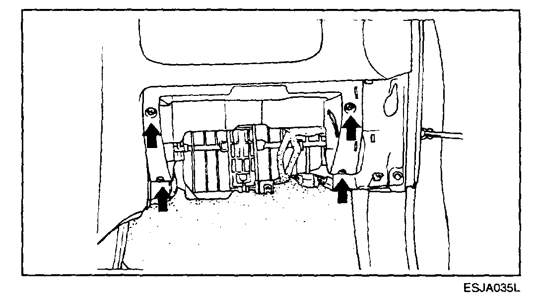

How to change. Does glove box have to be removed? Are there latches or screws ?
Mar 22, 2009 at 2:46 PM
  • 110,194 POSTS
Yes, the glove box will need to be removed, but it is easy to do. Here are the directions specific to this vehicle. The attached pictures correlate with the directions.
2003 Hyundai Truck Santa Fe V6-2.7L
Removal and Installation
Vehicle Heating and Air Conditioning Cabin Air Filter / Purifier Service and Repair Procedures Removal and Installation
REMOVAL AND INSTALLATION
BLOWER UNIT AIR FILTER
pic 1
1. Remove the glove box housing.
pic 2
2. Remove the lower side cover of the crash pad.
pic 3
3. Remove the upper cover of the glove box.
pic 4
4. Remove the air filter cover and the air filter.
pic 5
CAUTION: When driving in an air-polluted area or rugged terrain, check and replace the air filter as frequently as possible.
