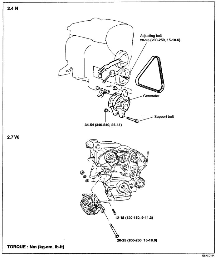

I have a 2002/2003 hyundai sonata and the battery light keeps coming on. I changed the battery and the light still hasn't gone off :?: I don't know what it could be :(

Battery light would indicate a faulty alternator. Here is how to replace it. Check out the images (below). Please let us know what happens.
