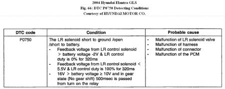

Inspection Procedures "¢ This is only a request from the TCM to turn the MIL ON. The fault code is stored in the TCM. The freeze frame data is stored in the ECM under the P1529 request code. Be sure to retrieve the freeze frame data before clearing code P1529 from the ECM. "¢ Check the transaxle system. That means you need to rectify P0750. DTC P0750: Low & Reverse Solenoid Valve Open Or Shorted Description The LR annulus gear and overdrive planetary carrier are locked to the LR brake when the LR solenoid operation. The LR solenoid is operated at the transaxle range switch "P", "R", "N" and 1st gear. DTC Detecting Condition
https://images.2carpros.com/forum/automotive_pictures/192750_P0750Elantra04Fig66_1.jpg

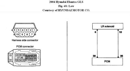

Schematic Diagram
https://images.2carpros.com/forum/automotive_pictures/192750_P0750Elantra04Fig68_1.jpg

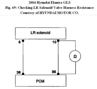

Inspection Procedures 1. Check The DTC Of The LR Solenoid Valve 1. Connect Hi-Scan (pro) to data link connector. 2. Turn the ignition switch ON and monitor the DTC. Is the DTC P0750 the output? Yes: Go to next step. No: Problem is intermittent or was repaired and engine control module memory was not cleared. 2. Check The ATF System 1. Check the automatic transmission fluid level. Is the ATF level normal? Yes: Go to next step. No: Add or replace as necessary. 3. Check The LR Solenoid Valve Connector 1. Turn the ignition switch OFF and disconnect the solenoid valve connector. 2. Check that the solenoid valve connector for loose, poor connection, bent, corrosion, contamination, deterioration, or damage. 3. Is the solenoid valve connector normal? Yes: Go to next step. No: Repair or replace as necessary. 4. Check The LR Solenoid Valve Harness 1. Turn the ignition switch OFF and disconnect the solenoid valve connector and PCM connector. 2. Measure resistance between the solenoid valve connector terminal 6 and the PCM harness connector terminal 38. 3. Measure resistance between the solenoid valve connector terminal 10 and the PCM harness connector terminal 36.
https://images.2carpros.com/forum/automotive_pictures/192750_P0750Elantra04Fig69_1.jpg
"¢ Specifications: below 1ohm Is the LR solenoid valve harness normal? Yes: Go to next step. No: Repair or replace as necessary. 5. Replace The LR Solenoid Valve "¢ Use the Hi-Scan Pro to delete P0750 from memory in the PCM. "¢ Test drive the vehicle for two key-on the key-off driving cycles. Does P0750 reset? Yes: Go to next step. No: Return the vehicle to the customer. 6. Replace The PCM 1. Disconnect the battery (-) terminal and disconnect the PCM connector. 2. Replace the PCM.

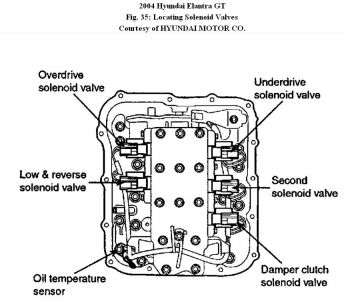

Do you know where i can buy the Low and Revese Solenoid becuase the Hyundai department where i live has no clue what i am talking about.
Jul 9, 2020 at 5:16 AM (Merged)
KHLOW2008
  • 41,814 POSTS
If you had not performed the testings, do so. The solenoids might not be faulty as the problem is intermittent. Quite often such problems are caused by wiring connection fault. The connector at the transmission tends to collect water and over time, oxidation occurs at the connector terminals resulting in bad continuity. This would cause intermittent failure. Show the guys at Hyundai the following diagram.
https://images.2carpros.com/forum/automotive_pictures/192750_Solenoids04elantrsFig35_1.jpg

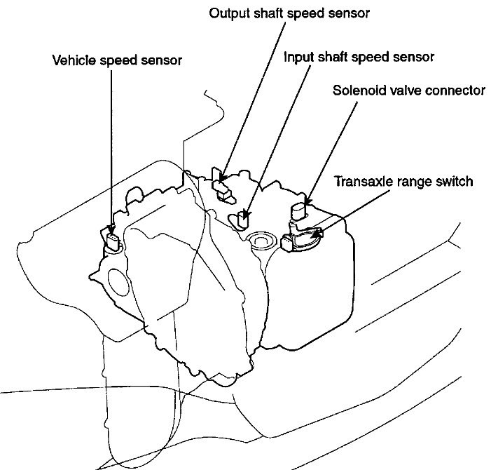

could you help me to find where are the solenoid valve and the PCM connectors located in the Hyundai elantra 2004 2.0L?
The problem (that you explained about it above) occurred with my car,and i think the reason is the water collected in the connectors.
now the problem became bigger, when i put the Automatic gear on the D position,there is no response and car deosnt move( as N position) in addition to the check engine leds is on all the time.
kindly waiting for your reply.
thank you.
