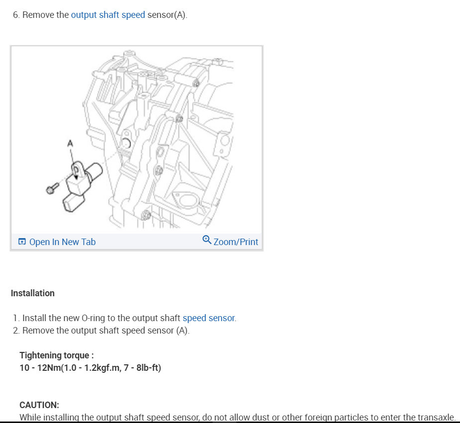

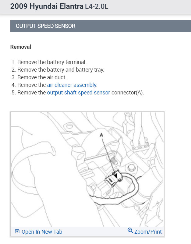

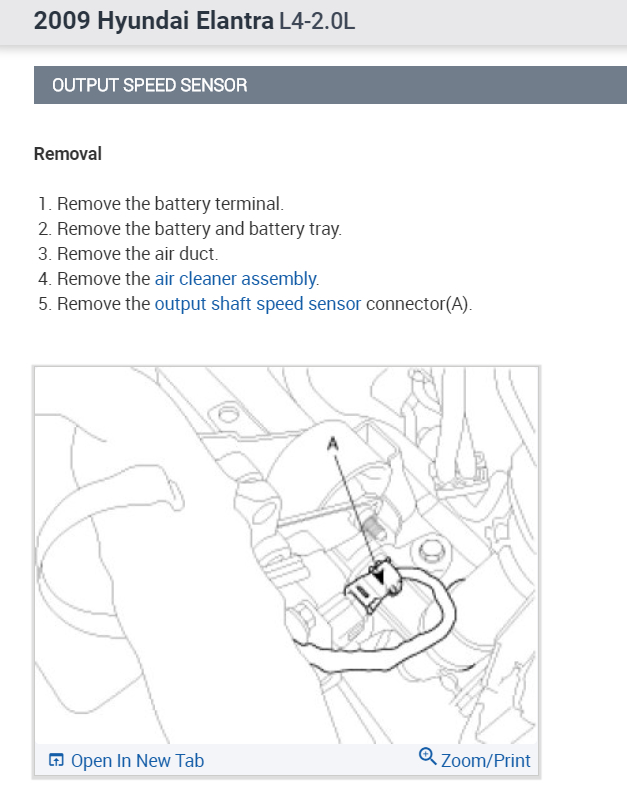

i have Elantra auto transmission car.the gear not changes and speedometer is silent.please answer me for solve the problems
Apr 8, 2010 at 9:17 AM
  • 110,244 POSTS
It sounds like the vehicle speed sensor (VSS) is bad here is the location so you can change it out. Check out the diagrams (Below). Please let us know what you find. We are interested to see what it is.

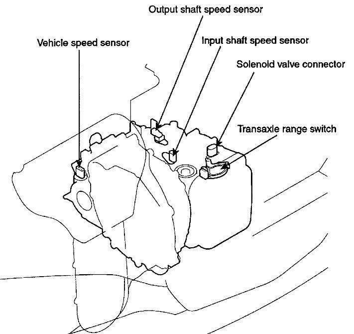

JOSE M. DIAZ CINTRON
Thanks, the oil level is fine. I believe the problem is one of the sensor. I will like to see a diagram of this sensors.
Jul 9, 2020 at 5:15 AM (Merged)
HMAC300
  • 48,601 POSTS
they are on sides of trans and some inside trans see pic

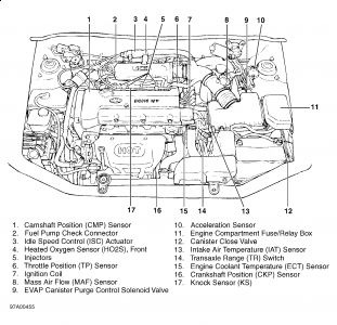

MATTSTERCRAFT
  • 10 POSTS
And where would that be and how do I check/test it?
DAVE H
  • 13,384 POSTS
Hey, sorrynot replied sooner .. work commitment's ! The tps is located on throttle body .. check the wiring is good .. remove it from throttle body and check it is not binding up/sticking .. clean it or replace it if necassary ! (#8 in picture)
https://images.2carpros.com/forum/automotive_pictures/266999_hyu_1.jpg
