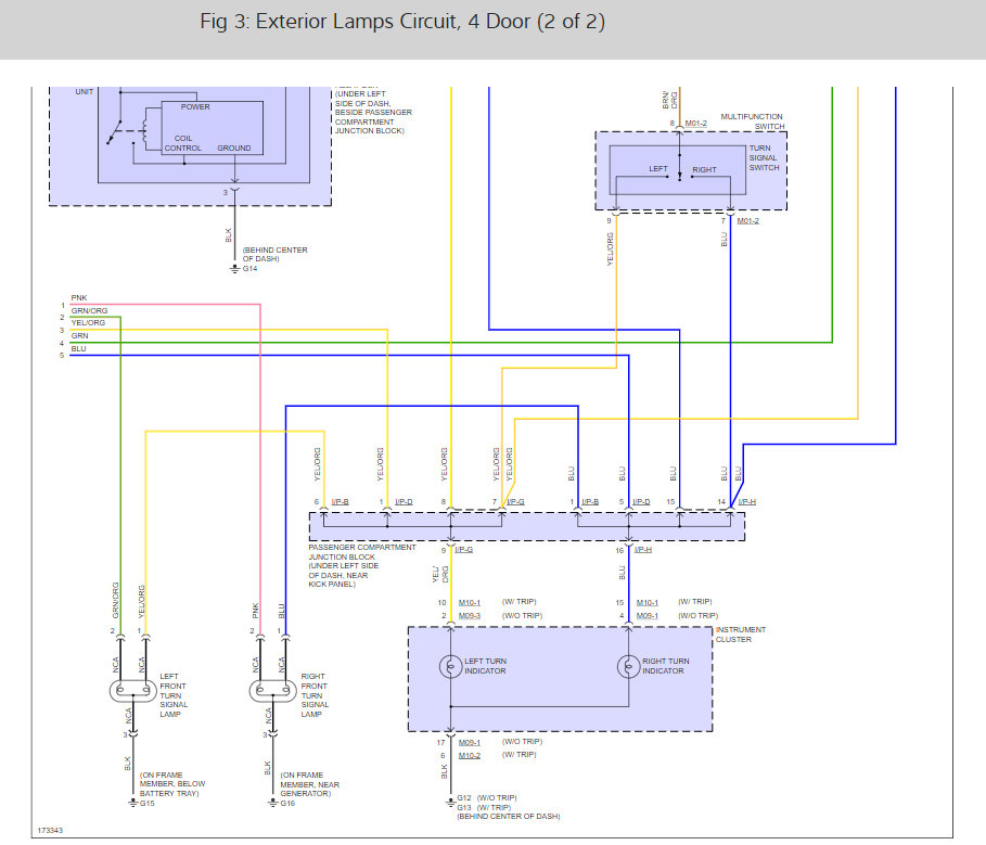

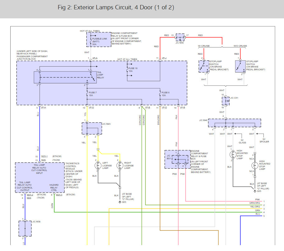

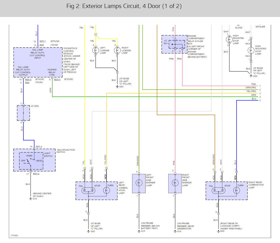

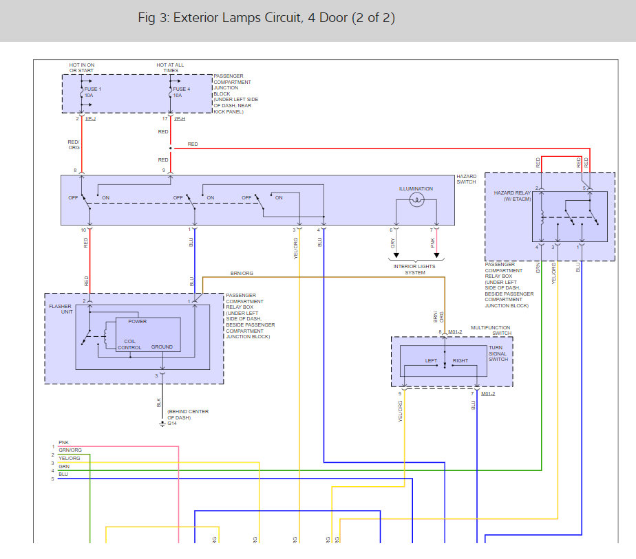

Hi leslieannmarcobrewster,
It sounds like you have a hazard switch or flasher that is out but to be sure here is a guide to help us test the power and grounds and the brake light wiring diagrams to help you do the tests.
Aug 1, 2010 at 10:17 AM
ZANYJB
I did some checking and I had a bad hazard switch

BUBBADAM
Stop Everything! there was recalls on the newer types of of these cars and the problem still exists back then, before replacing the Brake Switch First is to check if your Brake Light Switch Stopper is not missing evidence of Broken rubber or plastic on the drivers floor is a indication. this is a very common problem with these types of cars and I'm not only saying Hyundai but also honda and other models has also same problem.
on the 2004 Hyundai Elantra The stopper is located on the Brake Pedal arm and if its missing the brake light switch will not turn off because the Plunger will go through the hole where the stopper was and not turn the switch off.
A quick fix is double sided tape and a penny but better to fix it properly get a new stopper and replace it than risking your life.
