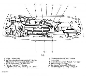

Where is the crankshaft position sensor
2002 HYUNDAI ACCENT
AHANSON45
Four cylinder front wheel drive automatic 118,000 miles.
I have looked everywhere on the internet, and I tried looking for a Chilton's on this car but I cannot find somewhere to show me where the crankshaft position sensor is.
I drove 2,300 miles on it in three days and it worked fine until a day later when I tried starting it. I had a little trouble starting it, but it started up nonetheless, then as I was backing up it just shut off. Then it would not start. It would crank and sound like it is about to start, but it just does not. I checked for a spark and there was none.
I know it could be a number of things. But i want to check the crankshaft position sensor but cannot find it. Thanks for your help.
Aug 23, 2010 at 2:27 PM
DOCFIXIT
  • 18,828 POSTS
On left side engine near exhaust. See diagrams.
https://images.2carpros.com/forum/automotive_pictures/198357_Graphic_579.jpg
https://images.2carpros.com/forum/automotive_pictures/198357_Grafic_3_141.jpg
Aug 23, 2010 at 2:32 PM
AHANSON45
thanks, i was able to locate it, but unfortunately, that was not the problem. but the camshaft sensor looks pretty fried.

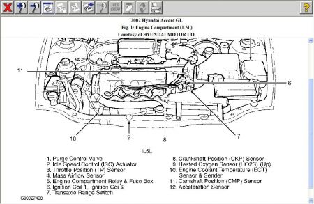

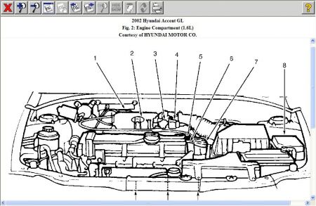

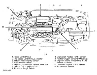

Hi! I need to replace (or actually have my "male" friend replace) my crankshaft sensor in my car. I need to know the exact location of it for him and be able to verbally direct him to it over the phone!
I would greatly appreciate any help and if a diagram could possibly be included (or you can lead me to one) that would be awesome!
Thank you so much, Danette : )
Jan 10, 2017 at 12:21 PM (Merged)
  • 75,992 POSTS
1.5L.
https://images.2carpros.com/forum/automotive_pictures/12900_1_3.jpg
1.6L is on item number 6.
https://images.2carpros.com/forum/automotive_pictures/12900_16_1.jpg

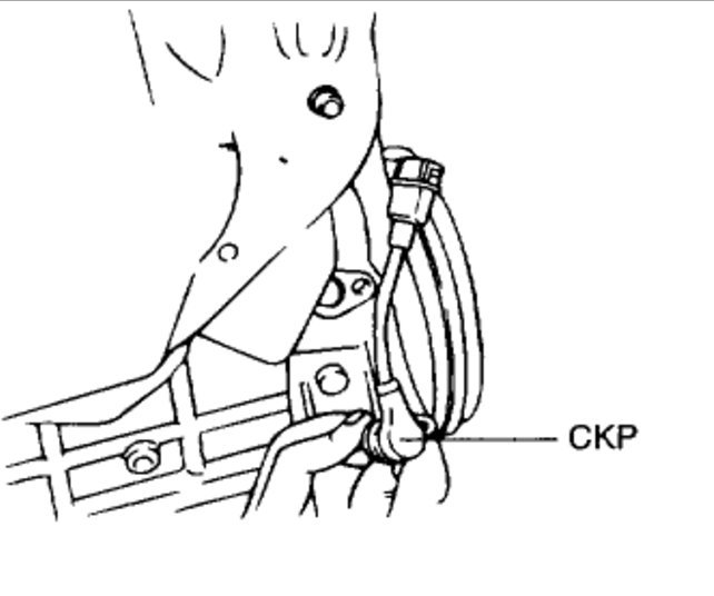

Where is the crank shaft position censor located on my car?
RANDICO
  • 174 POSTS
The CKP is located on the left side of engine block ,near the flywheel,
  • 54,878 POSTS
The sensor is located near the front of the engine down low, here is a guide that will give you an idea of what you are in for when changing the sensor with e diagram (below) of where it is on your car.
