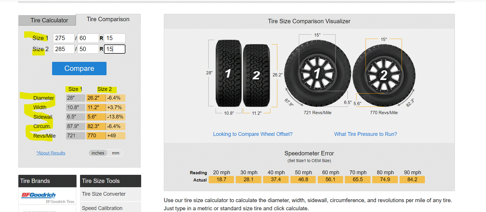

gentlemen. i have the van listed above e150 van w/460 police interceptor, about 550hp. i would like to know about how wide of tires and rims i can go. Right now, i have 255x60x15" and rear 275x60x15" tires. i would like to go even wider than i have right now. Can you suggest what i can go without any interference?

Hi Mark, how much room is there before there is any interference between the tires and body?
Here is what I suggest: What to do is first determine how much space there is. Then, go to this site:
https://tiresize.com/calculator/
Once there, type in the tires you presently have on the vehicle. It will provide the dimensions of the tire you have. Knowing the additional clearance, just work your way up in size to see how much wider the tire gets.
If you look below, I provided an example. I went up one size.
See pic below. Note: A different size diameter tire will change the speedometer reading.

Hello Joe. Thank you very much for the information. It was very helpful in making a decision on what size to use to check my clearance. i appreciate your help once again.
