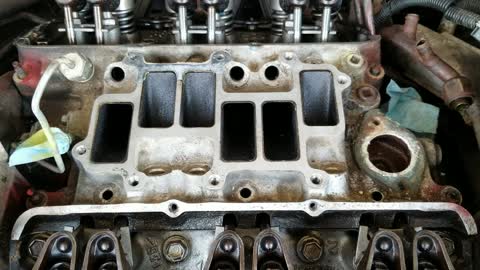

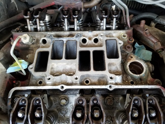

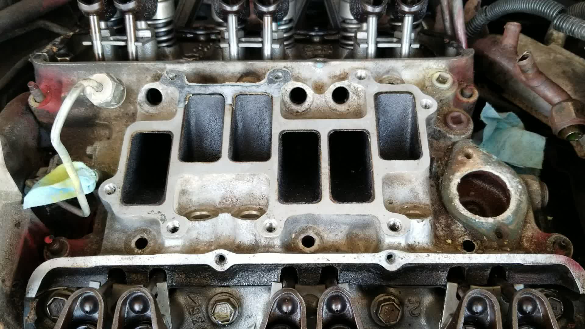

After removing all bolts and I cannot get the intake to release. how do I do this?

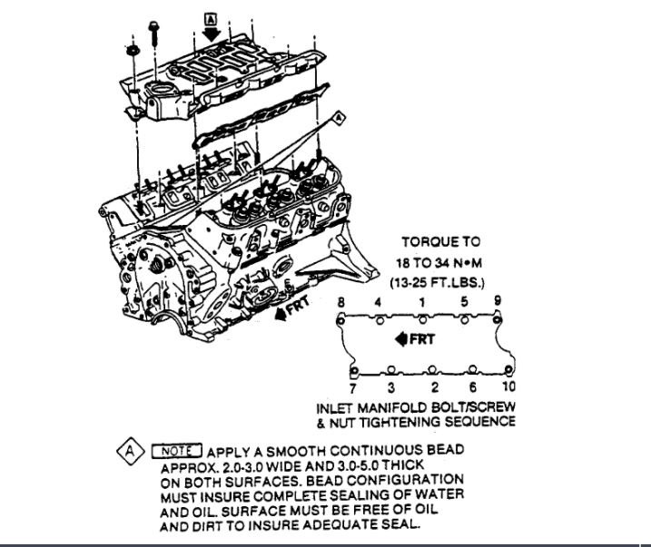

I attached a picture and procedure for you to view.
If you could post a picture of what you see, that will help me.
REMOVE OR DISCONNECT
1. Battery ground cable
2. Accelerator and T.V. cable bracket at the plenum
3. Throttle body at the plenum
4. EGR pipe at the EGR valve
5. Plenum
6. Fuel inlet and return pipes at the fuel rail
7. Serpentine belt
8. Power steering pump mounting bracket
9. Heater coolant pipe at the power steering pump bracket
10. Wires at the generator
11. Generator
12. Wires at the cold start injector
13. Cold start injector at the intake manifold
14. Idle air vacuum hose at the throttle body
15. Wires at the injectors
16. Fuel rail
17. Breather tube
18. Runners
19. Coil wires at the bracket
20. Both rocker arm covers
21. Drain the c9oling system.
22. Radiator hose at the thermostat outlet
23. Heater coolant pipe at the thermostat housing
24. Wires at the thermostat housing
25. Ignition distributor
26. Thermostat housing
27. Intake manifold bolts
28. Intake manifold

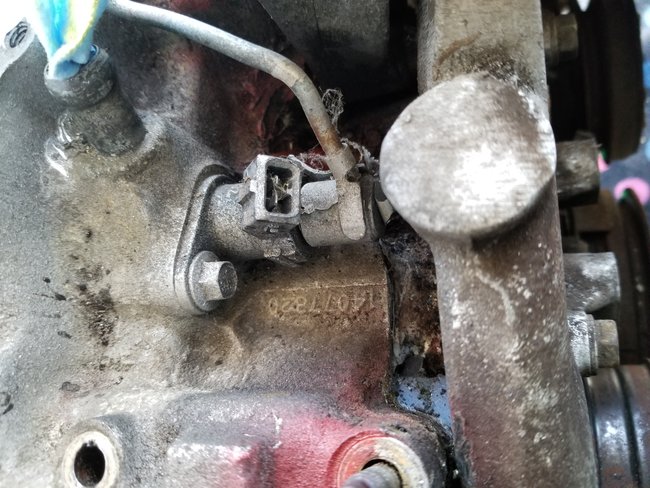

Thanks for your help and the picture. On the pictures I sent the third one does that piece need to come off before I start prying on that side? Thanks so much.
Apr 29, 2018 at 12:14 AM
Sorry for the delay, I was traveling today.
You are good. The gaskets are holding it especially around the studs. Be gentle prying it loose.
