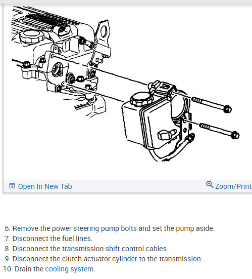

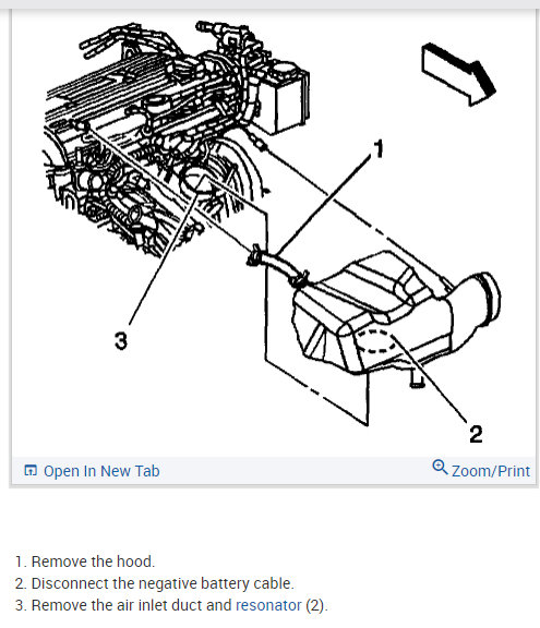

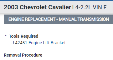

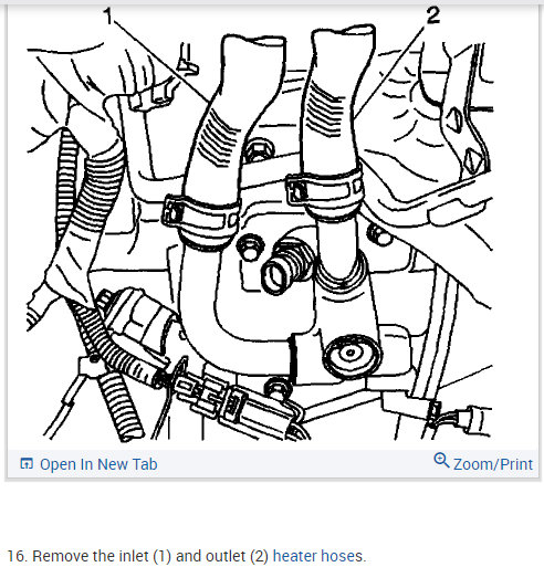

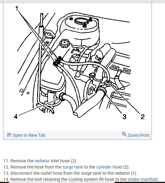

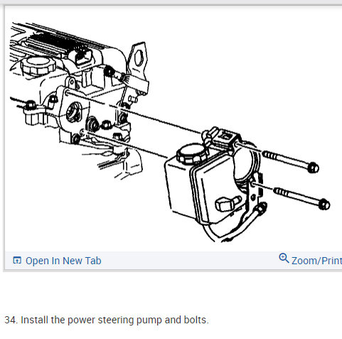

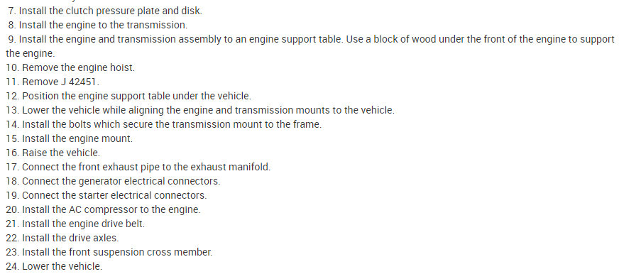

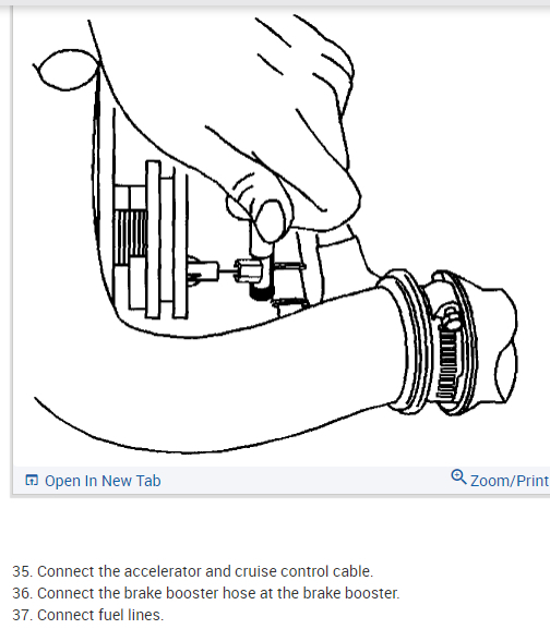

Engine replacement instructions please?
2003 CHEVROLET CAVALIER
233,000 MILES • 4 CYL • FWD • MANUAL
JMILWOOD

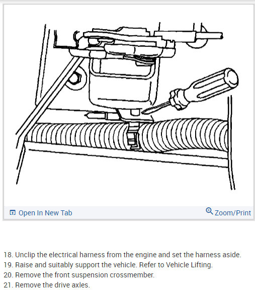

please get me heading in the right direction. thank you
Apr 10, 2010 at 10:14 AM
DANNY L
  • 5,648 POSTS

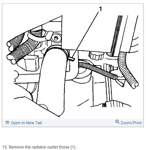

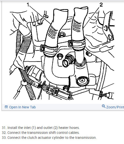

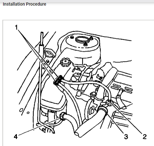

Hello, I'm Danny.

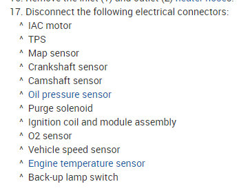

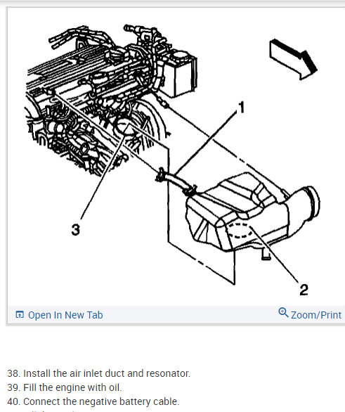

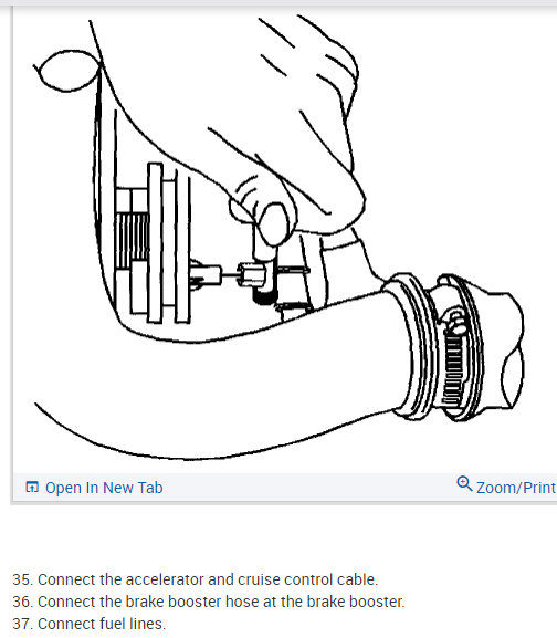

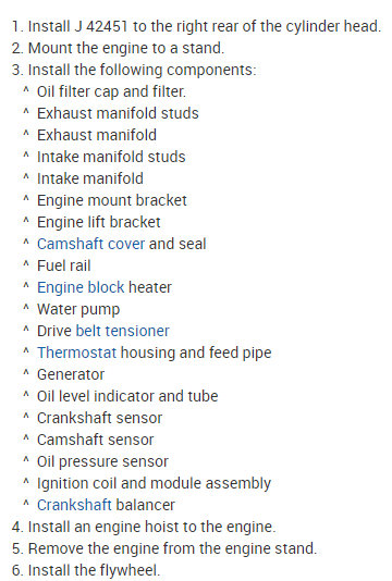

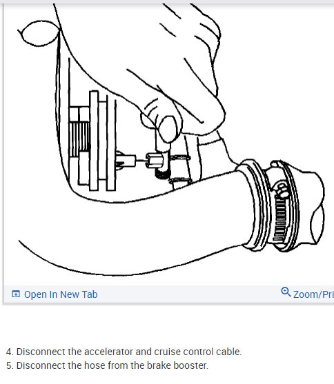

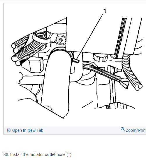

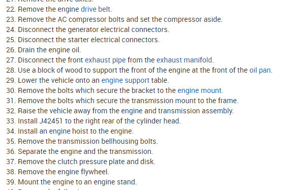

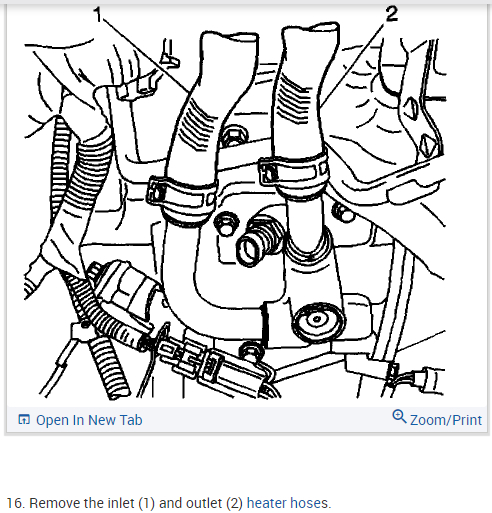

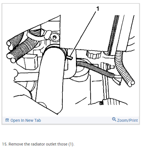

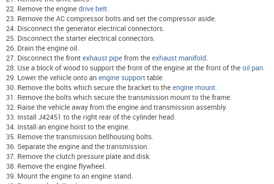

Here is the information you requested on engine removal and replacement. I've attached picture steps below showing instructions for engine replacement on your car. Hope this helps and thanks for using 2CarPros.
