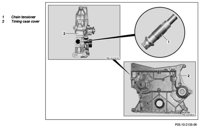

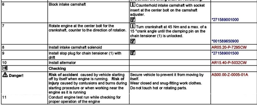

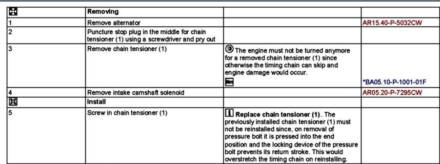

Here are the directions for the chain tensioner:
2013 Mercedes Benz C 250 Sedan (204.047) L4-1.8L Turbo (271.860)
AR05.10-P-7800EVO Remove/Install Chain Tensioner
Vehicle Engine, Cooling and Exhaust Engine Timing Components Timing Chain Tensioner Service and Repair Removal and Replacement AR05.10-P-7800EVO Remove/Install Chain Tensioner
AR05.10-P-7800EVO REMOVE/INSTALL CHAIN TENSIONER
Engines 271.8 in Model 172, 204, 207, 212
All directions are in the attached pictures. Let me know if this helps.

I knew it, stupid Benz placing it under the alternator. Thanks sir.

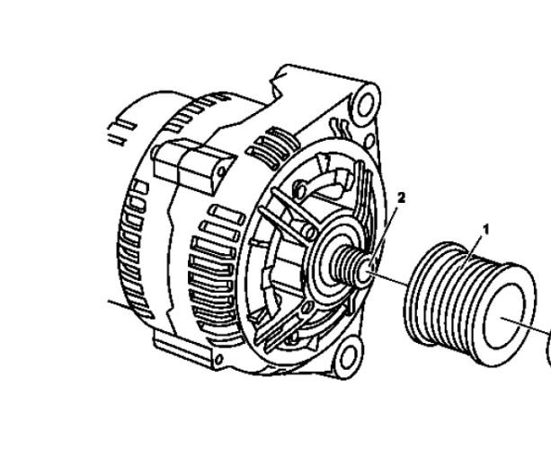

Any way for you to access some resources to find out how many bolts hold the alternator in place?
Sep 4, 2019 at 10:52 PM
NASER NASER
  • 836 POSTS

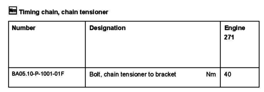

I got it, just need the new phasers torque spec and tensioner as well.
Sep 5, 2019 at 12:44 AM
  • 110,240 POSTS
Welcome back:

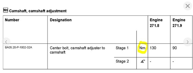

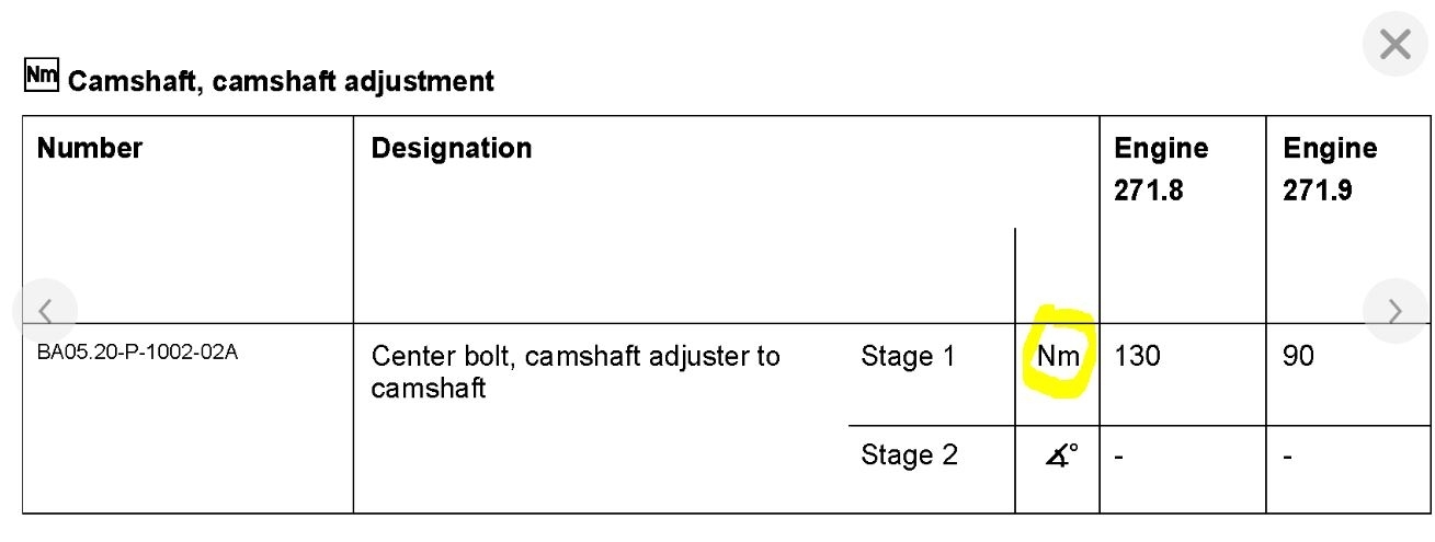

I attached a picture of the alternator. It shows two. See picture 1. Also, picture 2 is what I believe you are looking for as far as torque.
Sep 5, 2019 at 12:21 PM
NASER NASER
  • 836 POSTS
How do i know if what i have is engine 271.8 or 271.9? as the torque specs you provided clearly show there are two different ones. Thanks
Sep 8, 2019 at 1:03 AM
  • 110,240 POSTS
Welcome back:
From research, you should have the 271.8. This model had a turbo charger whereas the 271.9 had a supercharger.
Sep 8, 2019 at 11:33 AM
NASER NASER
  • 836 POSTS
Excellent, i thought so but drove me crazy the information was so vague. thanks for your help!

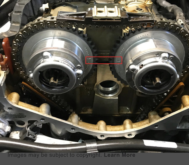

having a problem with the camshafts, not able to place both phasers, when i put one on and put the chain on top of it and about to put the second the chain is too short to be able to let the phaser go on the camshaft, and even with the camshaft holder, they camshaft moves a little, and am not able to turn the camshaft to light up 100% with the phaser, i may end up just removing the whole chain and replacing it, is it easier if the whole chain replaced as well as the guides to give more room for the chain to be placed?
Sep 11, 2019 at 11:20 PM
NASER NASER
  • 836 POSTS
if i could find the right camshaft wrench which i can turn the camshaft just a bit i could do it, but can't find any size that fits exactly behind the sprocket.
Sep 11, 2019 at 11:28 PM
  • 110,240 POSTS
Welcome back:

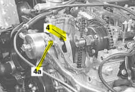

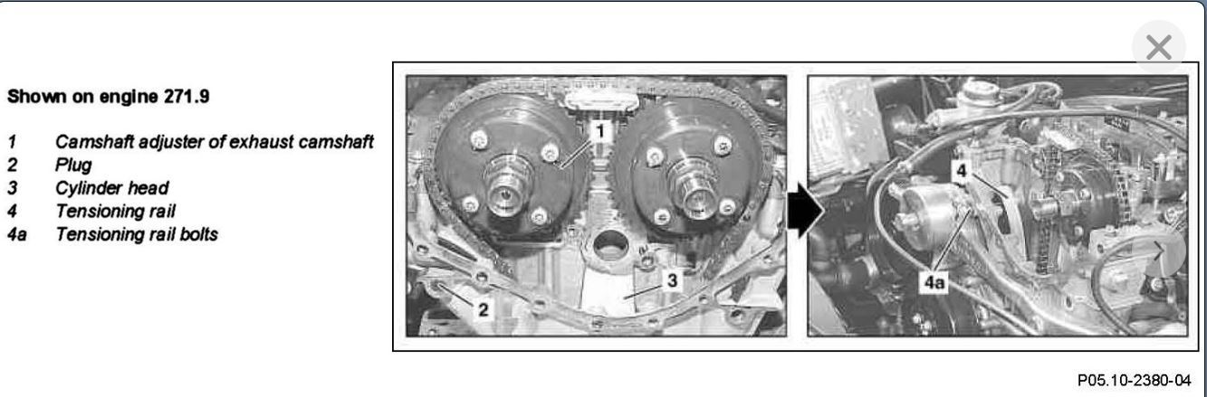

You need to release tension from the chain. Have you removed the tensioning rail? See pic 1
Sep 12, 2019 at 10:58 AM
NASER NASER
  • 836 POSTS
If you mean number 4 in the picture then yes, the plastic piece, i removed it.

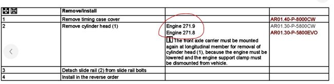

how are these chain guards removed, by removing the lower cover? :[
How can i ensure that both cams when lined up with the arrow that they are not 180 degrees off, is that possible here? they moved a bit when the chain jumped while i was turning the crank, but i put the T0 when i began the job.
Sep 13, 2019 at 2:49 AM

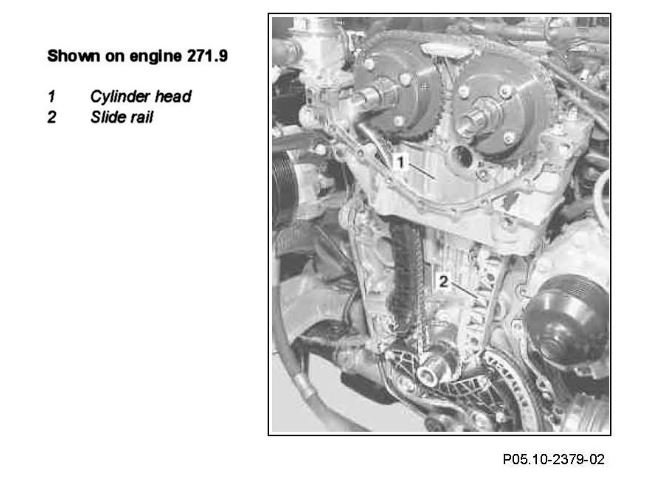

  • 110,240 POSTS
Welcome back:
I attached two pictures below. Identify which one you are trying to remove. I hope it's the second because the first requires cylinder head removal.
Sep 13, 2019 at 11:13 AM
NASER NASER
  • 836 POSTS
I don't see the difference, these are for the 271.9 engines which are supercharged, mine is the 1.8l turbo 271.8.
Sep 13, 2019 at 11:18 AM
NASER NASER
  • 836 POSTS
Ya, neither are for my car because i see the chain on both pictures go over rather than under the plastic piece.
Sep 13, 2019 at 11:19 AM

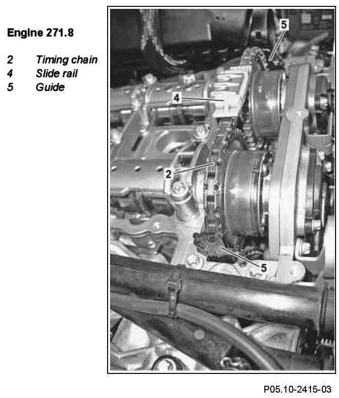

Mine looks something like this.
Sep 13, 2019 at 11:20 AM
  • 110,240 POSTS
This is the 1.8T, correct? Also, is it a sedan, coupe, and are you located in the US?
Sep 13, 2019 at 11:27 AM
NASER NASER
  • 836 POSTS
Mine is 1.8 turbo 271.8 motor, pictures i think are for the 271.9 as it says in the picture, sedan, yes in the U.S.
Sep 13, 2019 at 11:29 AM
  • 110,240 POSTS
I attached a pic below. Interestingly, I select the correct engine as seen below, but when I try to pull up guides and slide rail info, it takes me to the 271.9
Just to confirm, do I now have the correct pic attached? Also, I have to do a bit more research to find the directions. For some reason, it is jumping between engine designs for me.
Also, take a look at pic 2 for slide rail removal for either engine.
Sep 13, 2019 at 11:45 AM

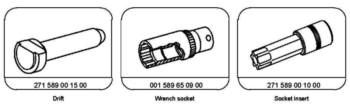

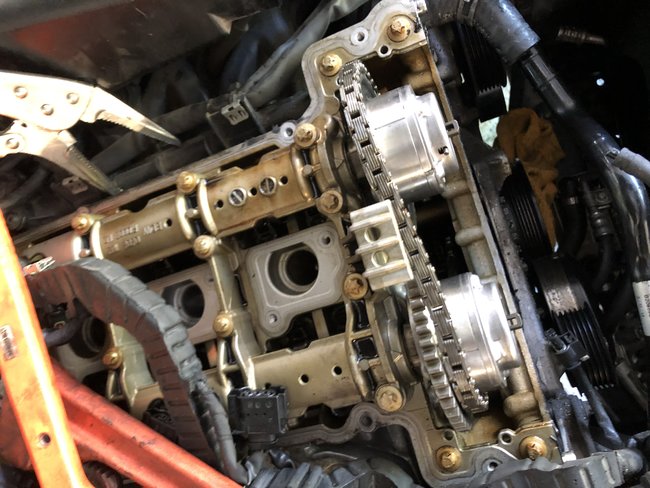

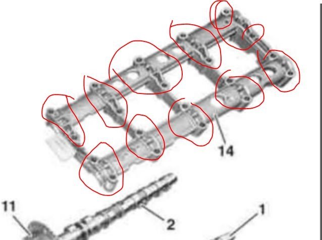

Do you know if i remove the star bolts on top of the camshafts will that result in the camshaft coming out? I want to remove the top cover so i can put a wrench on the camshaft to rotate them a bit to align, this is the only way to do so.
Sep 18, 2019 at 12:32 AM
  • 110,240 POSTS
Welcome back and sorry for the delay.
Yes, those bolts how the upper portion of the camshaft housing. I attached a pic below. All bolts locations will need removed.
Sep 19, 2019 at 11:37 AM
NASER NASER
  • 836 POSTS
What am asking is, if i remove them will the camshaft be loose, i just want to remove the cover so i can put a wrench and rotate the camshaft back to the mark.
Sep 19, 2019 at 8:08 PM
  • 110,240 POSTS
Yes, they will be loose. You should be able to turn them without removing the cover.
Sep 20, 2019 at 2:37 PM

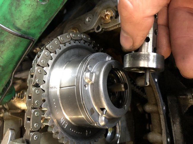

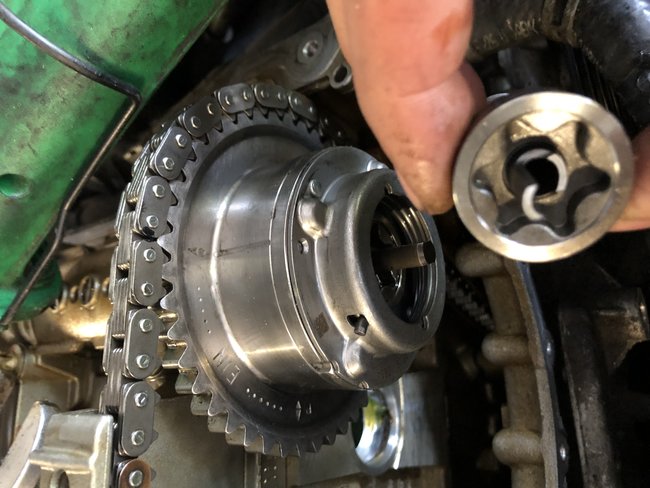

Finally got them all to line up, with regards to the star bolt in the picture which holds each sprocket to the head, there is a plastic piece in front if the bolt that is fragile i broke one and bought another whole bolt to replace it and while installing the other it also partially broke, do you know if those are important? See pictures with both the good one and the broken one, all i know is that the camshaft magnet sensor goes in front of the bolt after installing the timing chain cover, also once all in place and i want to turn the motor by hand to see how it is do i need to install the tensioner first?
Sep 26, 2019 at 11:29 PM
  • 55,214 POSTS
Yes these parts need to be replaced. the system will not work unless you do and you must have the tensioner on before rotating the engine over.
