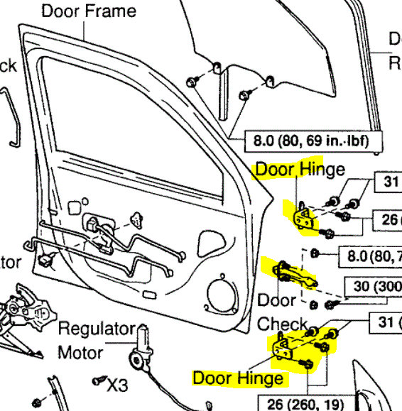

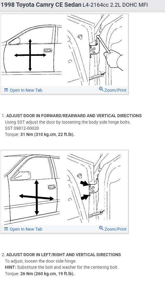

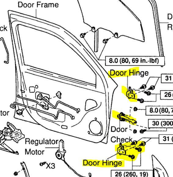

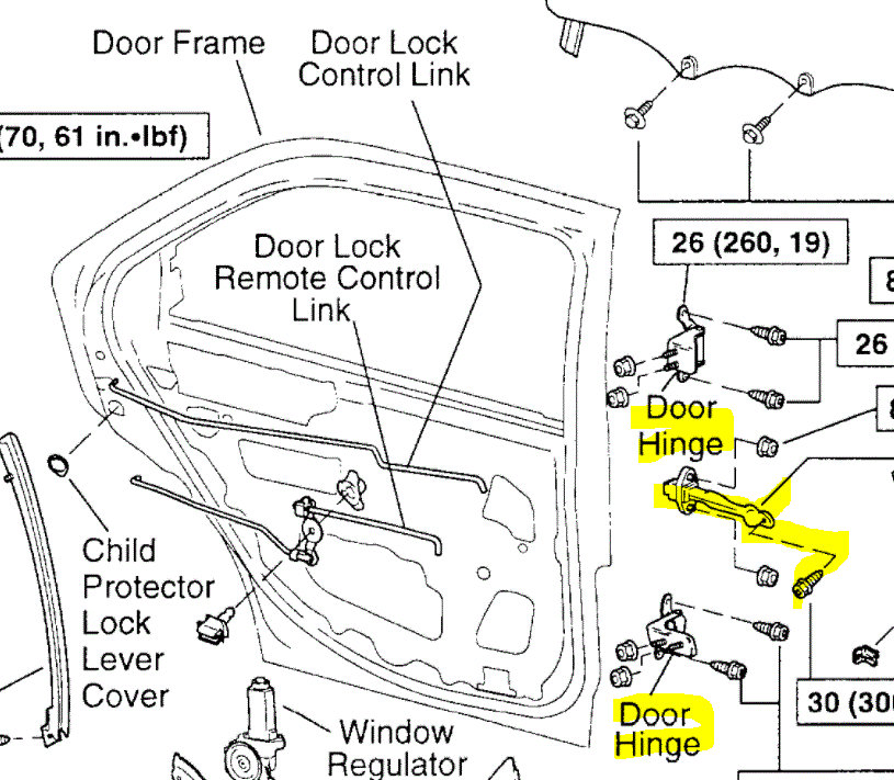

I went through my manuals are there aren't specific directions for door removal, but I'll try my best to help.
First, the doors are held on the body of the vehicle by hinges. There are two bolts on the hinge to the body, and two on the hinge to the door. Additionally, there is a door check that is what holds the door in the open position.
To remove any of the doors, you need to first determine if the replacement doors already have hinges on them or not. If they do, remove the hinge to body bolts. If they don't, remove the hinge to door bolts. Also, the door check has a screw/bolt holding it to the body that needs to be removed. If you are getting used doors, the check will likely still be attached.
Install is the reverse of removal. I will recommend having a helper hold the door when you remove or replace them. They are somewhat heavy and will fall off once the bolts are removed.
See pics below. Pic 1 is front door. Pic 2 shows the rear door. I highlighted the bolts involved.
