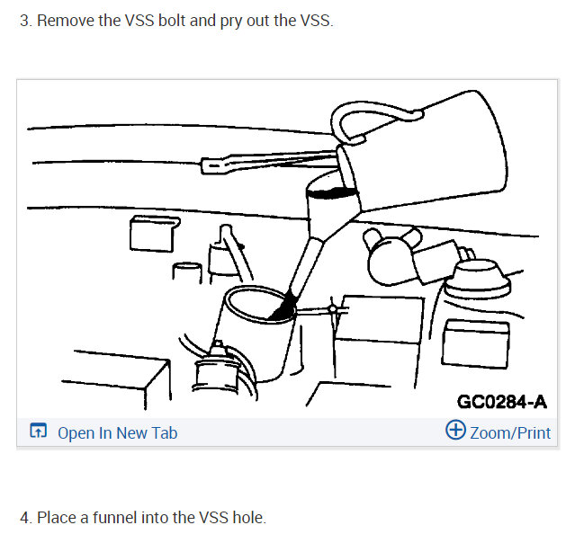

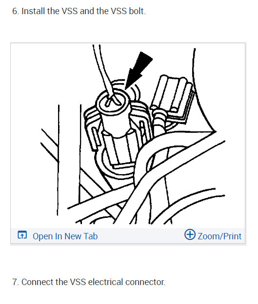

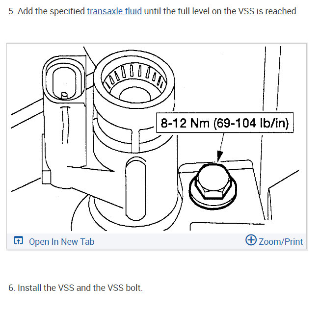

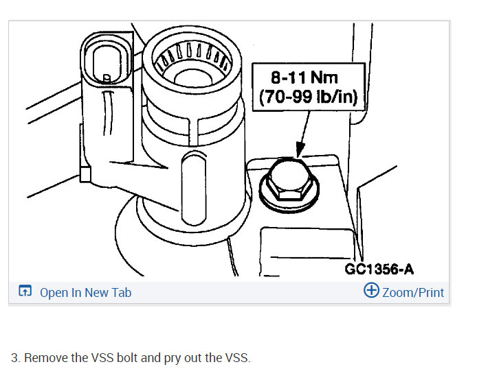

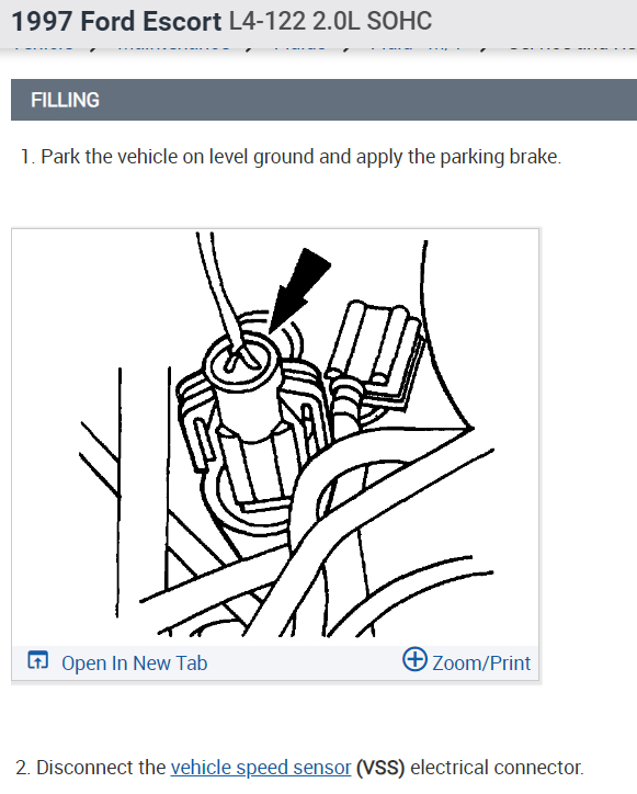

how to add manual transmission fluid?
Dec 22, 2023 at 12:54 AM
  • 55,224 POSTS

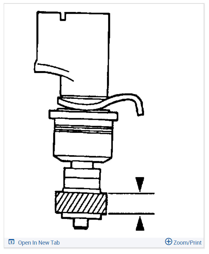

Yep, they hide it, you must remove the VSS sensor for the speedometer. they use the gear on the engine of the sensor to act as the fluid level check point. Here are the instructions on how to do the job. Check out the images (below). Let us know if you need anything else.
