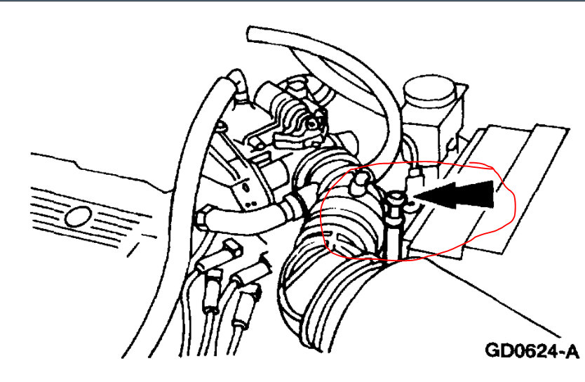

I just need to know the location of the transmission oil dipstick on my Escort ZX2. If you could please help me out I would appreciate it.
Thank you

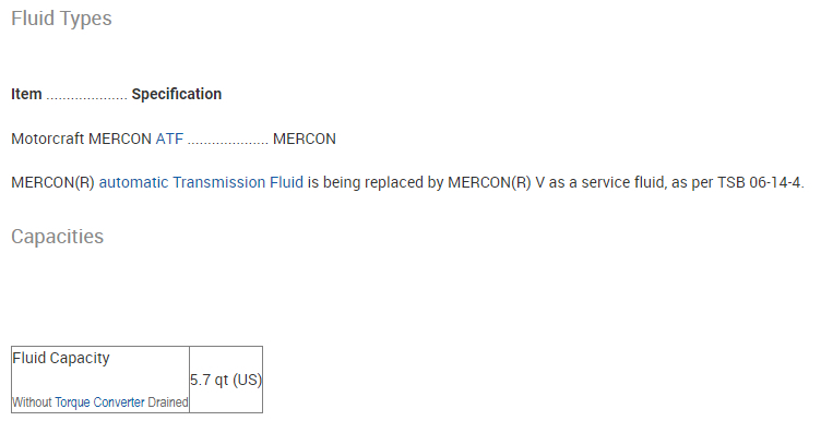

Hello, I'm Danny.
Here is the information you requested. I've attached a few pictures below showing the transmission dipstick location and the transmission fluid specifications for your Escort. Hope this helps and thanks for using 2CarPros.
