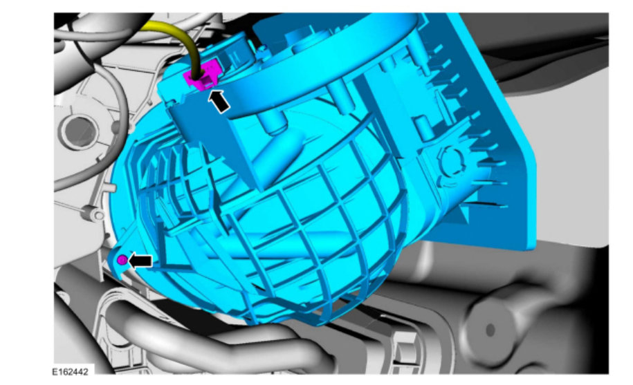

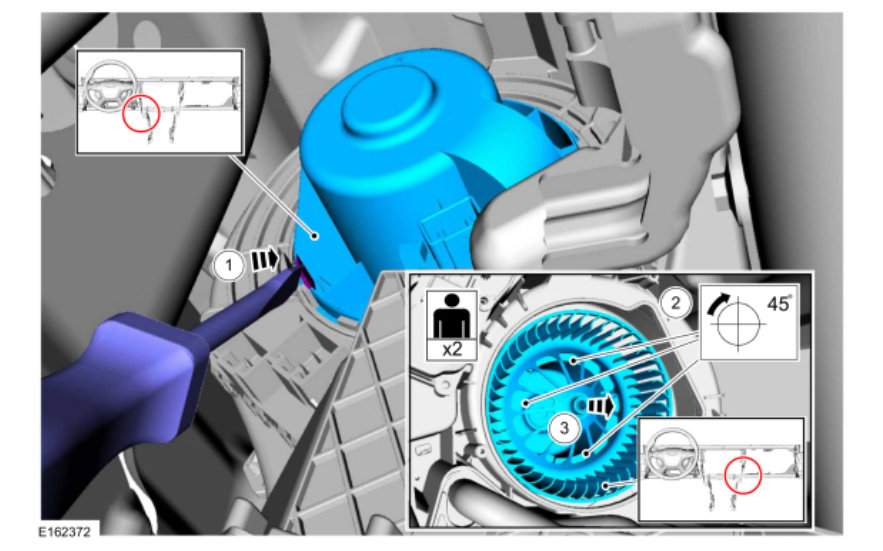

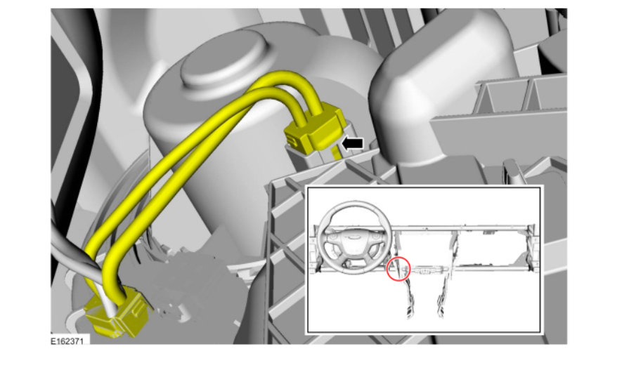

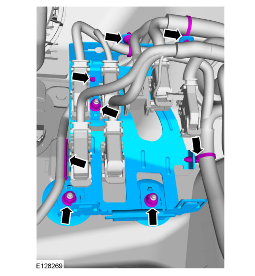

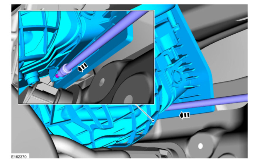

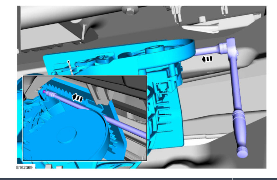

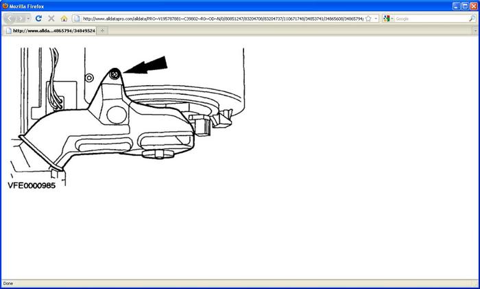

My blower motor is making a loud noise that I know is from a rodent's nest insider because this same thing happened a couple weeks ago. I need to clean in out myself this time as I don't have $190.00 every couple weeks to keep having the mechanic do it. Can you tell me where to access the blower on this car?
Nov 15, 2019 at 8:56 PM
Good morning,
I attached the procedure for you along with the pictures of the components that need to be removed.
Removal
NOTE: Removal steps in this procedure may contain installation details.
Remove the BCM .
Refer to: Body Control Module (BCM) (419-10 Multifunction Electronic Modules) .
Remove the BCM retainers and BCM bracket.
Torque : 133 lb.in (15 Nm)
NOTE: To aid in the installation of the torx screw, a mirror and a magnetic socket may be necessary.
Disconnect the air inlet door actuator electrical connector, and remove the front air inlet duct retainer.
Install the ratchet, extension and socket as shown. Remove the upper air inlet duct retainer.
Install the ratchet, extension and socket as shown. Remove the lower air inlet duct retainer and the air inlet duct.
Release the retaining clip holding the blower motor while an assistant from the passenger side compartment reaches through the blower motor cage and turns the blower motor housing 45 degrees clockwise to release and remove the blower motor.

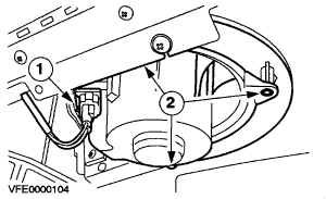

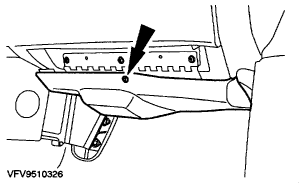

SEEKER
The fan on a 2001 Ford, Focus does not work at any speed. I know it's behind the glove compartment, but how do I take the fan out, so I can replace it? Do I flip the glove compartment down and remove the fan that way, or is it done from underneath the dash board? Do I have to dis-assemble part of the dash board?
Jan 14, 2021 at 12:49 AM (Merged)
SATURNTECH9
  • 30,869 POSTS
If you don't know where it is how do you know it's bad?You need to see if the motor is getting power and ground if it is then you have a bad motor.If it isn't getting both power and ground then it's something else.But here is how you replace it.
REMOVAL
1. Remove the lower passenger side footwell trim.
2. Detach the floor level ventilation hose.
3. Remove the blower motor.
1. Disconnect the plug.
2. Remove the three screws.

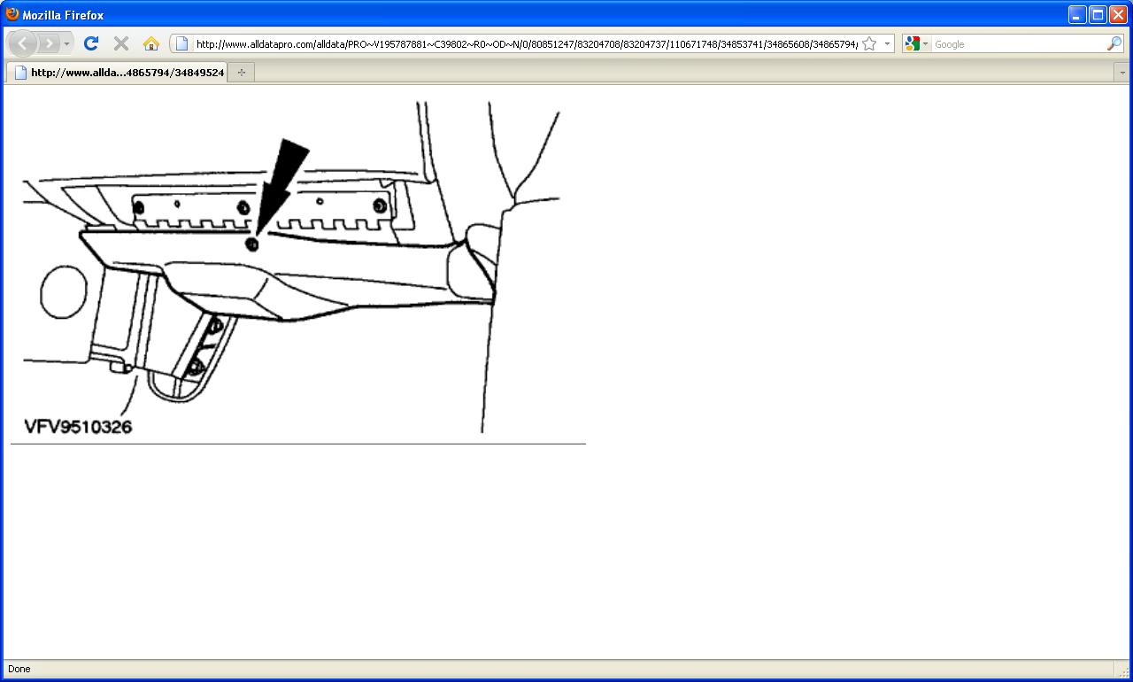

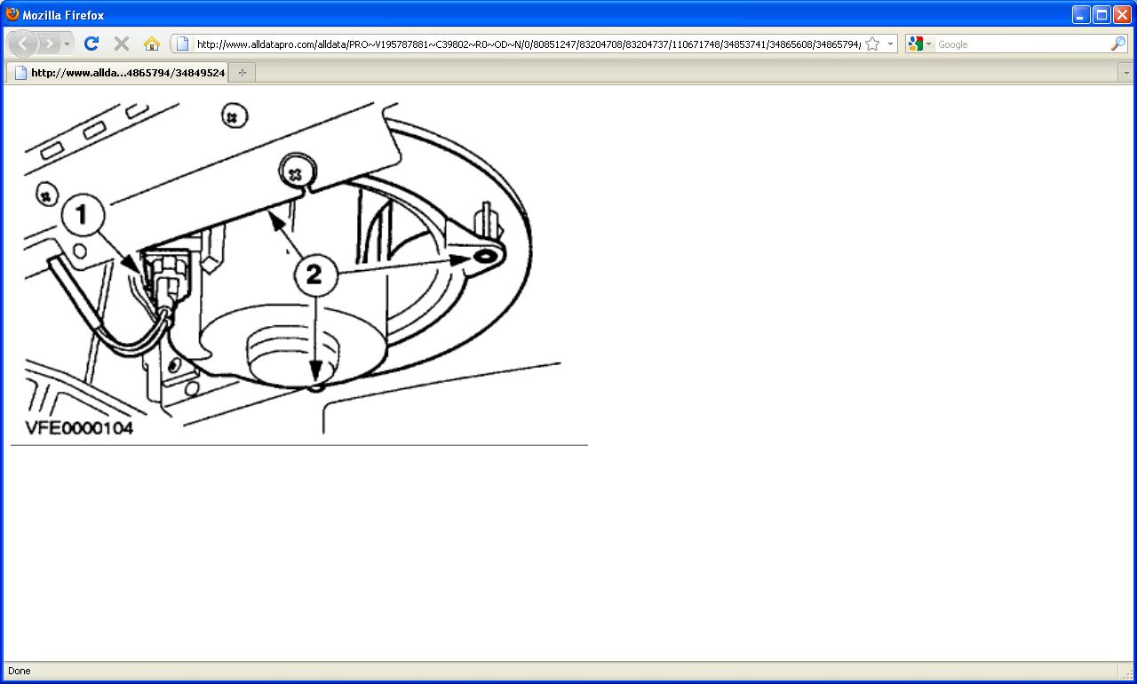

NMITCH001
I have a 2001 Focus that has always has electrical problems. I've replaced the blower resistor twice, and finally the blower itself needs replaced, along with the resistor yet again.
Jan 14, 2021 at 12:51 AM (Merged)
  • 75,988 POSTS

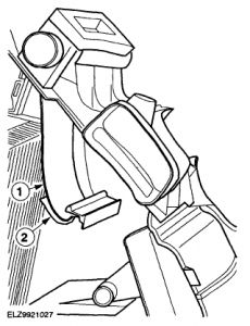

2001 Ford Focus L4-2.0L SOHC VIN P REMOVAL
https://images.2carpros.com/forum/automotive_pictures/12900_bm1_1.gif
1.Remove the lower passenger side footwell trim.
https://images.2carpros.com/forum/automotive_pictures/12900_bm2_1.gif
2.Detach the floor level ventilation hose.
https://images.2carpros.com/forum/automotive_pictures/12900_bm4_1.gif
3.Remove the blower motor. *1.Disconnect the plug. *2.Remove the three screws. INSTALLATION
https://images.2carpros.com/forum/automotive_pictures/12900_bm5_1.gif
1.Remove the middle ventilation nozzle and open the glove compartment. NOTE: *Procedure if there is a concern over whistling noises from the heating system. *Set the air distribution switch to "Head area" and the temperature control switch to "MAX cooling"
https://images.2carpros.com/forum/automotive_pictures/12900_bm6_1.gif
2.Unclip the passenger side defrost nozzle air duct and lay it down over the open glove compartment cover. NOTE: Procedure if there is a concern over whistling noises from the heating system (continued).
https://images.2carpros.com/forum/automotive_pictures/12900_bm7_1.gif
3.Remove the two-part plastic joining tang on the heater housing. *Cut the joining tang at the top end using side cutters, break it off at the bottom and discard it. NOTE: *Procedure if there is a concern over whistling noises from the heating system (continued). *Do not allow any parts of the joining tang to pass behind the fascia crash padding. 4.Cut the sealing tape into a 50x50 mm square. NOTE: Procedure if there is a concern over whistling noises from the heating system (continued).
https://images.2carpros.com/forum/automotive_pictures/12900_bm8_1.jpg
5.Feel for the gap in the heater housing, affix the sealing tape over the gap from the inside and press it firmly in place. *The sealing tape must not be applied higher than the position shown in the illustration. *1.Heater housing (shown in cross section) *2.Sealing tape NOTE: Apply the sealing tape in the position shown. WARNING: SHARP EDGES ON THE HEATER HOUSING. NOTE: Procedure if there is a concern over whistling noises from the heating system (continued). 6.Refit the components in reverse order.

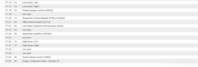

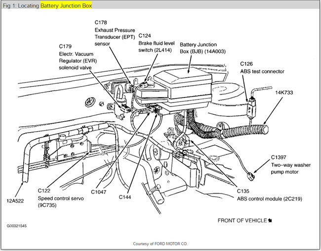

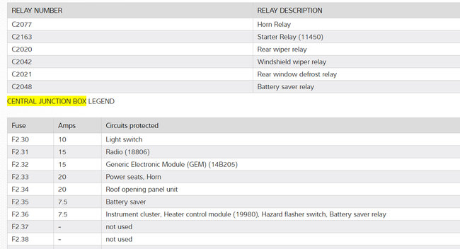

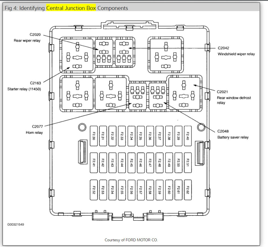

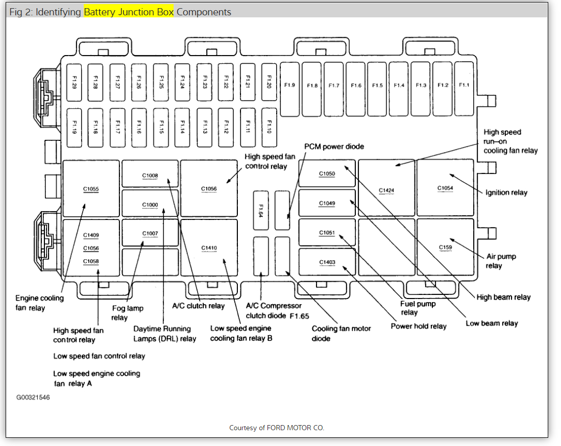

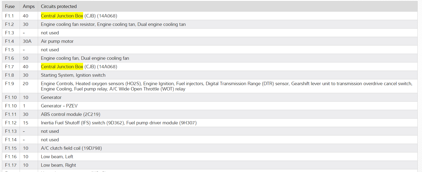

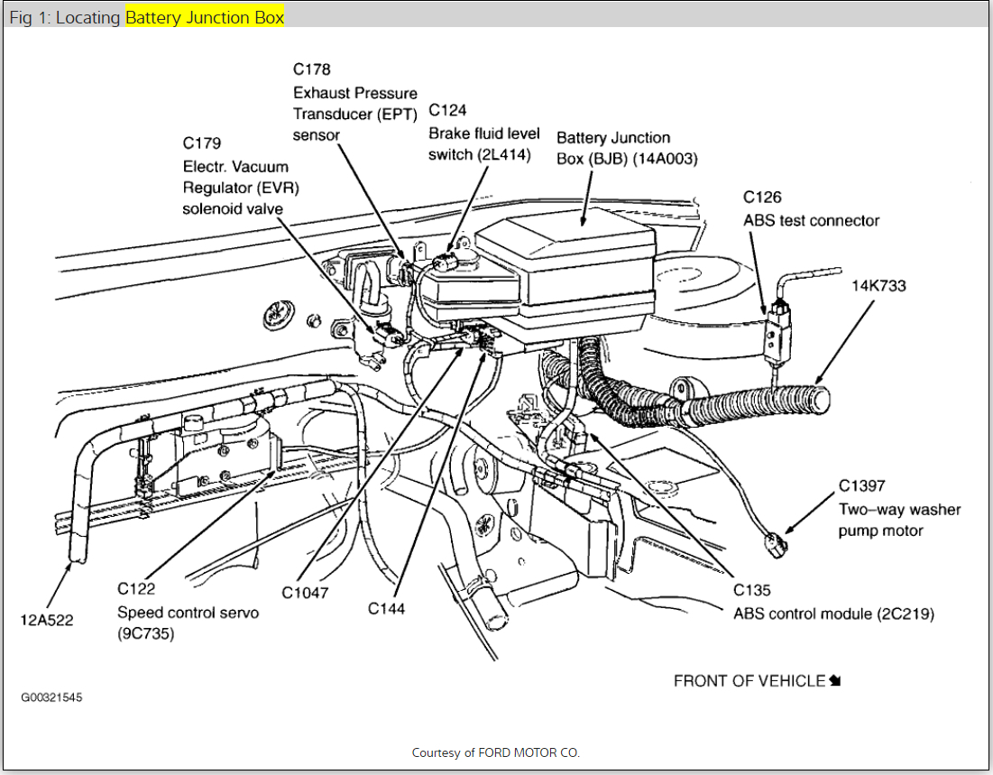

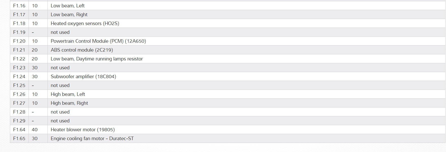

MADUKESOF3
I have no heat. When I turn the switch on... NOTHING! No noise, no air (warm or cold)... NOTHING! Have replaced the Blower, blower resistor,and Dash switch. All Fuses have been checked. Seems to concur with water leaking from passenger side windshield. I'm stumped!
Tammey
Jan 14, 2021 at 12:52 AM (Merged)

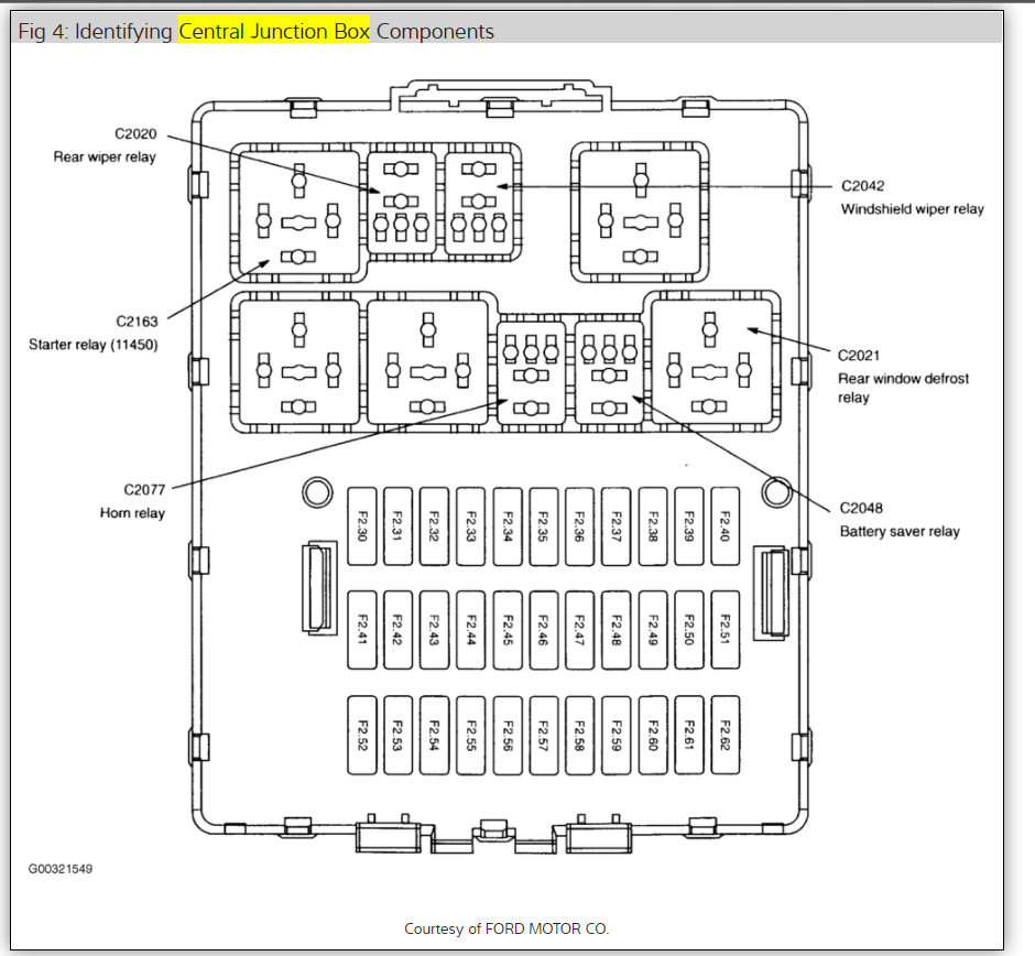

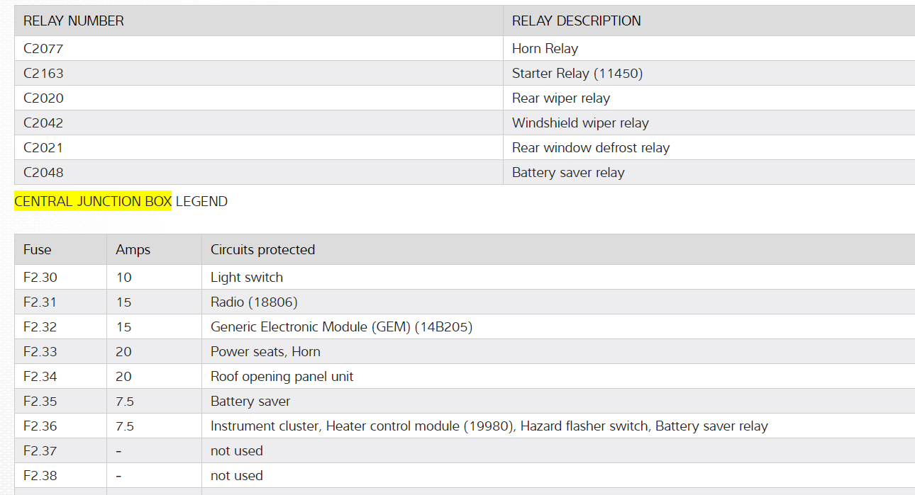

SATURNTECH9
  • 30,869 POSTS
It sounds like you could have a fuse that is blown here is a guide so you can help test and the fuse location in the diagrams below.
Check out the diagrams (Below). Please let us know what you find.
MADUKESOF3
it was a 30amp fuse in the engine compartment! thanks for helping me!
SATURNTECH9
  • 30,869 POSTS
Your welcome glad to hear you got it fixed.
