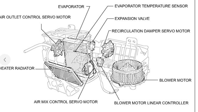

The actuator is making a loud ticking noise that will not stop, when the car is started. It will not go away and is loud. I removed the glove and found that the blend door actuator motor is jammed. I disconnected the electrical wires that run to it and left the blend door in closed position. Problem is I cannot get clear access to the four small Philip screws that secure it, there is just no clearance, even for a short stubby or flexible shaft screw driver. I do not want to start taking the dash apart, just want to know if there is a trick to removing/replacing this part, and does it even need to be replaced is I leave the defective unit unplugged?

There are a couple of actuators. is this one for the cold/hot control or the one for mode?

Here is a picture. can you tell me which one???

Good image of what I am dealing with. It is the re-circulation damper servo motor. Four small Philips screws coming in from left side, can only get at one after removing glove box door and white plastic air deflector directing air at feet coming out of center console. Right now I have the electrics disconnecting and re-circulation door closed.

Okay, the bad news is the case for the blower motor has to be removed to gain access to the screws. it pays three hours in a shop and would likely take you at least double the time if you are going to perform it yourself.
Are you going to replace it?

I had the blower motor off (three screws and it drops down), but it will not give me access to the screws. I think the entire blower motor housing which contains the filter and the recirculating air vents and with the damper motor attached needs to be unbolted and dropped so you can get at that re-circulation damper servo motor. I do not think I am going to fix given the age of car and the complexity of the fix. If I need outside air I can open the windows. Thanks
