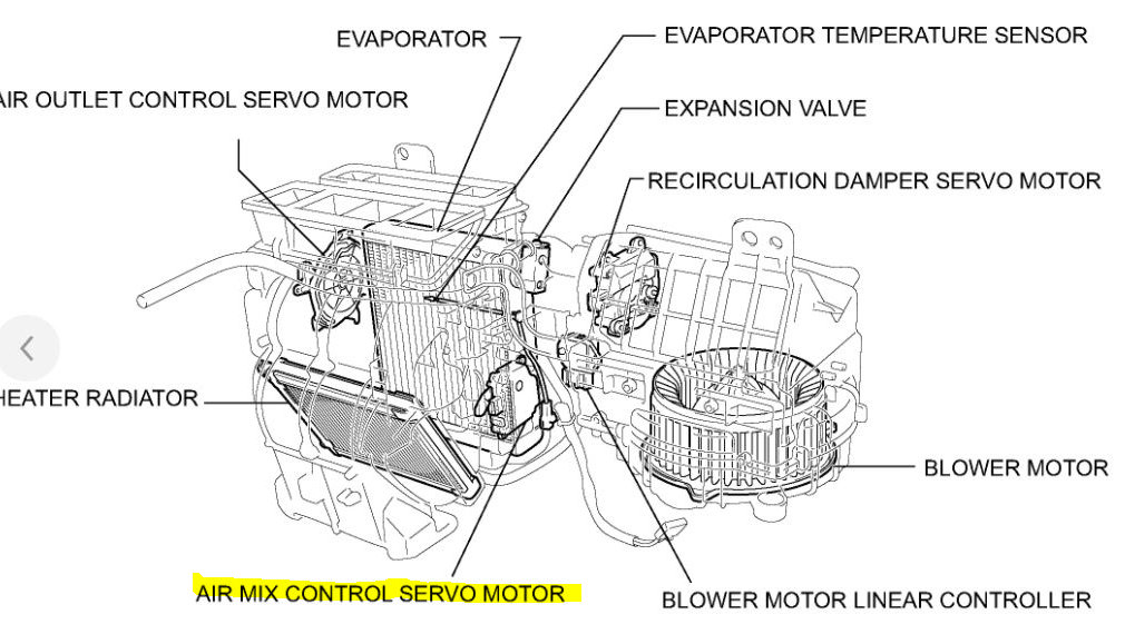

Heat is always on. Even when the a/c is supposed to be on?
Thursday, April 24th, 2008 AT 1:04 PM
SQM
  • 6,383 POSTS
So, when you turn on the A/C, does the compressor turn on?
If the A/C compressor is working properly but you only get hot air, then it could be due to a faulty blend door actuator.
The blend door actuator is what controls the hot and cold air flow/mix.
A faulty actuator can fail on the hot or the cold side. That will lead to only hot or cold air out of the vent.
The blend door actuator is located behind the dash on the HVAC box.
