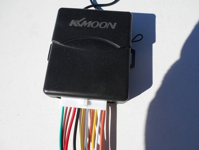

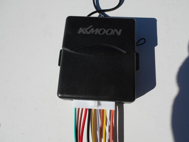

I'm not good with colors, but here is how I think the colors are listed below from left to right in the picture I sent you:
1. green, 2. brown, 3. brown, 4. red, 5. black 6. yellow/ black stipe 7.. white/black stipe 8. orange or light red/black stripe 9. yellow 10. white 11. orange or light red
It's like I said that I'm not good with certain colors.
See if this will help.

i have plenty of patience on this because it doesn't need to be done real fast, better to get it right the first time. What is the name of this door lock control box? it's looks like it says KMOON on the front of it.

Nov 25, 2020 at 5:08 AM
I was wondering if I could connect the red hot wire and the black ground wire to the battery then connect the white wire to my voltmeter and see if there is an voltage coming from the white wire? I also was wondering if I could connect the white/black wire to the volt meter and press the button on the key fob to see if any voltage is present on either of the wires ?
