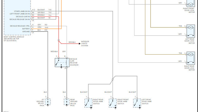

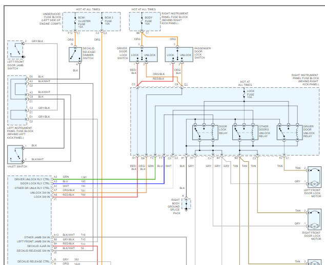

I'm needing to wire this to my car listed above to get my key fob working properly . Does anyone know what colored wires I need to connect this controller to so my key fob will work?
How do i wire Docooler Car Remote Central Lock Locking Keyless Entry System?
Oct 28, 2020 at 11:17 AM
DANNY L
  • 5,648 POSTS
Hello, I'm Danny.
I've attached below the wiring diagram for the remote keyless entry door locks for your car. I've cut the picture into 2 pieces so you can view larger. Hope this helps and thanks for using 2CarPros.

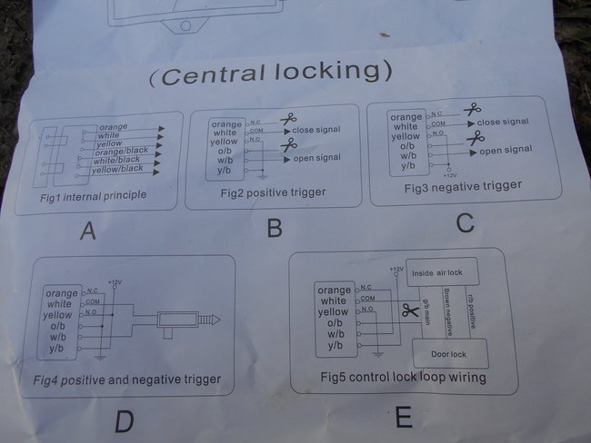

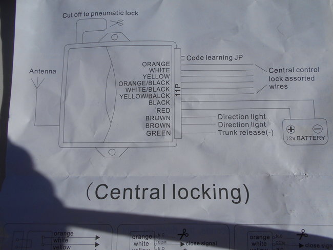

I received the Docooler Car Remote Central Lock Locking Keyless Entry System from UPS today.
The only way that I can give you the wiring diagram for it is to take a picture of the paper that the wiring diagram is on that came with the product I ordered.
I will take 2 pictures of the Keyless Entry Instruction and it will be the front and back of the paper .Can I send these photos from an SD card to you ? Thanks

  • 342 POSTS
here is the wiring for this:
Nov 2, 2020 at 10:50 AM
UHSNOEBIRD
  • 342 POSTS
I might have to get you a better picture tomorrow if you want me to. Thanks

  • 342 POSTS

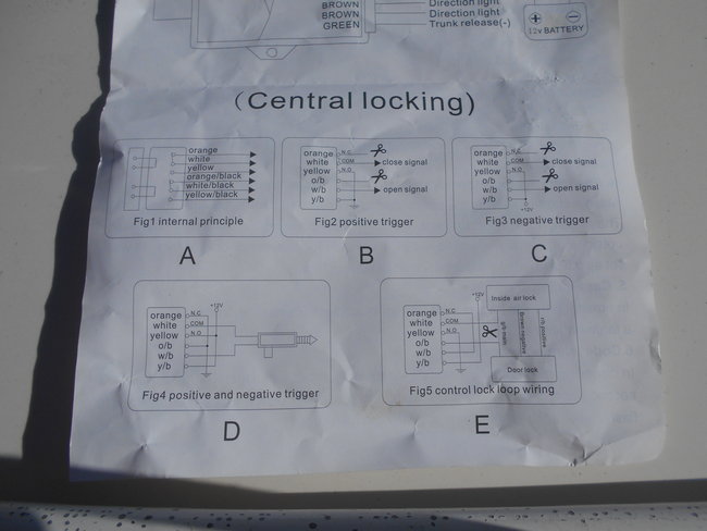

here is the 1st half of the wiring:
Nov 3, 2020 at 1:52 AM
UHSNOEBIRD

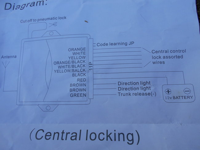

  • 342 POSTS

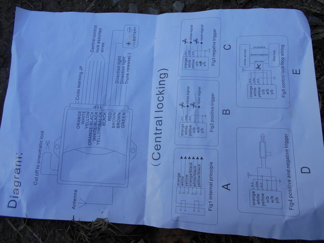

here is the 2nd half of the wiring:
Nov 3, 2020 at 1:53 AM
UHSNOEBIRD
  • 342 POSTS
another picture.
Nov 3, 2020 at 2:01 AM
UHSNOEBIRD
  • 342 POSTS
picture.
Nov 3, 2020 at 2:03 AM
UHSNOEBIRD
  • 342 POSTS
last picture ,hopefully you can see the wiring.
Nov 3, 2020 at 2:07 AM
DANNY L
  • 5,648 POSTS
Hello again.
Is that all the directions there are? No wording? Figure A,B,C,D, and E all are using the same color wires. Kind of weird. I'll look on their site to see if there is anything more. Thanks again for using 2CarPros.

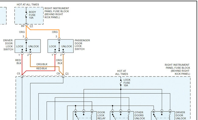

  • 110,244 POSTS
I looked through this and jumping back and forth through your pics and the car's schematics. this should make the lock and unlock work. To get the lights to flash will require you to connect the brown wires to the lighting circuit. I attached a pic below of the wiring where I feel you need to splice into the locking system.
Please keep in mind, this is a theory, but since the controller you purchased supplies a 12v signal, it should work.
Controller To Vehicle Main door switch
White To Red / Black
White / Black To Orange / Black
Black To Ground on the vehicle
Red To 12v constant power supply,
Danny, please let me know your thoughts on this. This should be a basic set up to lock and unlock the doors. What do you think?

  • 110,244 POSTS
I noticed that. However, (and I could be wrong) the schematics provided show NC. I'm wondering if that means they are not connected. Regardless, hopefully, Danny can explain this to both of us. LOL
Nov 11, 2020 at 12:36 PM
UHSNOEBIRD
  • 342 POSTS
It might mean normally closed in a relay, that's how they abbreviate it in electronics.

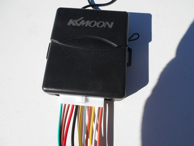

  • 342 POSTS
This door control box has 9 wires plus the red (hot) and black (ground) wires coming out of it if this will help you anyway.

  • 342 POSTS
There's 11 wires total coming out of this control box, I forgot to say that in the last message.
