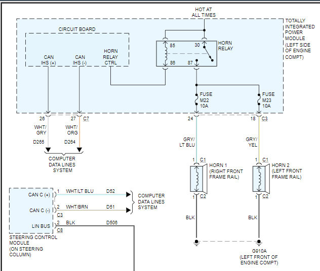

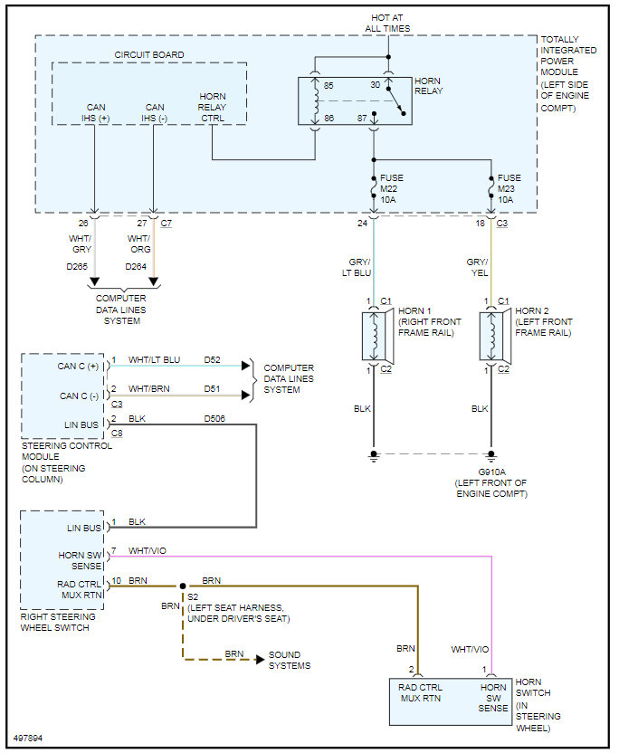

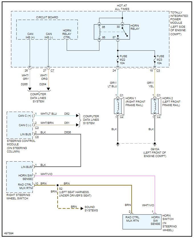

I seem to be having issues with my horn in my 2016 grand caravan. Stumbled upon this during a Google search. Any chance you have diagram for this? Or would it be the same as the 2014's?
Saturday, August 29th, 2020 AT 12:35 PM
It is similar to the 2014 but I attached the wiring diagram from the 2016. Let us know if you need other info. Thanks
Saturday, August 29th, 2020 AT 1:23 PM

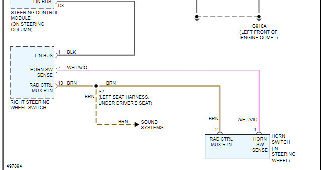

Here is the horn circuit wiring diagram you've requested. I've cut the picture in half so you can view larger. I've attached them below. Hope this helps and thanks for using 2CarPros.

Thank you so much! It appears it was my own doing while installing my remote starter. And managed to cut the wire when I cut a zip tie. Oops.
So this helped in multiple ways!
