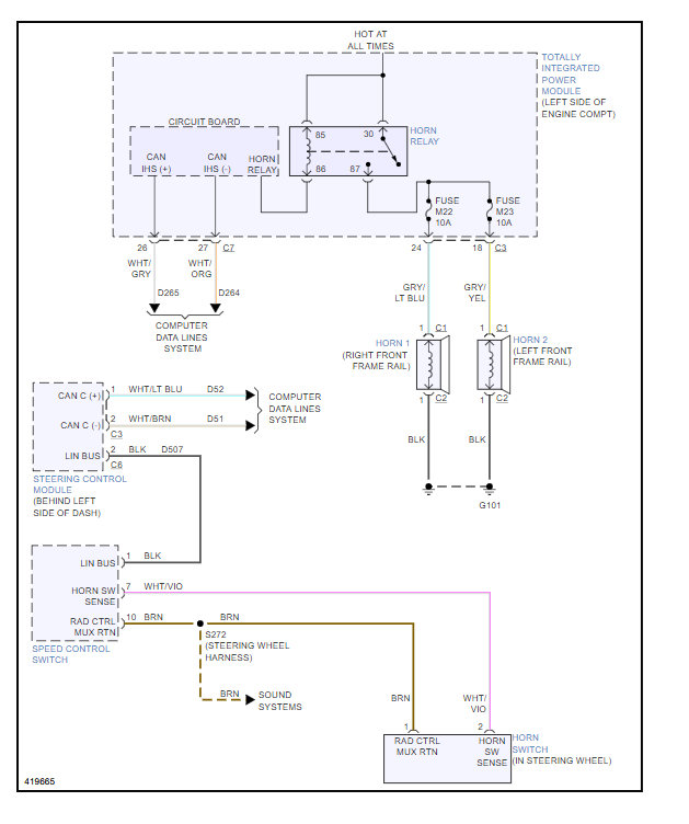

The horn is not working at the steering wheel, but when I press the panic button, the horn works. I checked both fuses ( left and right horn ) under the hood, both checked out good.
I have turned the key to the "on" position and checked the fuses with the volt meter, I have noticed that all the ten amp fuses in the box read approximately twelve volts, except for the two ten amp horn fuses. They are reading zero. Is this normal?
My brother took the car to the shop and they told him it was the clock spring and they want to charge him $700.00 for part and labor. Does this sound like a clock spring symptom? I thought that the fuse side should already have voltage and when the switch at the steering wheel is pressed, it throws the relay and sounds the horn.
May 26, 2017 at 10:23 AM
CARADIODOC
  • 34,367 POSTS
You cannot assume anything today because there are multiple computers hung onto every circuit. You would be right on older vehicles that twelve volts should be at the horn relay. In this case the clock spring is a good suspect, but the repair estimate is way out of line. Thanks to the liability insurance built into the cost of the part, a typical clock spring should cost around $150.00. Unless there's something I am not aware of, replacement should take about an hour.
This wiring diagram below can show you how the system works.
The clue you should look for is if the clock spring is coming apart, other functions on the steering wheel will also fail. That can include cruise control switches, and the airbag warning light will turn on.
If only the horn function is dead, I would recommend using a scanner to see what the Integrated power module is seeing as far as "horn request" signal. If that is showing up when you press the horn switch, that module becomes the better suspect.

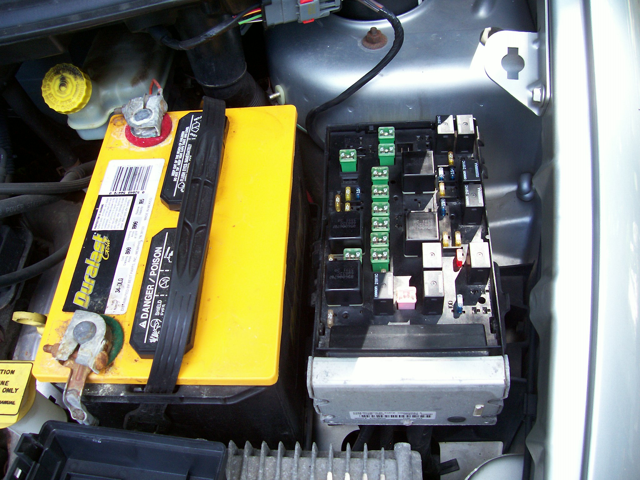

My dodge caravan 2002 horn does not work, but the ABS work light works great.
I've already checked the fuse, relay, cleaned all the socket (fuse, relay etc) and checked the wire from horn to the fuse and relay, every are good connection. But the horn does not get a power.
Would you give me some suggestion what step do I need to do?
Do you know where I can get the wiring diagram for this car? Your prompt reply is appreciated, thank you.

BAGUSKAYAKU
  • 6 POSTS
Rasmataz and JDL thank you.
I did jumper for cavity 30 and 87, the horn sounds great.
Would you give me idea how to check the the steering column or front control module?
Please let me know,thanks

BAGUSKAYAKU
  • 6 POSTS
JDL,

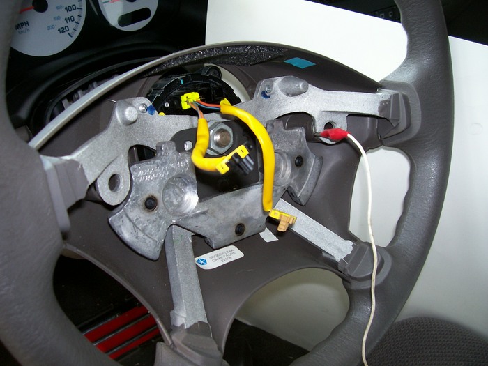

Finally, I found the problem, the printed board where the firing is broken a part in the middle. So I connect it with wiring from the out side. It works great, thank you so much for your help.

BAGUSKAYAKU
  • 6 POSTS

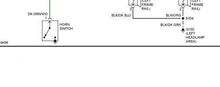

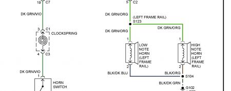

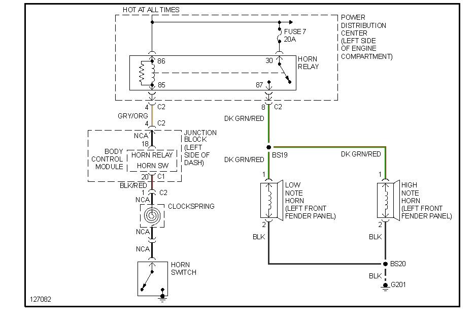

Bass, the location of the printed board is beside the battery(please look at first picture). I attach the diagram(picture 2-4) and check the printed board with the multimeter and has a good connection. And make sure the clockspring has not broken. Autozone sells the clockspring ( Part Number: 525-101 )about $ 50. Please let me know if you need more information. BK

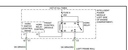

Did you check for voltage at the fuse circuit? Even if the fuse is good, if no voltage on the fuse circuit, the circuit is still dead. You could swap that horn relay with another relay, just make sure sure they are the same, note the diagram and reading on the relay, where applicable.
Usually the problem is the wiring in the steering column, but, I'd check everything else first. At the horn relay cavities, if you use a jumper wire between terminal 30 and 87, the horn should sounds, if it does, that part of the circuit is ok. Then you would have to check control side of relay.
Note wiring diagram.
