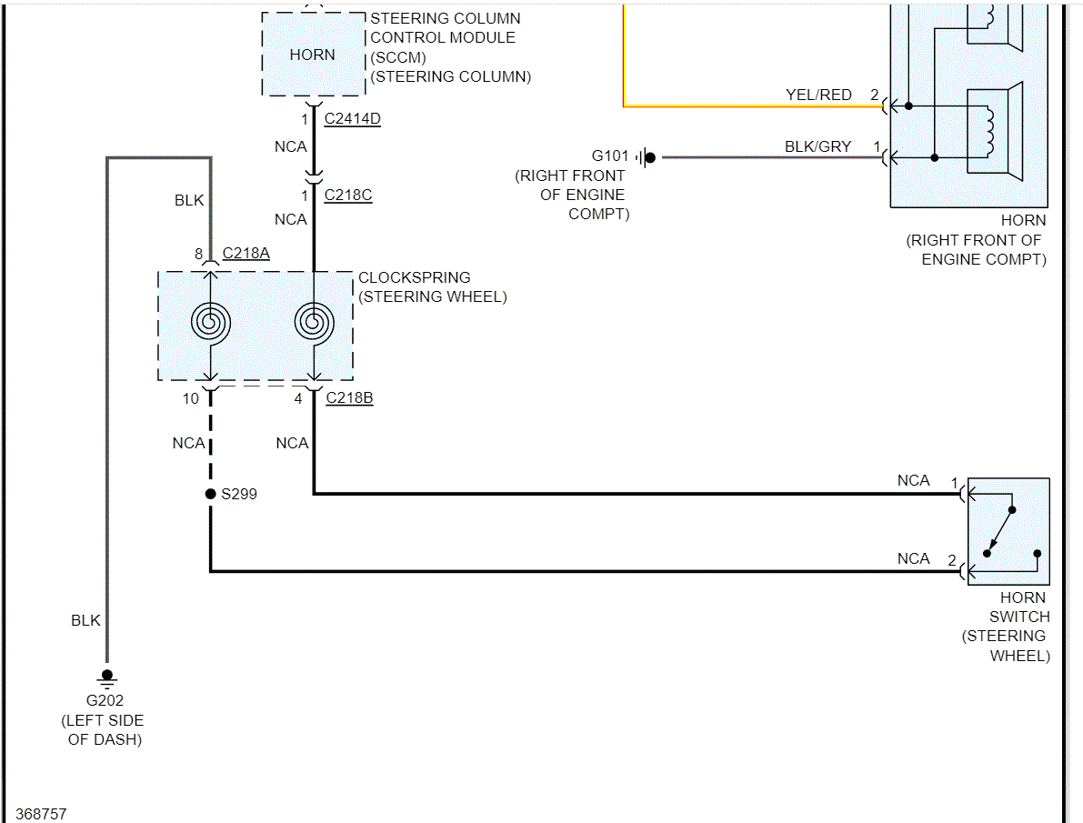

Horn not working but does when panic button pressed on FOB. Mechanic can't figure out why.
Dec 30, 2021 at 7:54 AM
  • 110,240 POSTS

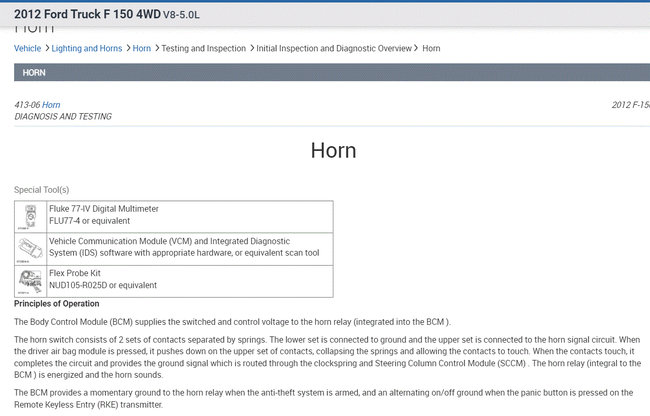

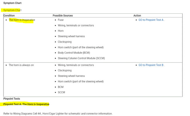

By chance, is the airbag light staying on? Since the horn works with the fob, the fuse to the BCM is good. There are many other things that can cause an issue, but if the airbag light is on, chances are the clock spring in the steering column has failed.

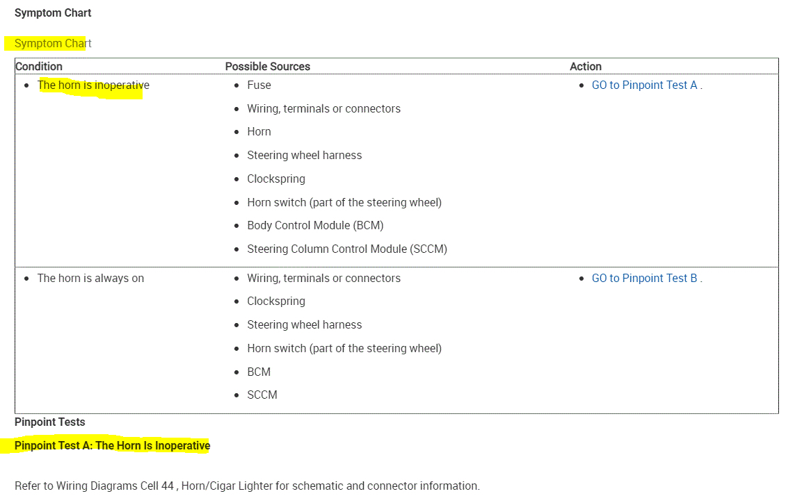

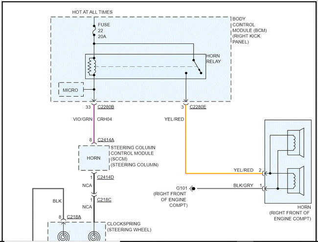

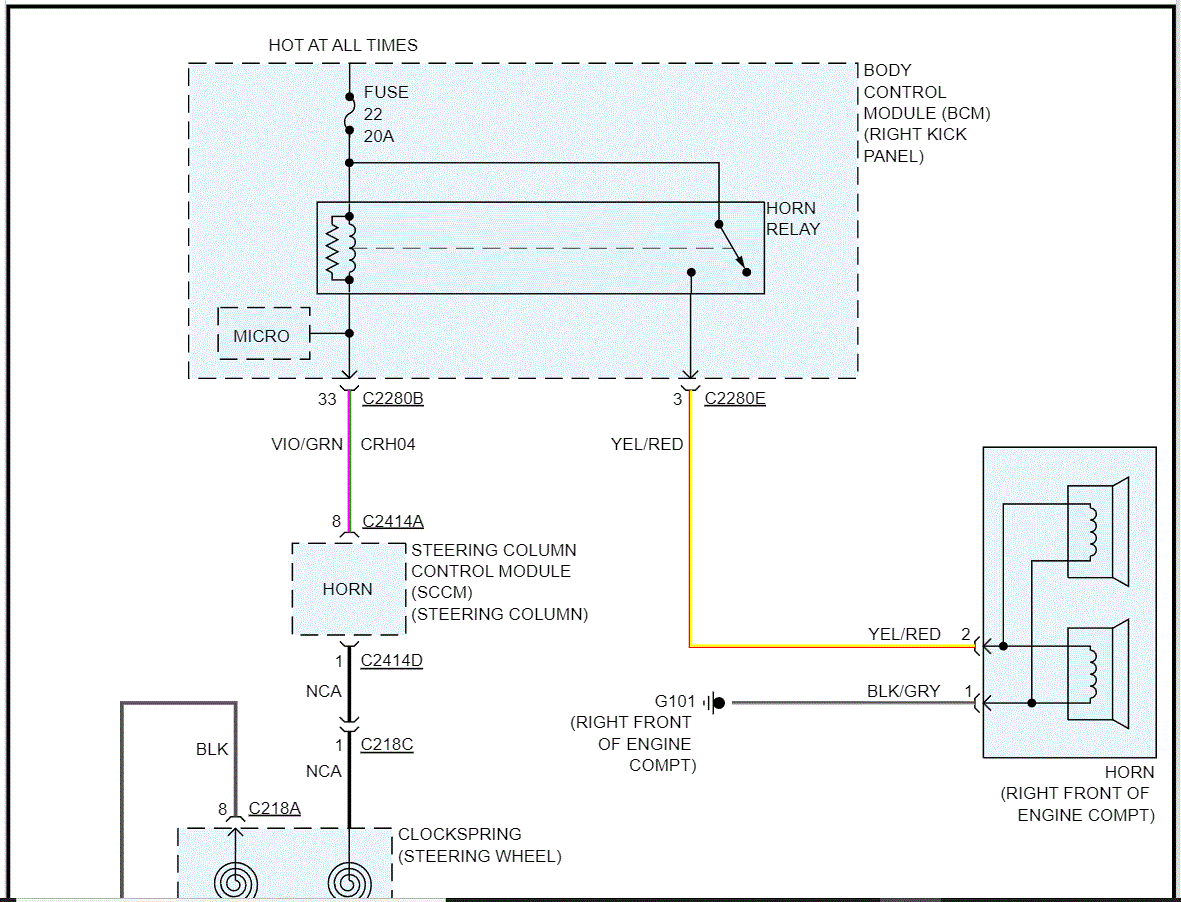

I attached a wiring schematic below of the horn circuit for your review. Let me know about the light being on. Also, confirm fuse 22 in the BCM fuse panel (right kick panel) is good and has power to and from it. Here is a link you may find helpful:
Let me know what you find with the fuse and about the light.
See pics below. Note: I had to cut the schematic in half to make it readable for you. I did overlap them so you can follow from one to the next.

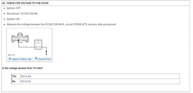

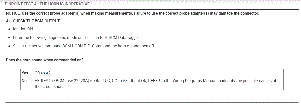

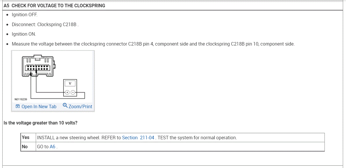

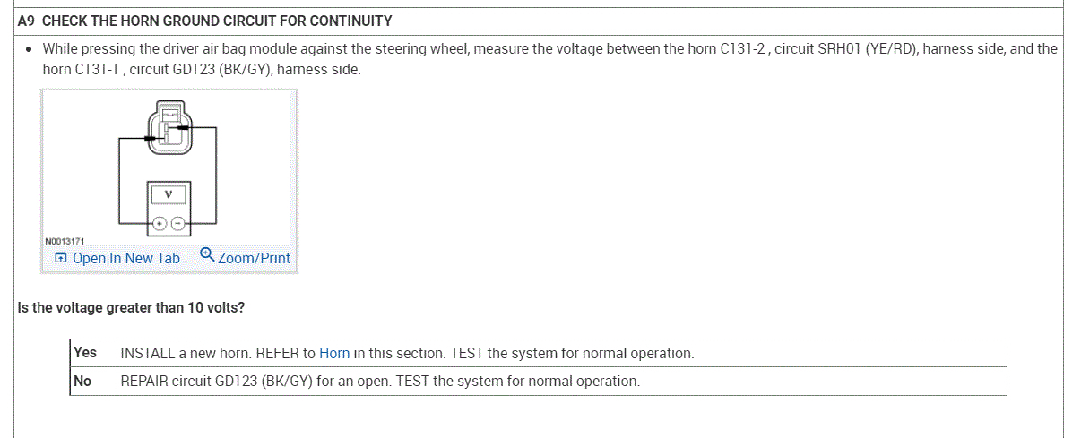

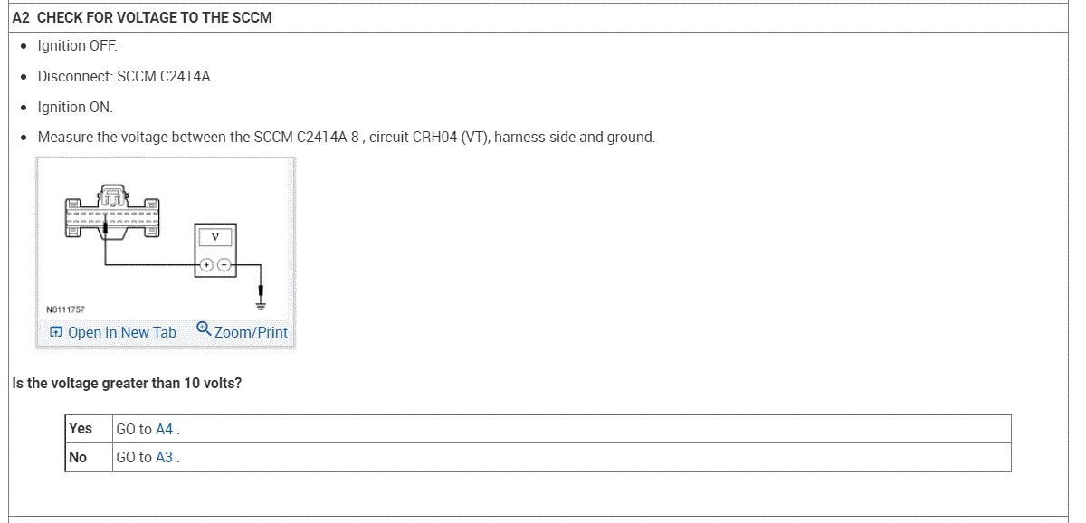

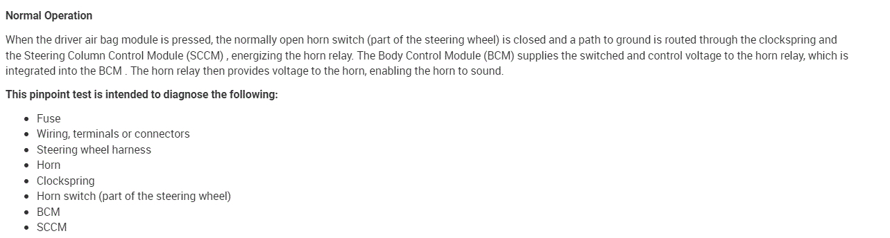

For this to be diagnosed, the first thing that should be done is to check the can-bus for codes. CAN stands for controller area network. Basically, all the computers/modules on the truck are tied together via a few wires. As a result, the systems communicate with each other.
Here is a link showing how that is done:

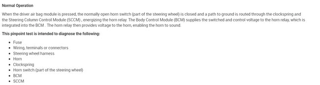

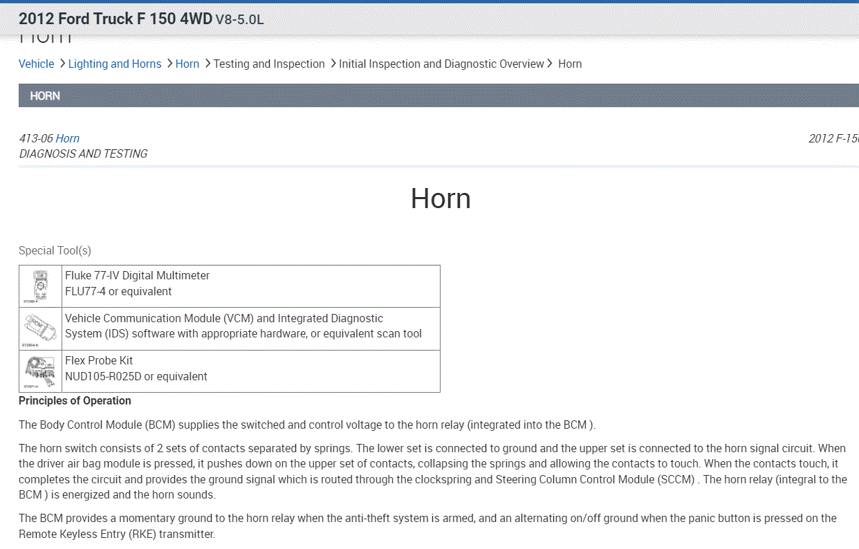

I'm suggesting this because there are two modules at play with the horn, the body control module (BCM) and the steering column control module (SCCM). This type of scan will pull codes regardless of the module storing them.
Let me know if that is something you can do or have done.

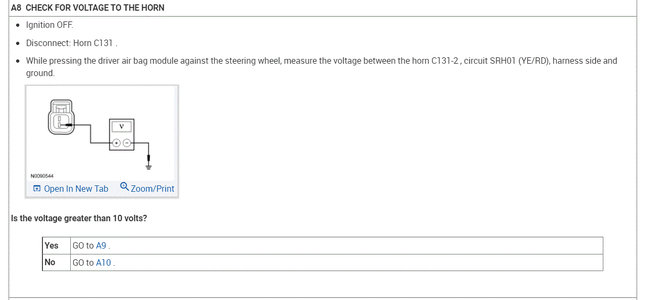

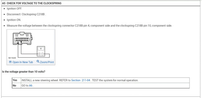

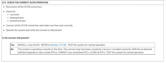

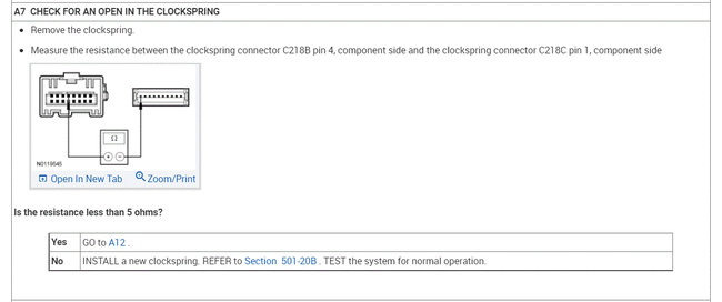

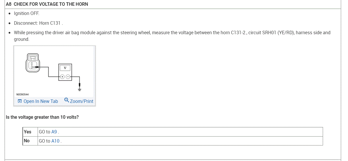

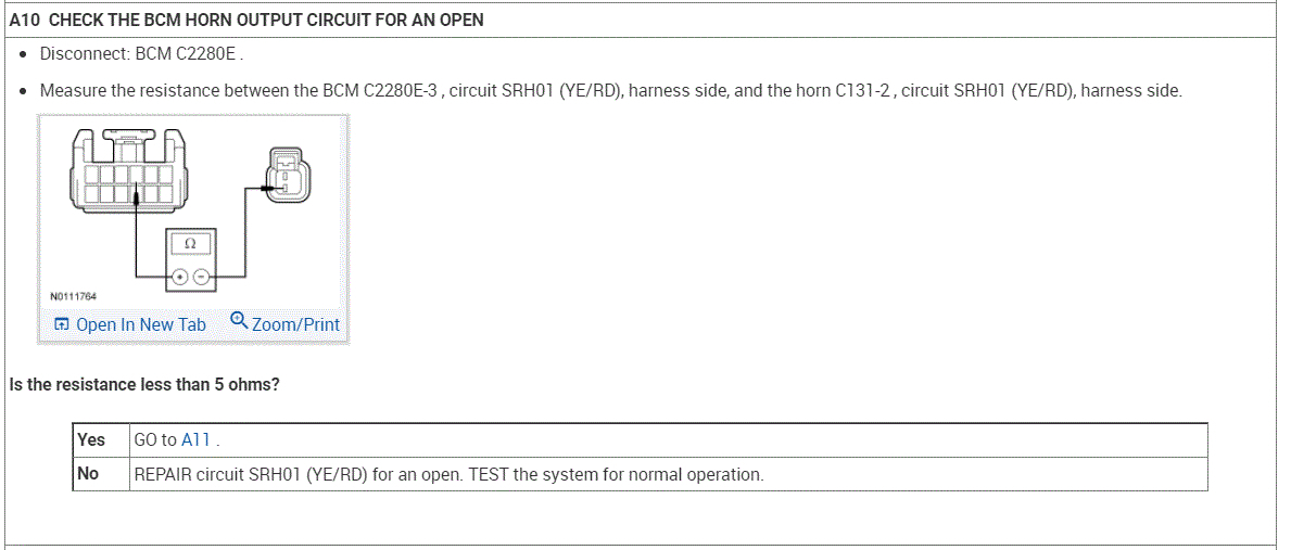

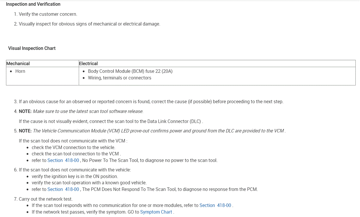

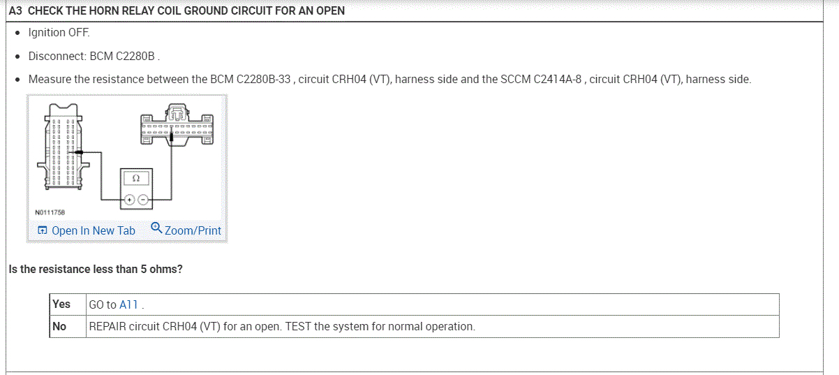

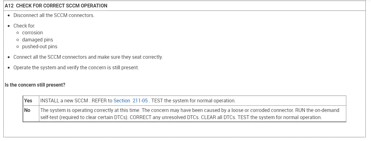

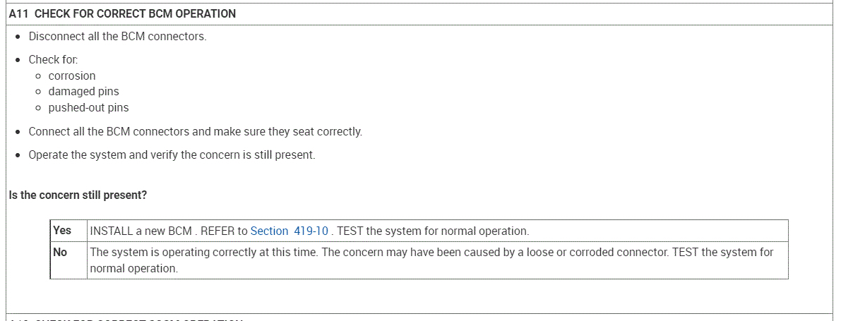

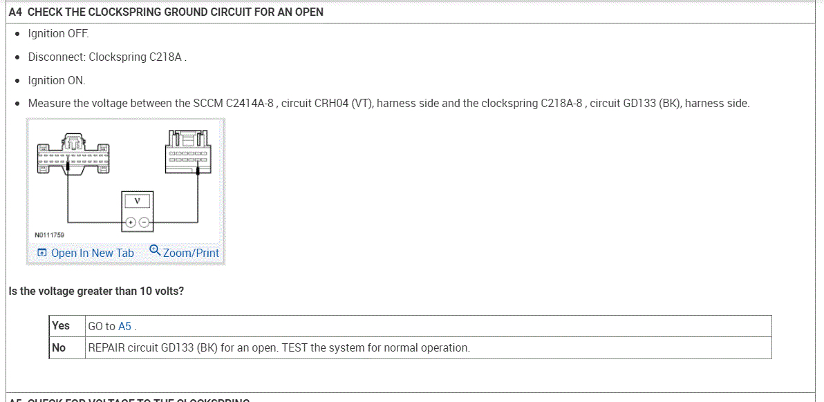

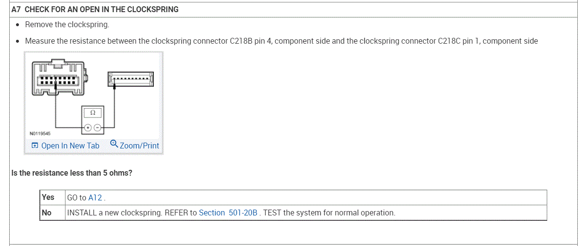

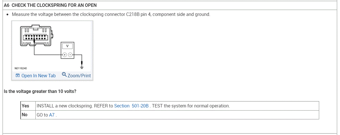

On the other hand, we can go through diagnostics, which will also require a scan tool and a few other things. I attached them below for you to see what is involved. If you are comfortable performing the diagnostics, great. If you are comfortable, I will work through them with you. Just let me know.
Let me know your thoughts. Also, please let me know if you have questions.
