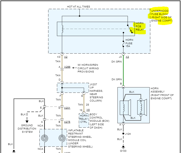

Horn not working.
Fuse is good.
Trying to locate horn relay.
Check both fuse boxes not noted anyone of them.
Thank you

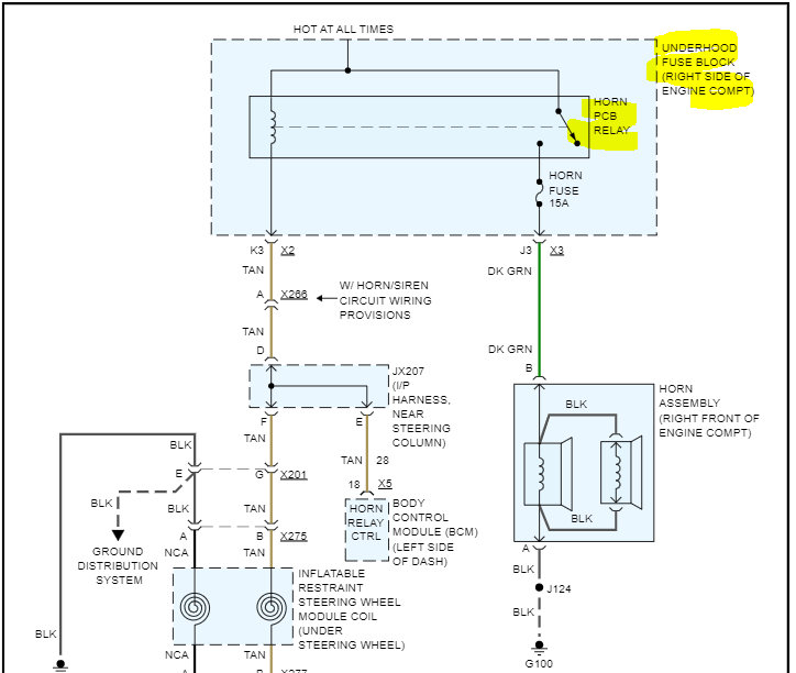

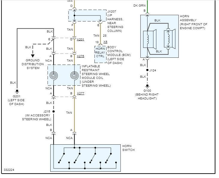

The vehicle does have a horn relay, but it isn't a traditional one. It is an integral relay soldered on a printed circuit board. It isn't replaceable. If it fails, the relay box needs to be replaced.
I attached the horn circuit wiring schematic below so you can see what I'm referring to. PCB stands for the printed circuit board.
The PCB relay box is under the fuse box located under the hood. Now, although it isn't working, there could be other causes. Do you hear a click or anything when you press the horn? I realize you checked fuses, but did you confirm there is power to them? Also, the clock spring needs to be functional for the horn to work. By chance is the airbag light on?
Let me know. Also, you may want to check for power at the fuse.
Here is a link that you may find helpful:
Let me know. Keep in mind, the horns may have lost ground as well. You may want to disconnect them and confirm there is continuity to ground on the black wire. Also, have a helper press the horn while you check for power at the dark green wire.

I did have wife press on horn and I heard clicking near fuse box under-hood

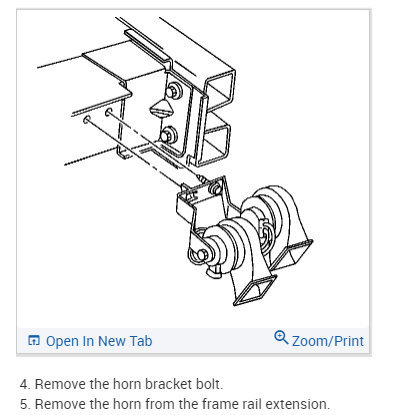

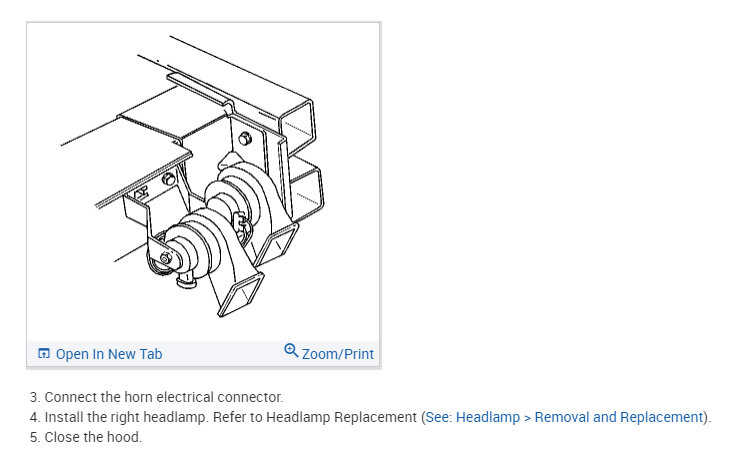

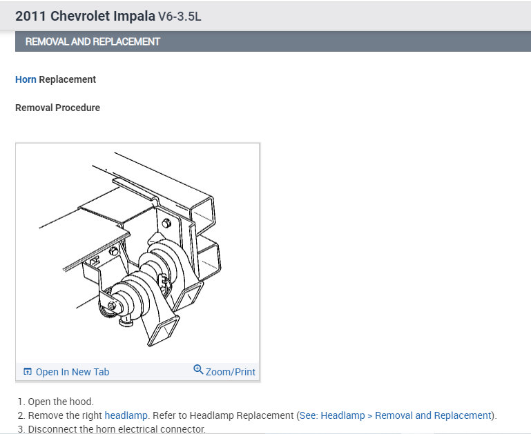

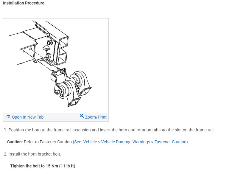

Okay, if you hear a click, check to see if there is power at the horn itself. You may have a connection issue, faulty ground, or a bad horn.
The horn sits below the right headlamp assembly and requires the removal of the light assembly to be removed.
I attached the directions for replacement below just so you know where it is and how to access it.
Let me know what you find.

Looked into the area , saw horn, then to my surprise I saw a wire and connector just hanging and not connected to anything.
This, of course, is the connection for the horn.
I reinforced the connection because it was loose, bolted horn to frame and was done
It works!!
I'm not sure why it was not connected but I did have a new oil pan gasket installed and maybe this was the reason because the sub frame had to be loosened.

I'm glad to know you found the issue. Since you heard the clicking, I had a feeling the horn was bad or there was a disconnected wire. Also, chances are when the oil pan was removed, they pulled it by accident.
