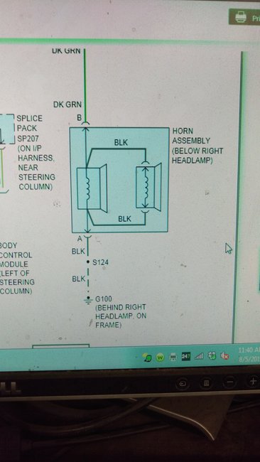

The connector on the cable harness has very small slots, so I inserted stranded wire in the two slots to test it. I have a 12V LED and when I attached it and pushed the horn button it lights up. When I touched the stranded wire to the horn and horn button pressed, it does not honk. I checked the horn again (wires directly from battery) and it works great.

Sounds like a bad ground to me. The LED doesn't require as much current flow to light up as the horn needs to sound.

One test I did was ran the hot (black wire) from the cable harness to the horn, but instead of using the ground (green wire), I connected a separate wire from a screw on the chassis to the horn. Would this have confirmed if the ground was bad?
Aug 4, 2016 at 5:44 AM
RIVERMIKERAT
  • 6,110 POSTS
If the screw on the chassis was a good ground, it should have.
Aug 4, 2016 at 5:54 AM
SORA ESTHER GWENDOLYN WEIMER
  • 7 POSTS
I previously hooked one end of the LED to positive red terminal on battery and the other end touched the screw and it lit up.
Aug 4, 2016 at 8:51 PM
RIVERMIKERAT
  • 6,110 POSTS
Like I said earlier, an LED doesn't require that much current to light up. A horn requires a good deal more current to honk.
Aug 4, 2016 at 10:33 PM
SATURNTECH9
  • 30,869 POSTS
Check out the picture I posted it shows the ground for the horn and it's location.I would say there is probably crossing where the ground is mounted .That would explain the led lights up but the horn doesn't work.
