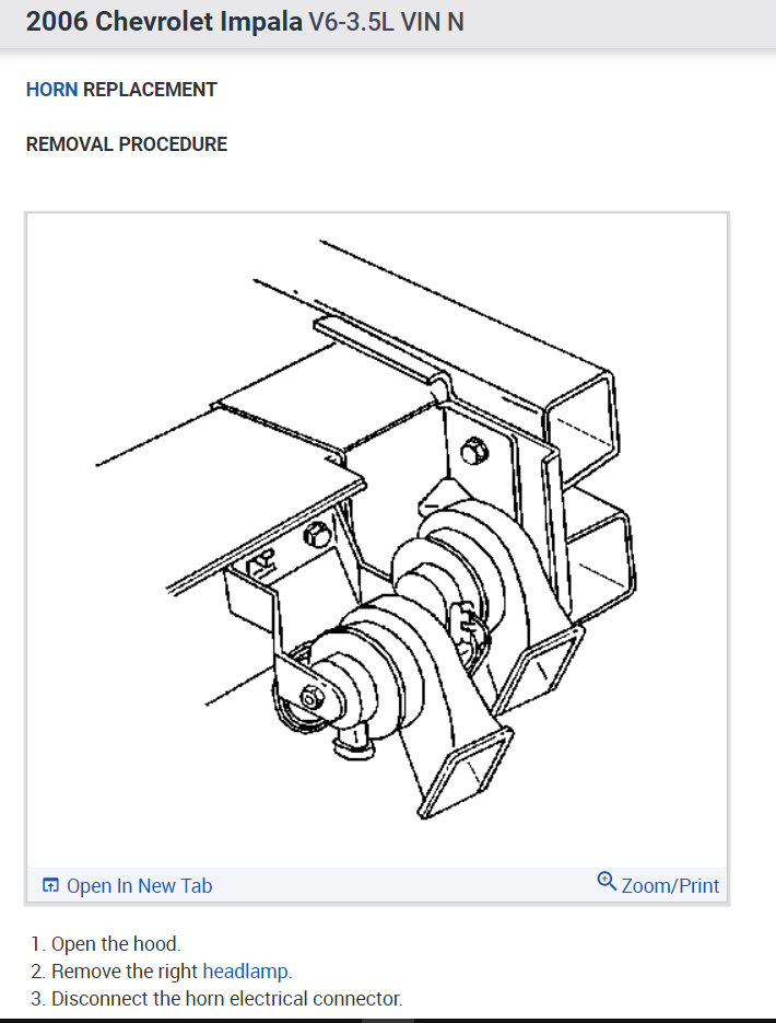

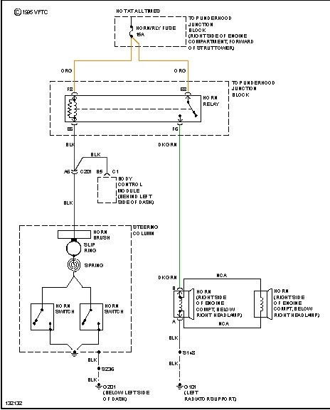

Horn is not working and the fuse is good, also when I push the button for anti theft it is not on need to know what I should do? Do you know where the horn is?
Sep 18, 2010 at 6:45 PM
GMTECH
  • 537 POSTS

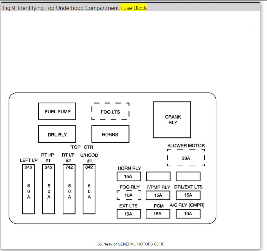

If you can test to see if there is power and ground at the horn that should tell you what you need. You should ground at all times and when the horn is pressed the other wire should have power. If so then you need a horn here is a guide to help test with the horn location in the diagrams below.
If there is now power at the horn check the relay and its location below

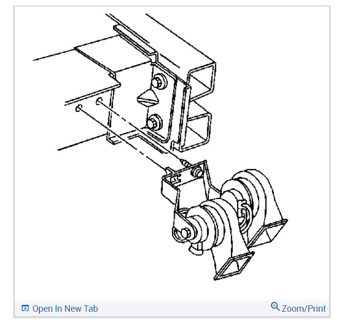

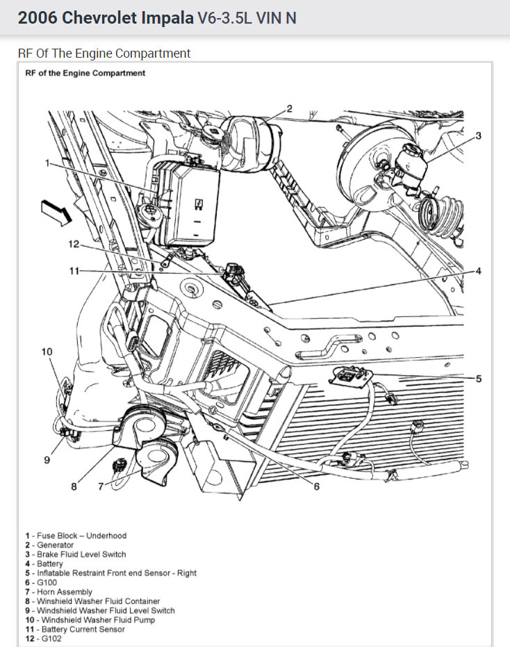

GLENNG63
2005 Chevy Impala 6 cyl Front Wheel Drive Automatic

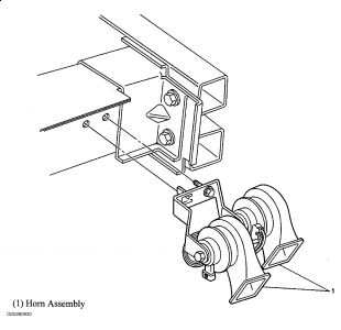

Our horn gradually got softer and now does not work at all. I believe that I can replace it but where is it located
Nov 2, 2020 at 10:07 AM (Merged)
BLUELIGHTNIN6
  • 16,542 POSTS
horn assembly is located on the lower right front of the vehicle.
https://images.2carpros.com/forum/automotive_pictures/261618_Graphic_103.jpg

KIM417
My horn on my 2005 Chevy Impala quit working. I checked all the fuses and that wasn't it. I then replaced the horn itself and that didn't fix it. The horn does'nt work when locking the car either. I was told it could be a horn relay. How do I find it. Do lyou have a dizgram that would help me?
BLUELIGHTNIN6
  • 16,542 POSTS
its in underhood junction block - top (on front of right strut tower)

CHEVY22
  • 1,375 POSTS
hi
under the hood i think on the right side will be a relay box , there is a 15 amp fuse and the horn relay , you will have to look at the box cover diagram for location, check the fuse first, if it is ok there is a horn relay , pull it out and look at the part number , then look for another relay in the box with the sam number and swap them out and check the horn , besides that it could be the horn itself , the horn button on the wheel or the bosy control module , but start where i said and let me know

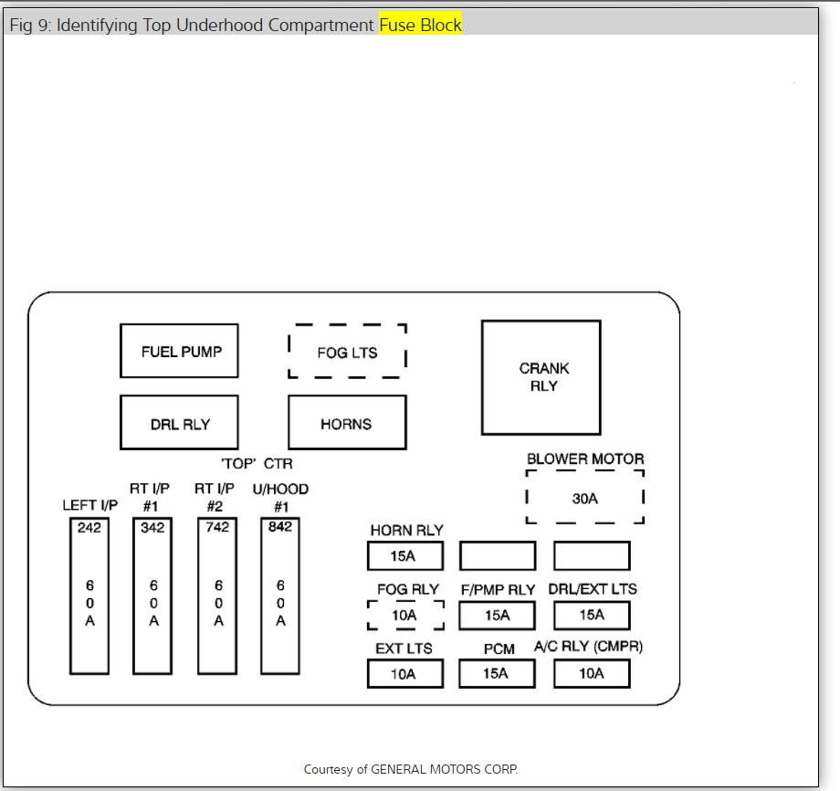

my horn dont work power going to fuse an relay no power to horns when i push horn down
Nov 2, 2020 at 10:08 AM (Merged)
JDL
  • 16,098 POSTS
The horn button is part of the ground circuit for the coil side of horn relay. Possible problem with wiring circuit in steering column?
Because of air-bag, there are safety issues with working on steering column.
If you use a jumper wire between the load side of relay, the horn should sound, does it? The load side of relay is the side with the arrowhead line.
