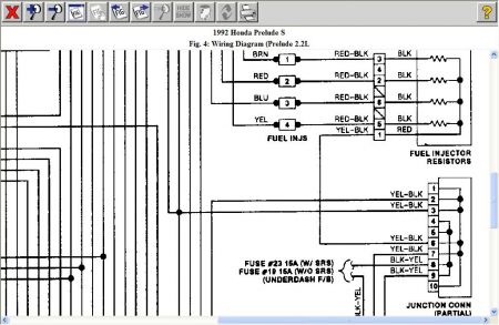

What relay controls the fuel injector? Because the sark plugs are firing and the fuel pump is kicking on when we cut the switch on and hear it running. Smell gas when you push down on gas pedal but it dont want to start acting like its not getting gas do you have any idea what the problem would be
Friday, September 19th, 2008 AT 7:57 PM
  • 75,992 POSTS
Do you have power on the red and black wire at the injector harness?
https://www.2carpros.com/forum/automotive_pictures/12900_injector_3.jpg
