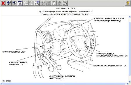

Sorry for the dumb question, but where's the control module?
Sep 2, 2008 at 1:01 PM
KHLOW2008
  • CERTIFIED EXPERT
  • 41,814 POSTS

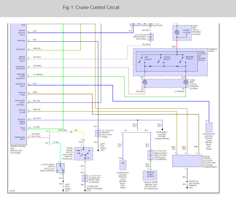

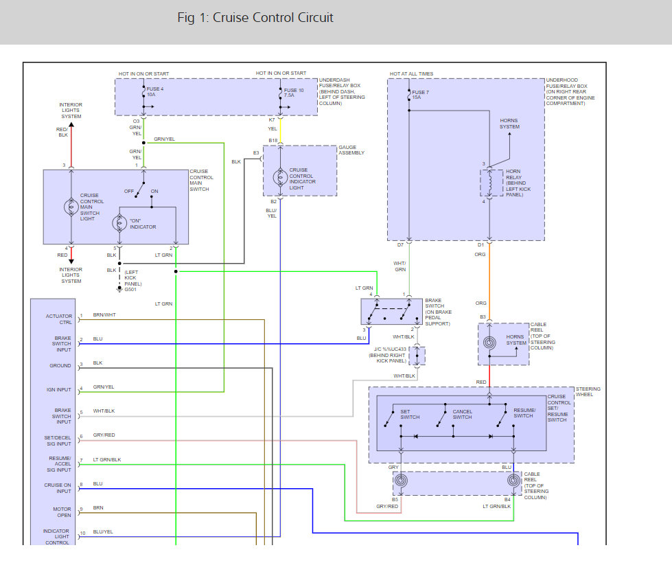

Hi xander777, It is the cruise control unit.
https://www.2carpros.com/forum/automotive_pictures/192750_CruiseComponentsCRV02_1.jpg
Check #10 (7.5A) and #4 (10A) in under dash fusebox and #7 (15A) in underhood fusebox. Check if horn is working. Check if the tachometer is working properly.

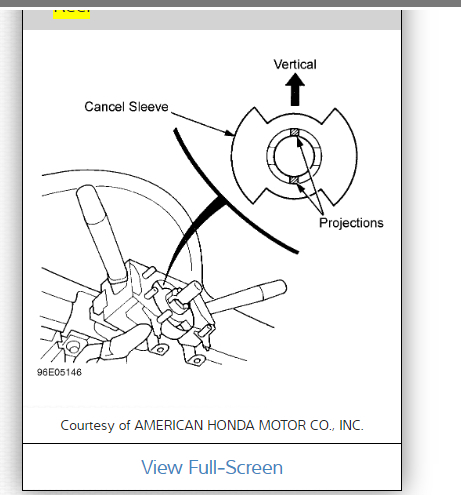

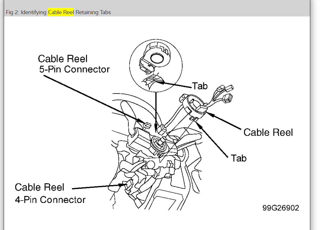

I have a 2002 CRV with same problem. Changed out the cruise control switch worked for 3 minutes then cut off. Battery is at 13.9v when driving. Should I change out the cruise control module next or try the brake pedal analysis first. By the way cleaned all the contacts already with electric contact cleaner.

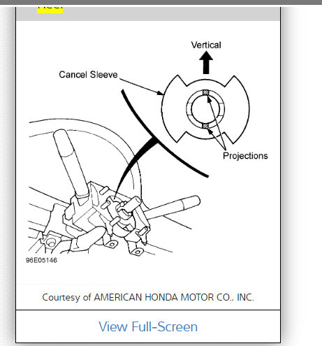

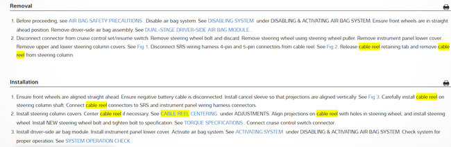

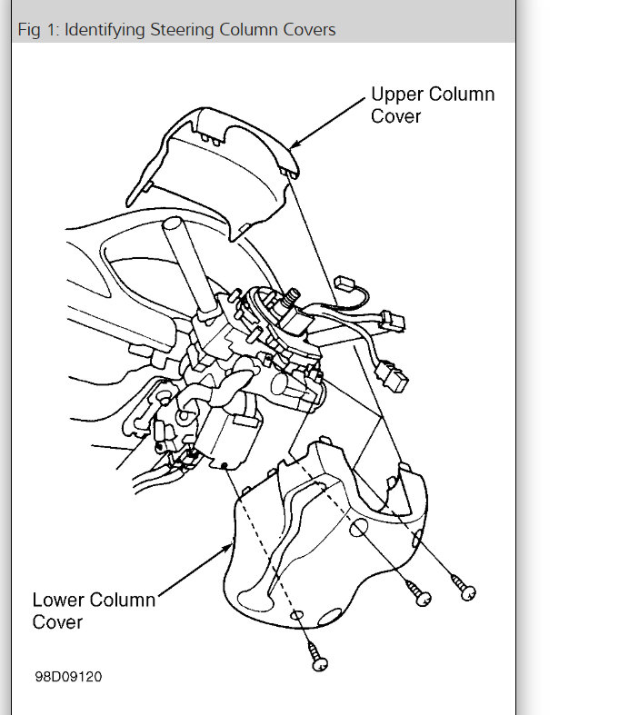

9 times out of 10 it is the clock spring which goes out due to wear. To be sure here is a guide to help you check the wiring and the cruise control wiring diagrams so you can see how the system works and the instructions on how to check the clock spring out in case it proves to be faulty:

Switch on the steering wheel reset, cancel, set.
May 10, 2019 at 2:10 PM
  • CERTIFIED EXPERT
  • 53,872 POSTS
The part I think is the problem is the clock spring. check out my earlier post. Let me know please.
