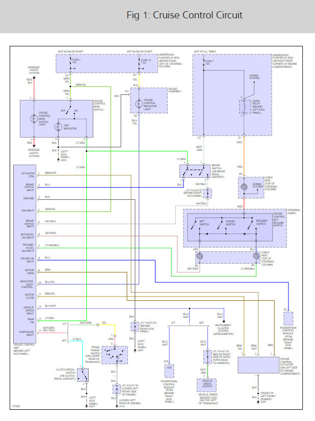

Cruise control will not work. The light does not come on when cruise control is turned on and it will not engage cruise control.

Hi briant97,
Check fuse # 4 ( 10 A ) in under dash fuse/relay box first. If that is okay the problem usually is in the clock spring under the steering wheel but to be sure here is the wiring diagrams and a guide to help you test the system to confirm the failure;
and
https://www.2carpros.com/articles/steering-wheel-clock-spring-removal
Check out the diagrams (below). Please run some tests and get back to us.

I had this problem and the dealer replaced the clock spring for $370.00 I wish I saw this post first, DOH!
