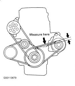

I bought the two fan belts to replace the old ones. is there any special info that I should know? I don't have a shop or a lift to get the vehicle up. Will I need a ramp or can I get to the belts from above the engine? Is there a tensioner or do I need to loosen the alternator or A/C unit to access the belts?

Unbolt alt. slide in for one belt. The other has tensioner loosen nut in middle of pully then turn adj bolt to loosen
https://images.2carpros.com/forum/automotive_pictures/198357_Graphic_78.jpg
