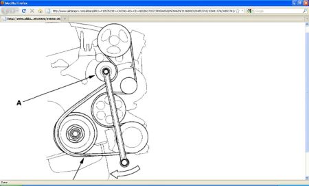

need to replace serpentine belt, need diagram please

https://images.2carpros.com/forum/automotive_pictures/416332_2002_honda_crv_belt_routing_1.jpg
There you go.

Hi, can anyone pls label them, which one is the aircon, alternator, power steering, engine pulley? Thanks,

Top pulley power steering pump next pulley down left side is the belt tenisoner next pulley down right side alternator next pulley down is water pump next pulley down right side a/c compressor then two the left side is the crank pulley.
