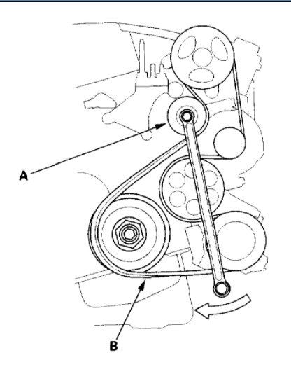

I was wondering if it is possible to replace the serpentine belt on the vehicle listed above?

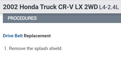

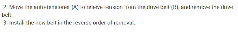

Yes, the serpentine belt is replaceable on your car. Here is a tutorial showing how to replace a serpentine belt:
I've attached picture steps below on how to replace the serpentine belt on your vehicle. Be sure to refer to this picture how the belt is routed in case you forget after removal. Hope this helps and thanks for using 2CarPros.
