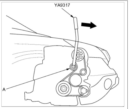

I need to know how to replace the serpentine belt?
Please help me.

You need to turn the auto-tensioner lever (19mm hex head) to release the tension and get the belt out.
Here is a guide to help you see what you are in for when doing the job.

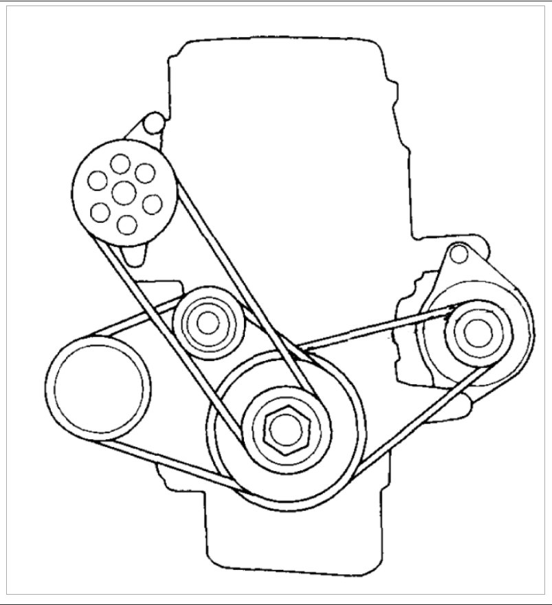

Here is the belt diagrams (below)

The belt has been replaced and thank you for the diagram it was helpful.
