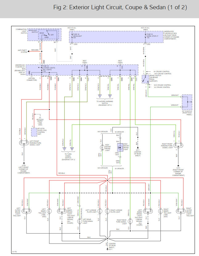

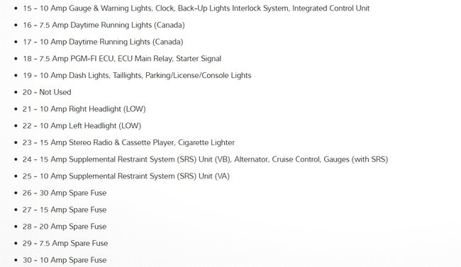

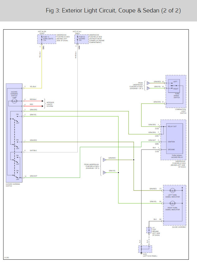

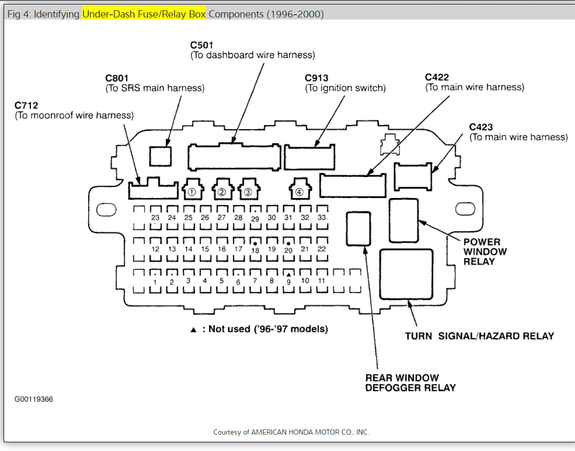

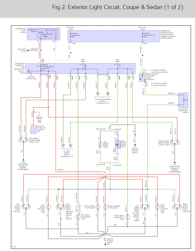

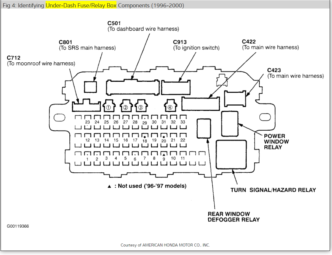

i have a 96 honda civic hx... the problem is my parking lights does'nt lit up both front and rear, but if i turn the signal lights on or the hazard on it works...it lit's up...it blink's both front and rear... i check the fuses under dash i change some new fuses for turn signal and starter signal but stil it does'nt work for the parking ligths... please help me with this thank you...

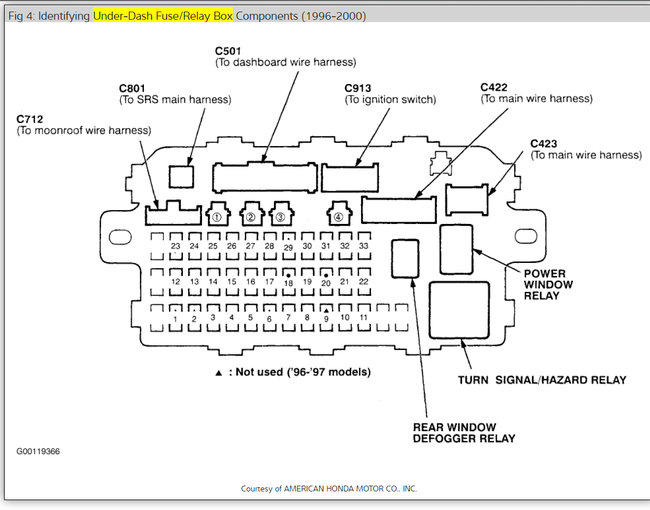

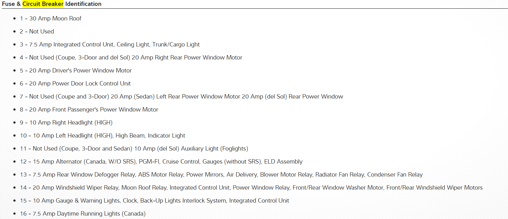

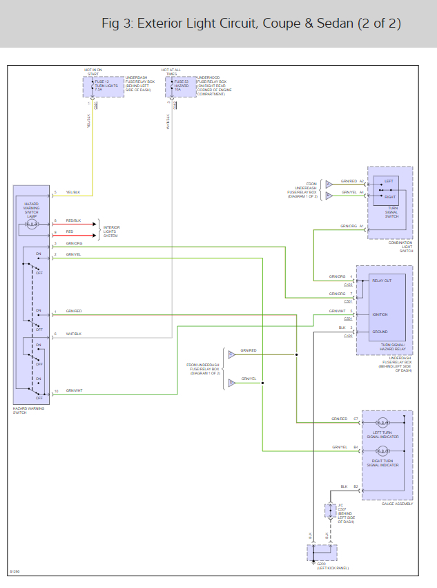

This sounds like you have a fuse #32 that is out or you are losing power somewhere here is a guide and the running light wiring diagrams so we can run some simple tests.

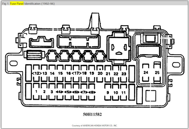

There are two different fuse panels because this is a split year here are both.
Cheers

I had the same problem on my car, thanks to this guide my lights work again I replaced the fuse! all fixed.

Check fuse #32 for the parking/running lights and replace it if blown. If the fuse is good, test for lost power using the running-light wiring diagrams.
