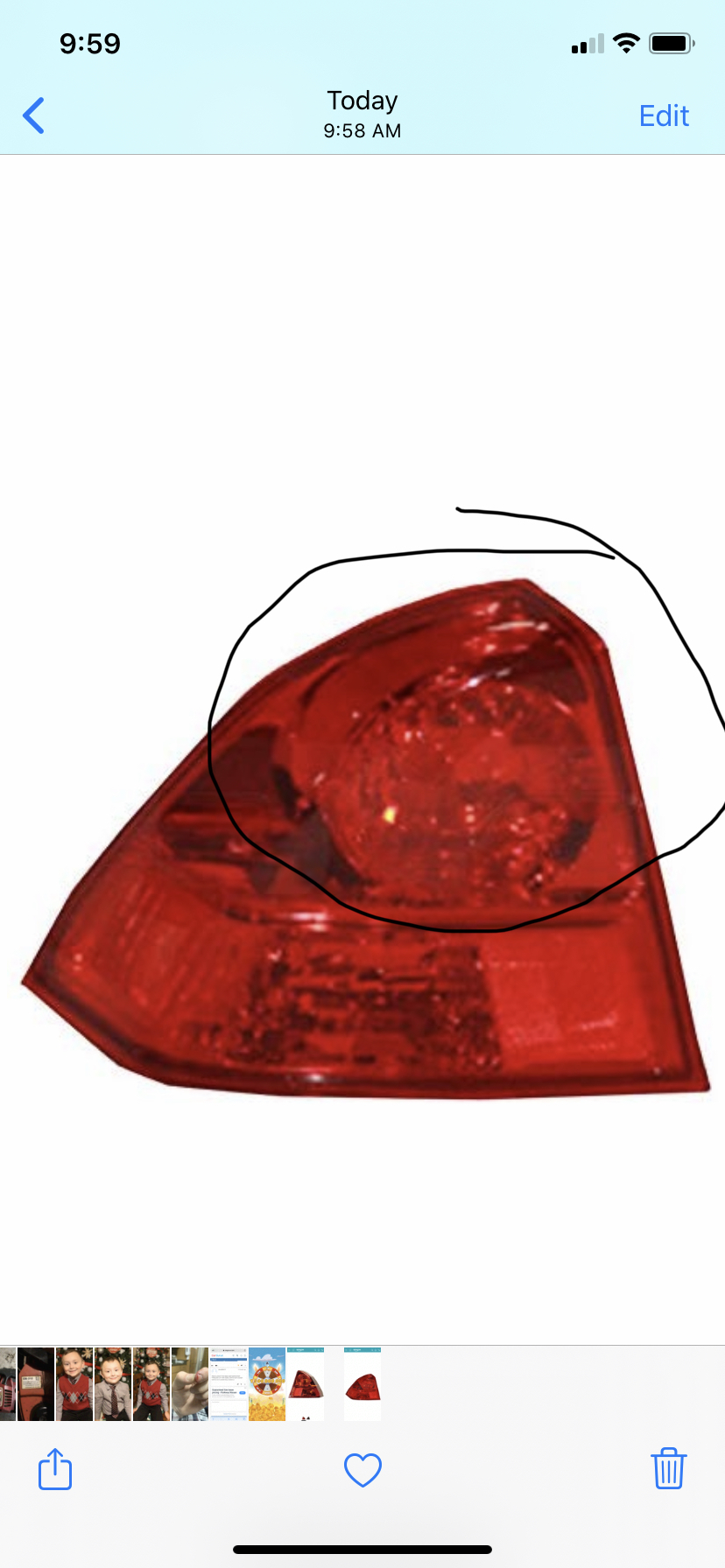

Got the car listed above lx sedan and the driver side brake light the big red one on the quarter panel mounted taillight will only come on when pressure is applied to the brake pedal but not when the lights are turned on at night. All the other lights work like they should. already replaced the socket and fuse. any other ideas?

Bulbs are brand new and it’s the big red one on the top of the tail light. we already replaced the socket and fuse. technically the car is not mine it actually belongs to a friend of mine that doesn’t know anything about cars .

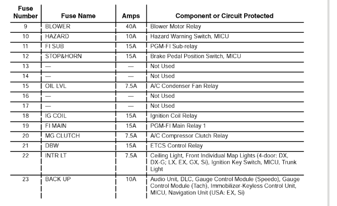

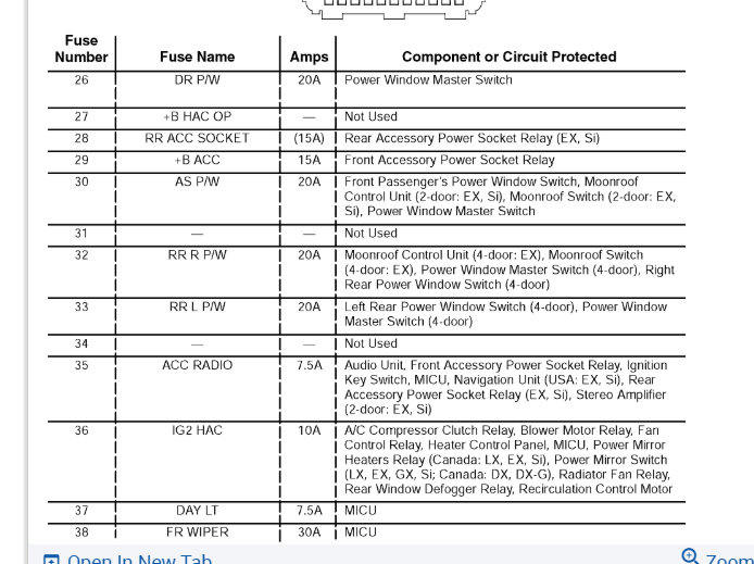

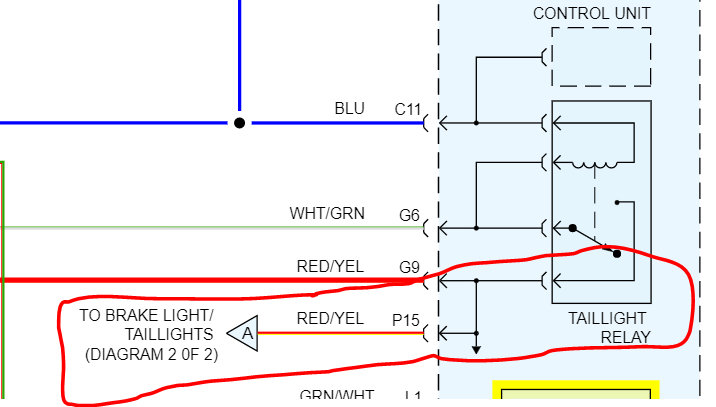

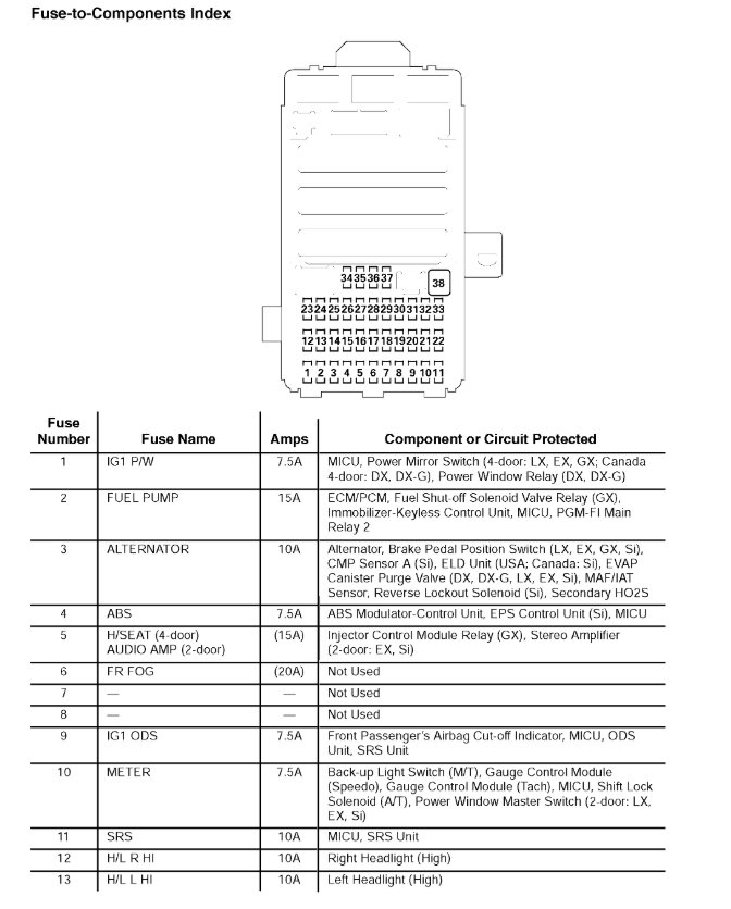

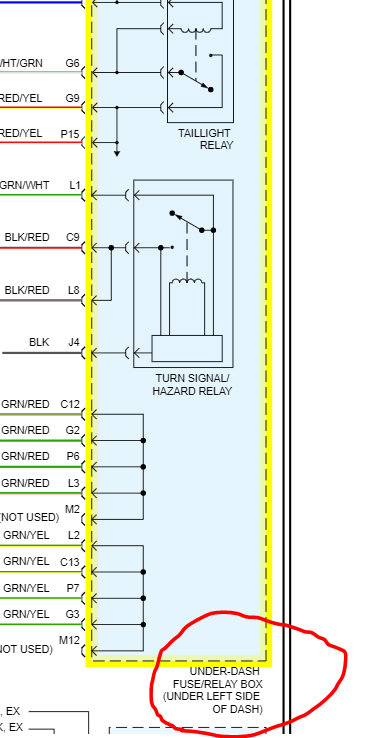

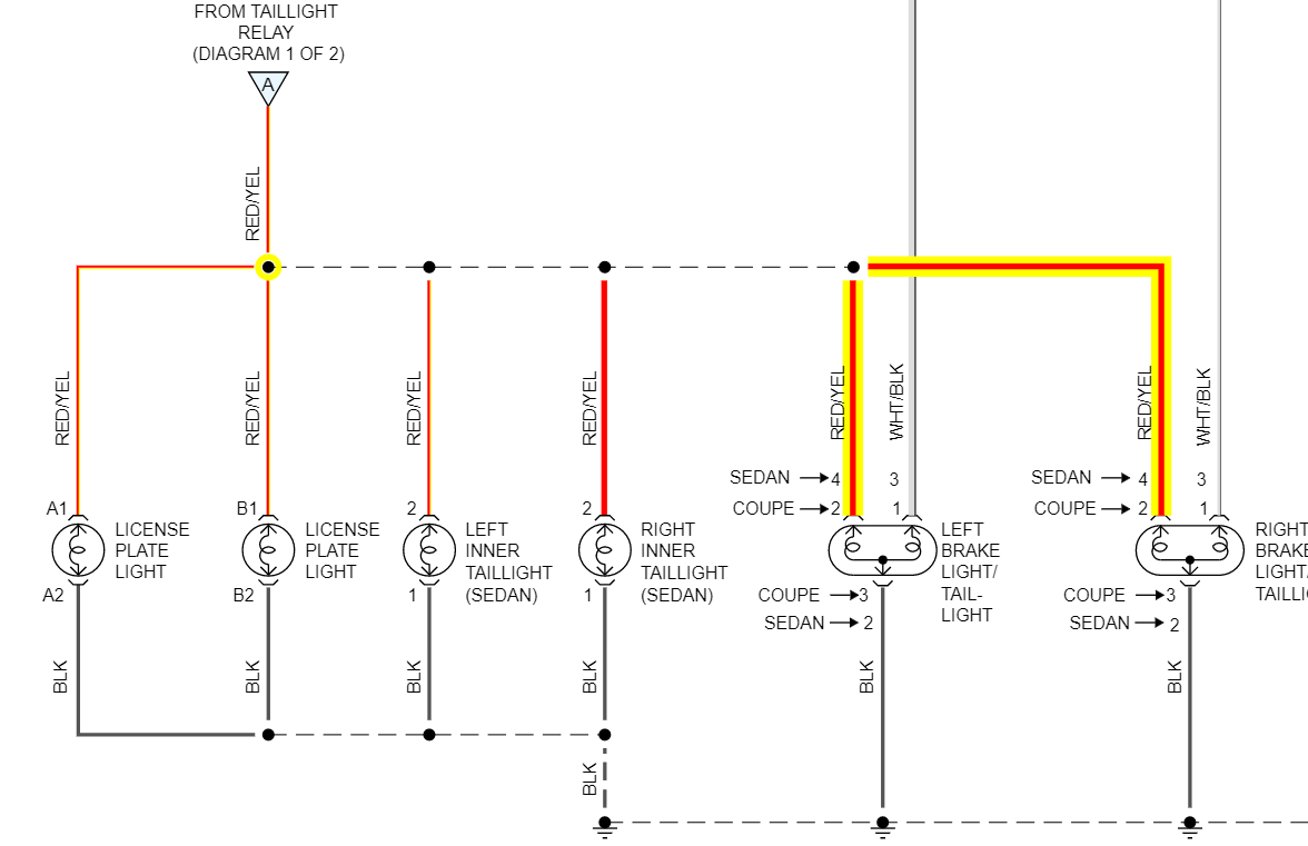

Okay, got it. Here is what I need you to do. First, power to the parking lights comes direct from the parking light relay, seen in pic 1. From that point, it goes to all lights (Pic 2). What I need you to do is check one thing for me at that light socket. With the lights on, there should be 12v to the red wire with a yellow tracer. Check that.

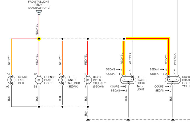

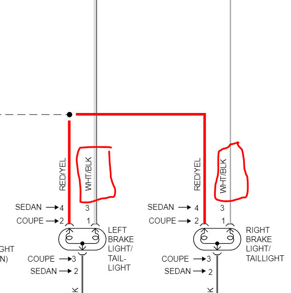

Also, I need to confirm one more thing. I reread your original post. Is it the parking light that doesn't work or do you mean the brake light doesn't work when the head lamps are on.

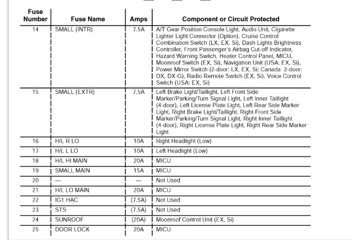

If it is a brake light not working, check for 12v at the white wire with a black tracer. (see pic 3)

  • 110,244 POSTS
According to the schematic for your vehicle, it is under the dash / fuse, relay box / left side. See pic 1.
