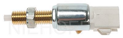

It just happened today, my car is off with keys in my hand but my brake lights stay on. My headlights and/or parking light switch is off. How can I fix this?

Your stop light/brake switch is stuck ON. Located on a bracket, above brake pedal. You probably need a new one.
https://www.2carpros.com/forum/automotive_pictures/55316_sl314311_1.jpg
Part number SL31431 from Checker/O'Reilly for $13.99
