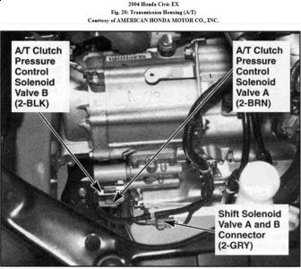

HI CAN YOU SHOW ME WHERE LACATED FOR STEP 5
SELENOIC LOCATED PLEASE

Here is the diagram of the component location.
https://images.2carpros.com/forum/automotive_pictures/192750_TransComp04CivicFig20_1.jpg
